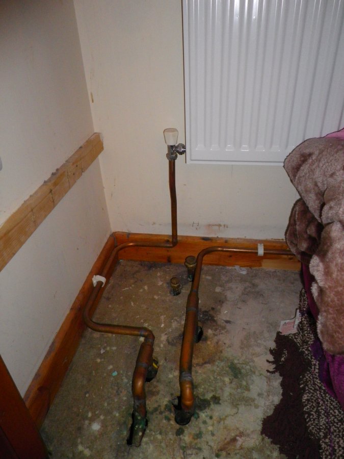

airing cupboard.jpg Hopefully may have some opininions that will assist me.
Am currently installing a shower for a freind, its in a housing association premises.
I am installing an electric shower, I need a cold supply!, convienietly the bathroom wall that i am fitting shower to backs onto the airing cupboard...this is were i ask opinion!!
the house as recently had modification to the heating system, a combi boiler as been installed and the hot water cylinder removed. Please see the picture the configuration in the airing cupboard is that a radiator as been installed and the pipework cobbled onto what existed , there is in the cupboard a 22mm and a 15mm capped of and coming up through the floor (see picture) any one have ideas as to wether one of these will be a supply that i can use for the shower, i first thought it would be the 15mm, but then have this idea it may be the 22mm,
any help is greatly appreciated
Another bodge job by so called plumbers/heating engineers.
The 15mm is probably the cold mains but who knows ?
Oh dear, a rad in the airing cupboard piped into what was probably the hot water circuit. Why a rad in the airing cupboard in the 1st place? Well at least they clipped the pipe :P
Anyways, you would need to trace the cold pipework to establish which one it would be.
If it's a housing association, they normally be using their own plumbers/sparks?
Do know if you fit a shower, especially an electric one (with the associated new circuit, cabling and CU alterations) and there's any issues, the HA will come after whoever is responsible!!
And fitting anything electrical in a bathroom usually requires notification to the local authority BEFORE work begins, complying to BS7671, and in this case I would imagine getting the permission of the HA.
You are walking on thin ice if you take this job on without all the relevant issues being addressed first.
