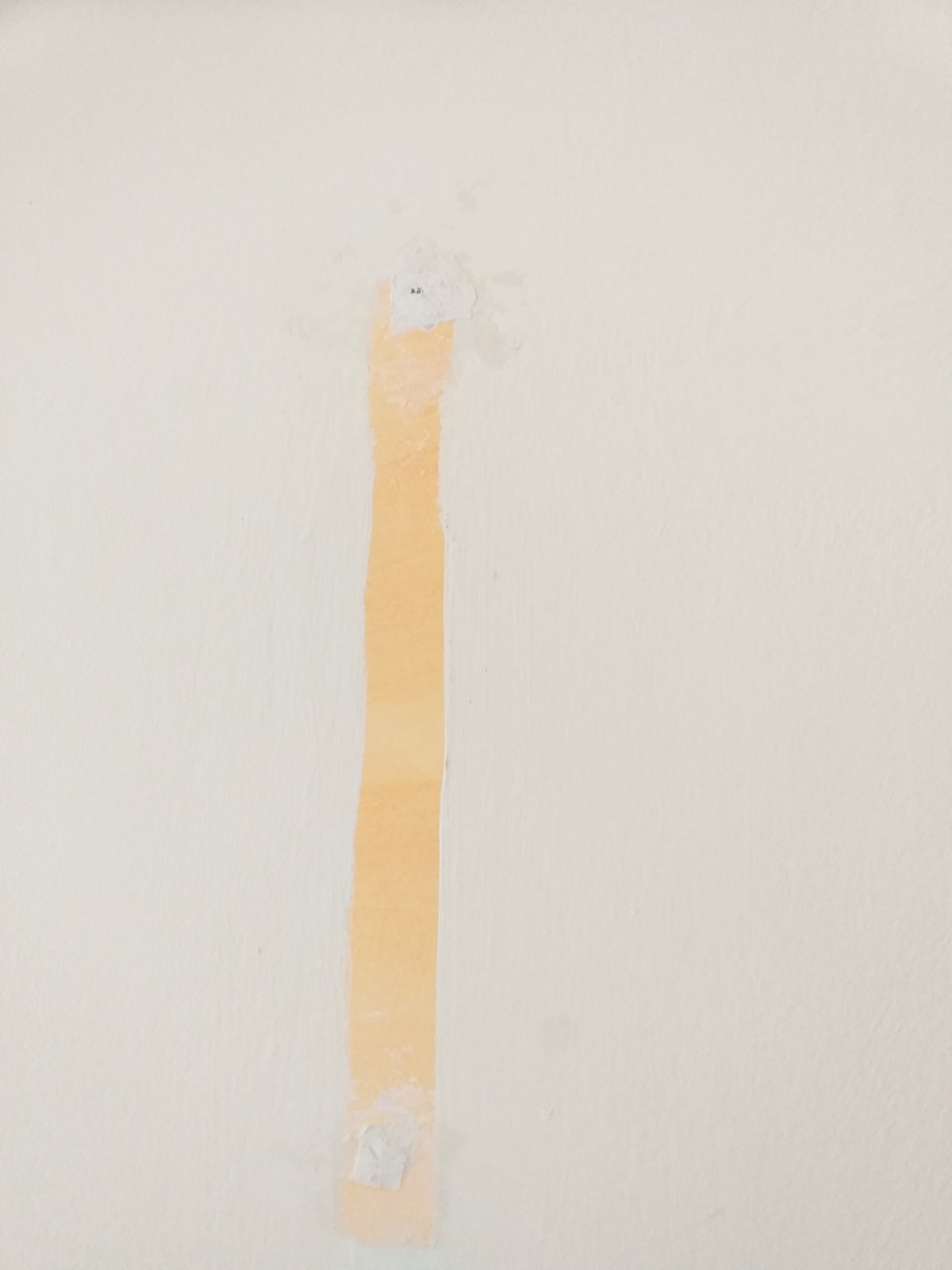

Been drilling out plasterboard plugs and filling on unplastered plasterboard. Is it best not to spread it too far from hole and keep it slightly proud? Been scraping some of filler around hole off before it dries. I can still see cardboard from pkasterboard through filler. Cant touch it but see the colour bleeding through. Any tips as filler is something i need to work on
