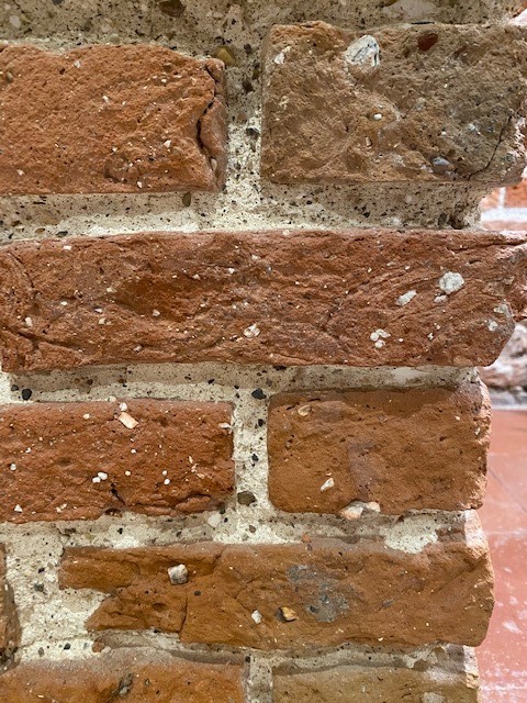

Afternoon all
Im going to repoint my old fireplace and am wondering what the best motar mix is?
Its a grade 2 listed building so im after recreating something simlar to the picture.
Thanks for your help
Is the fireplace part of the listing?
That looks like a lime mix, but you'll struggle matching the black flecks.

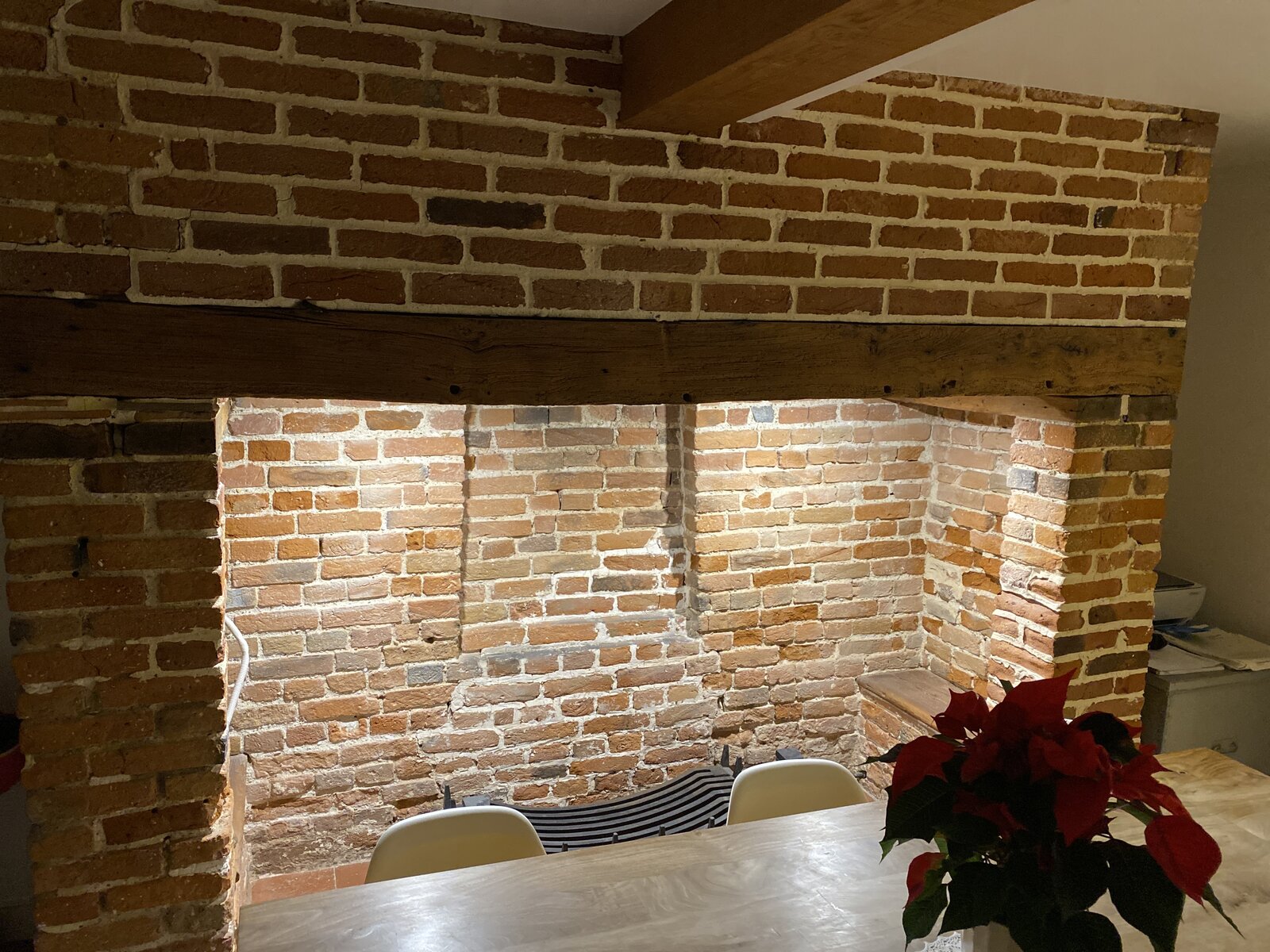

Yes I believe so, although I’m sure I could get away with something close to it. Was wondering if just sharp sand or similar could be used in the mix?
Someone’s had a go at touching it up in the past but it doesn’t look as good as the original areas.

First be sure whether you need consent or not for the work you propose.
Stuart45 is the lime mortar expert on here, he'll probably pop in soon.
You might need to contact one of the lime suppliers. Our local one has something similar Lias Black Fleck Coarse Building/Pointing Lime Putty Mortar | Lime Mortars | Limebase
You could cut a sample out and take one in to get a better match. Lime itself can be a different colour. For example the French NHL dries slightly whiter than the Portuguese from here.
Sharp sand really refers to the shape of the particles. All of these sands here are sharp Sands & Aggregates (limebase.co.uk)
However if you ask for sharp in most builders merchants you get a bag of concreting sand, often used for floor screed.
