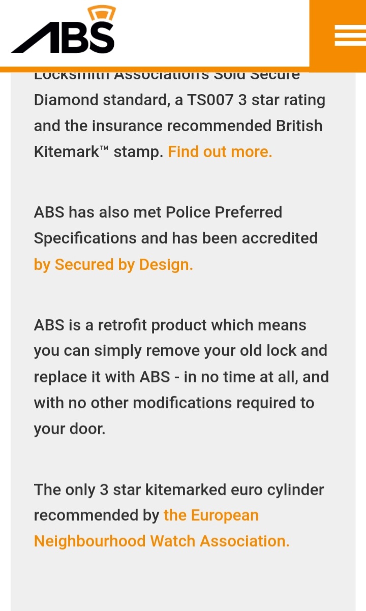

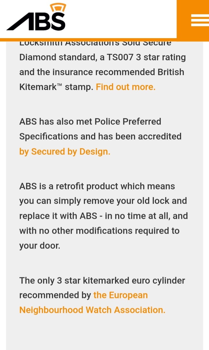

I was under the impression that to get the 3* rating, the cylinder had to be fitted within a security escutcheon which itself prevented the cylinder from being snapped.
But once an anti snap euro is snapped it's a job for a locksmith, if you can't get in by another route.
Interesting :)
No mention of that from ABS though!
