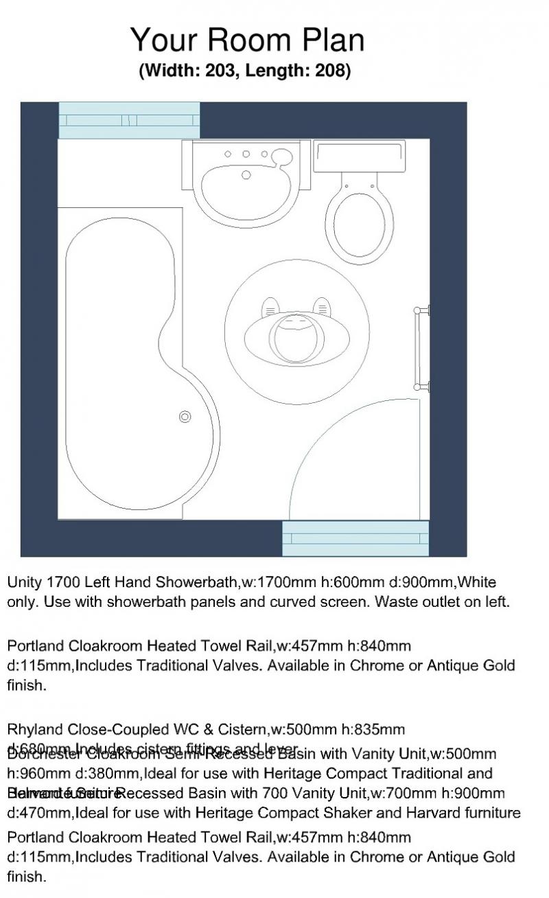

Folks,
As mentioned on a separate thread (re boilers). I am in the process of buying a somewhat dated victorian end of terrace.
One issue we have is that whereas the 3 double rooms are a good size, the bathroom is fairly small (2.08m x 2.03m), but is very dated and so we want to completely strip and redo.
The current layout is roughly:
The safe option would be to retain that layout (with new fittings). However, I am not a great fan of shower-baths and would much prefer a separate shower (but we need to keep the bath).

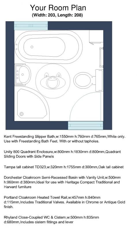

Having done a bit of research, there are smaller (1540mm) baths, which we really like ("slipper roll-top"). I have had a playaround, and reckon that the following layout would work, and would allow me to have both a bath and a 800mm quadrant shower:
I realise that the bathroom will be fairly cramped - but even with the original layout there is fairly limited floor area, so in my view we have not lost much.
Has anyone had experience of implementing such a layout on a small(ish) bathroom?
Apart from the obvious (cluttered feel), are there any other serious issues with doing this?

I`d put the bath more central .L-R , on that wall , gets it away from the window and the basin :idea:

Thanks guys. Whilst the bedrooms are a good size, I don't really want a shower in the bedroom. The largest room is probably big enough to fit an ensuite, but seems a bit pointless with the bathroom next door (and don't have the funds at this stage to redo the bathroom and install an ensuite).
In the long run, I want to redesign the ground floor, and may try to design a shower room - but again, won't be for a few years (unless I get a big pay rise :D )
Regarding making the bath more central - I can see that would be esthetically more pleasing, but given that the bath is 1540mm long, and the wall is 2030mm long, by having the bath central, will leave about 250mm either end, which would be basically dead space. By having the bath in the quarter, we are left with enough space to fit a bathroom cabinet of some sort for storage.
Quite a few people are suggesting that it is a bad idea to fit a bath and shower in such a small room - and we should probably listen - but I can't help thinking that as it is important for us to have both a bath and shower, we should go ahead - the room will be a little cramped, but ultimately should be "fit for purpose"...

Hi
Just thought I would add a couple of ideas..
Consider reversing the door to open outward.
A compromise on the slipper bath for a conventional
Straight edge would then open up the possibility
Of installing a smaller bath 1400 and the
Utilise the gap for the wc to face the bathroom
Door, this may then lend itself to possibly
Positioning the basin in front of the loo towards the door
Using a wall mount instead of a pedestal
And a short projection profile.

Thanks for the suggestions. I think we may indeed need to look at opening the door outwards - I had wanted to avoid it, but given the size of the bathroom, there are going to have to be compromises - and it does free a bit more space.
We did think about other styles of bath - but even having a bath that is 1400mm long, means we would only have 630mm for the wc, which I think would feel tight and claustrophic (lack of elbow room). The layout I had hypothised has the advantage that you have plenty of elbow room (assuming the door is closed), but of course, the toilet is right in front of you when you open the door, which is not visually very pleasing, but otherwise is not a problem - there is still plenty of room to walk in diagonally into the centre of the room...
