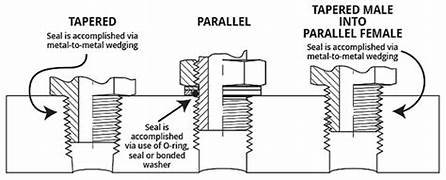

Hi all, I have bought the same valves and have the same question.
I have read that these ribbed threads don’t need PTFE, but a particular threaded female wall plate with a rubber seal at the end.
They can use a rubber sealing washer or use tape/thread but so can male fittings without roughened threads. All the roughened threads do is allow the tape/thread to be gripped when the fitting is tightened. Used to use a file and do the same to allow the threads to grip the tape.
The only type of thread that doesn't require tape/thread/washer is NPT (tapered) as the threads mesh together rather than the parallel threads of the BSP fitting that don't mesh together, hence the need for some type of sealing medium/o-ring/washer.
