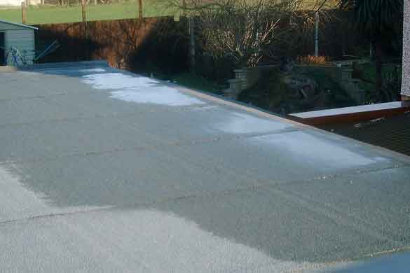

help, can anyone advise me on a flat felt roof as we just had extention built 22ft by 13 ft the builders put on flat felt roof but it is holding puddles of rain ! these puddles do not dry up the builder says it will do no damage but i think he is talking builders b....... sureley after a while the rain will get moss, any advice please this is so frustrating please help

the puddle is is about 3ft round and half inch deep
on the roof when it was built on top of wooden joist the angeled wood tappered from 3inches to nothing some peices were not quiet long enough i noticed ,but when i said to builder this he told me not to say anything as i did not know what i was talking about! well he was right there i dont know anything about building work but i do know my roof shoild not have puddles on it

Is the 13ft dimension the fall of the roof ? If so then a 3" fall is somwhere in the right area I am surprised this is puddling i would guess that one of three things is happening
1) where your firrings are not long enough the water is running to the ends of them, (and as the rafters are either at best flat or, judging from your description of your builder, quite possibly running slightly back) and then pooling on the last part of your roof.
2) the roof decking has got wet during the build and is now warped creating puddles
3) The layers of roofing felt have not adhered to the roof properly and have lifted in areas creating a pool.
It is not best practice, but most modern felts can now stand frost action from standing water and are able to stand direct sunlight without the need for reflective chippings.
Just to add on to chappers post, I've bought 24 3.9m firrings last year and sent them all back because they were all badly cut thus this will give you a flat roof bow which could be another reason for the puddle. I now make my own firring knowing it's dead straight, make a difference for a flat roof.
meant to say yesterday that a few pictures from different angles would speak a thousand words and possibly make it easier to diagnose your problem.

looks like you've definitely got a lip at the front of the roof.
