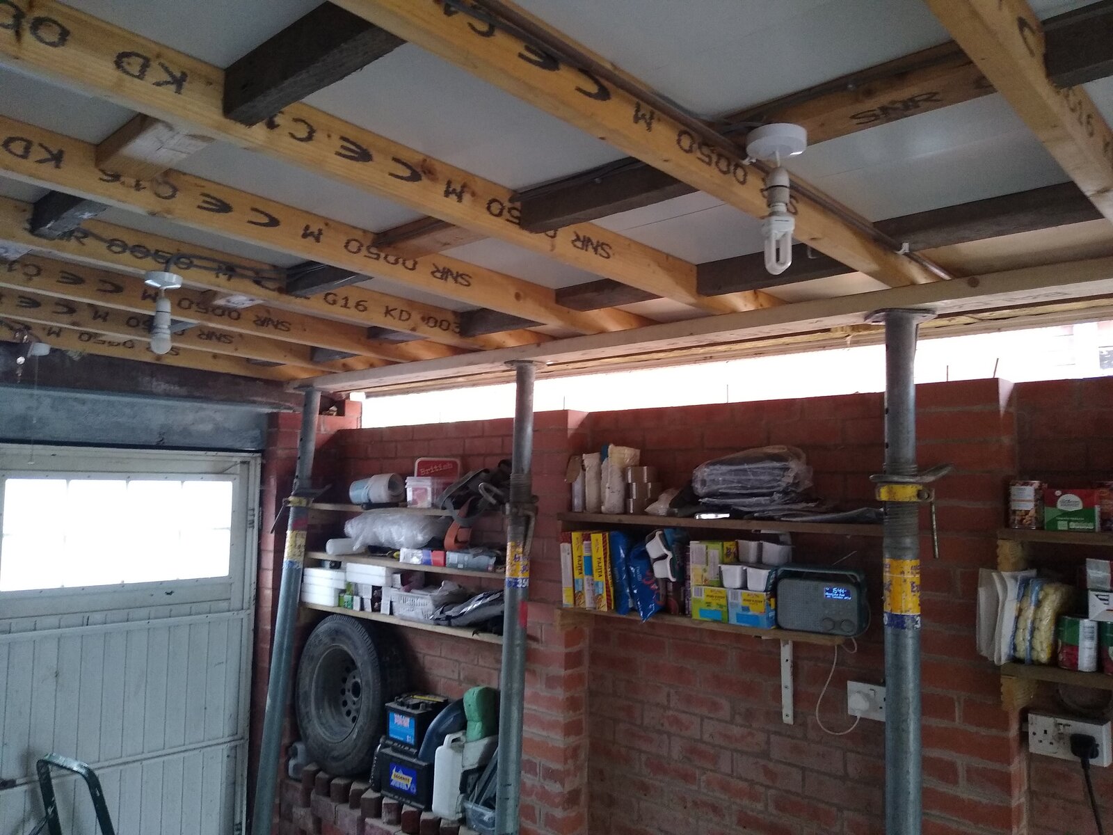

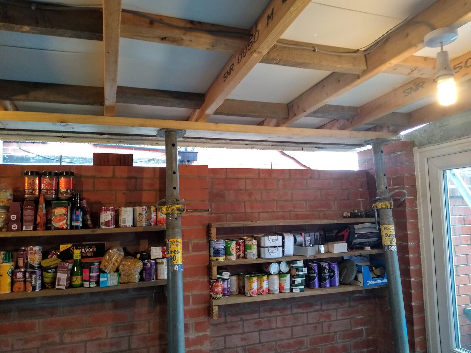

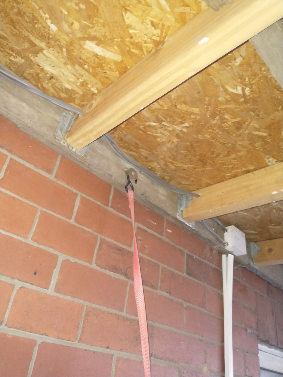

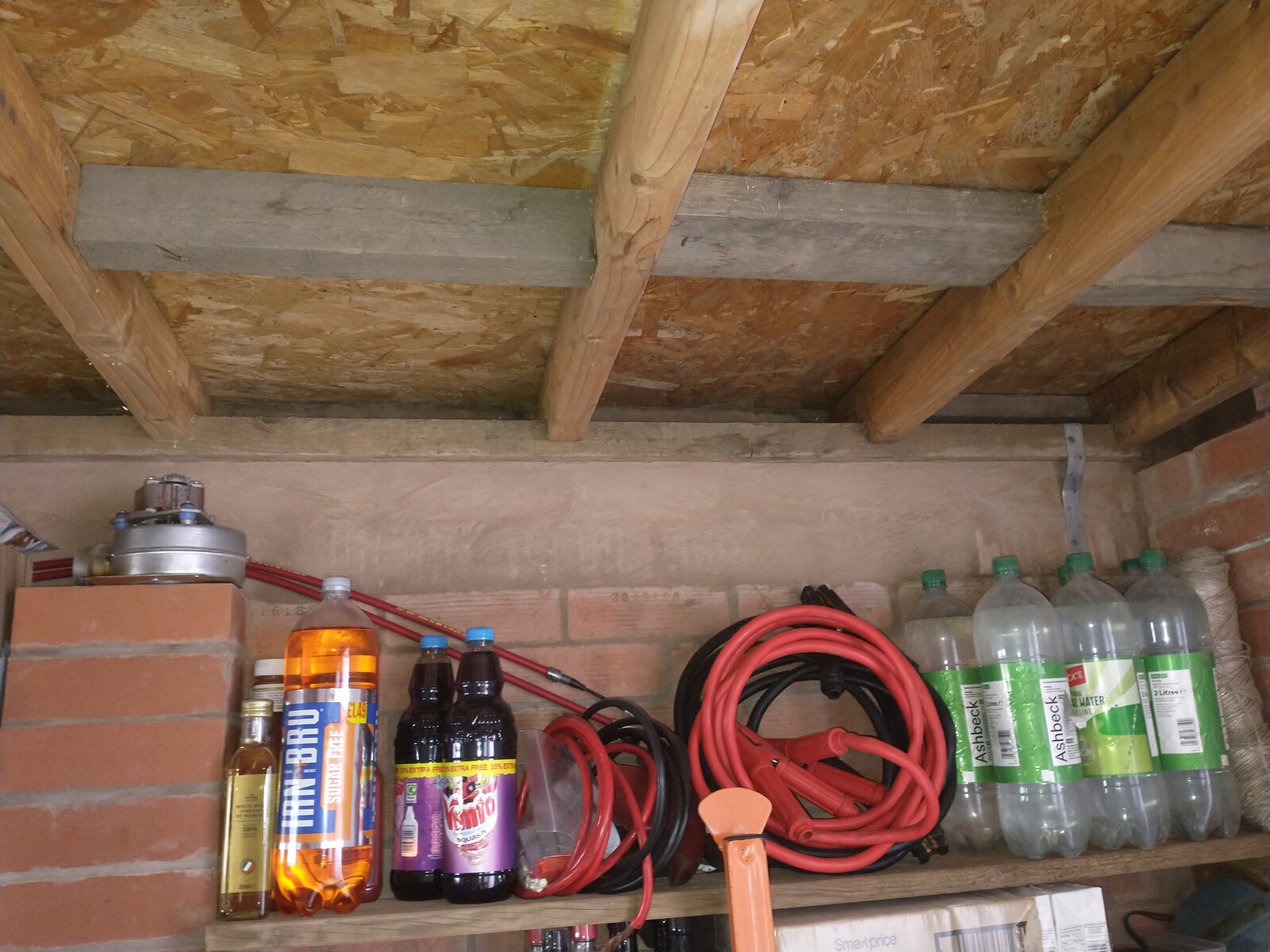

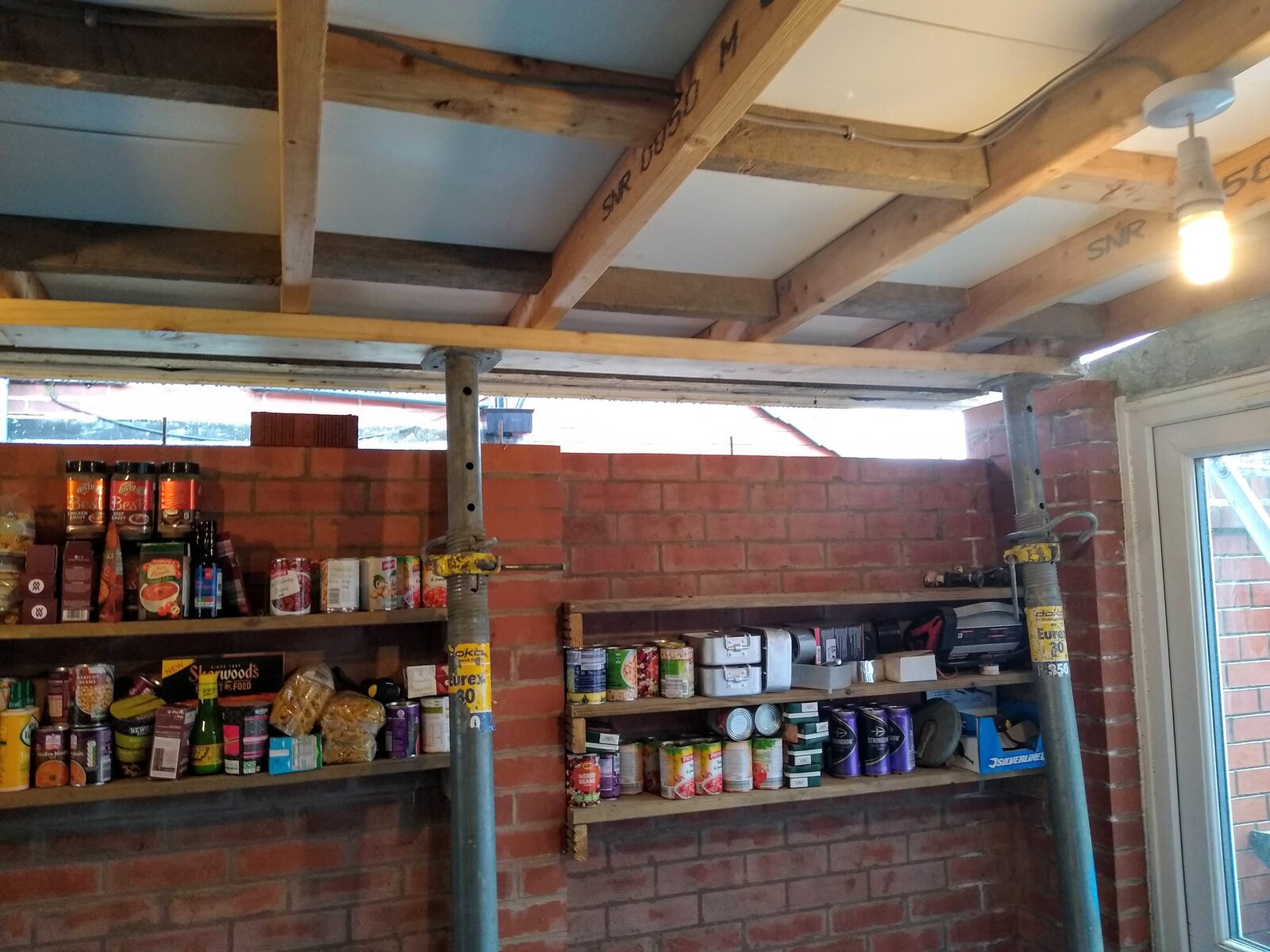

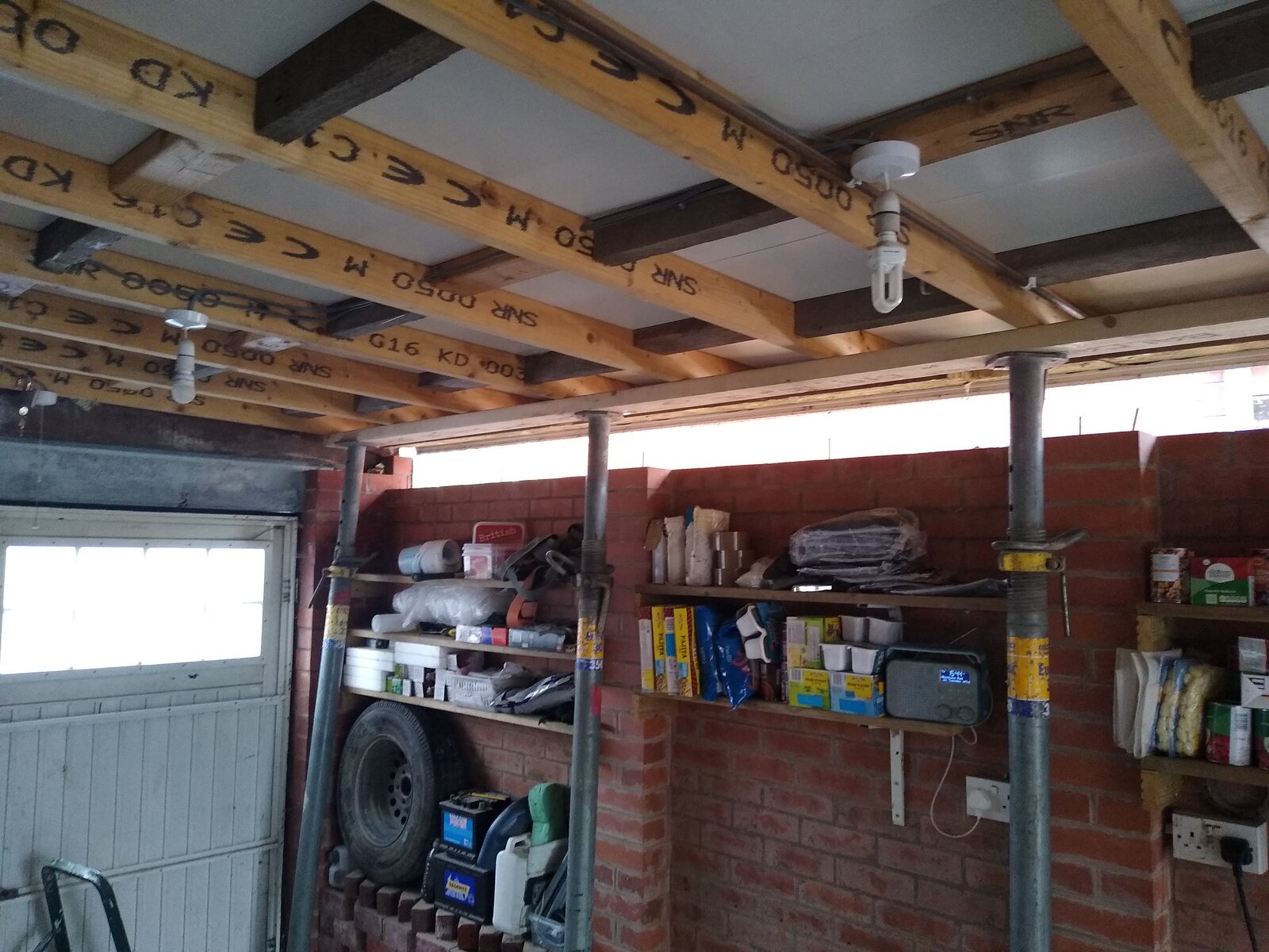

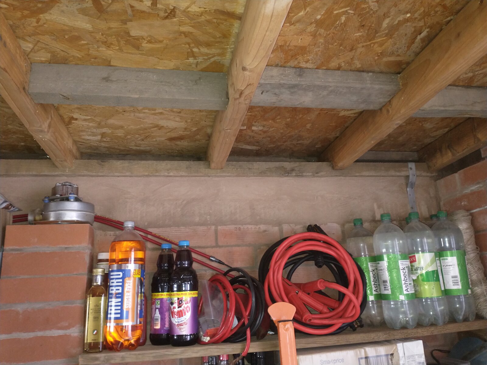

I raised my lean-to garage roof by 6 inches (a long story involving a caravan). I jacked up rafters and wall plate as one and inserted 2 courses of bricks under. At the house end there was enough movement in the truss clips that I didn't need to do anything there but I think mine was slightly different in that it started off as a shallow pitched roof and ended up as a flat roof which I re-did in EPDM. If you use timber you'll need a tall fascia or some cladding to weatherproof it outside.

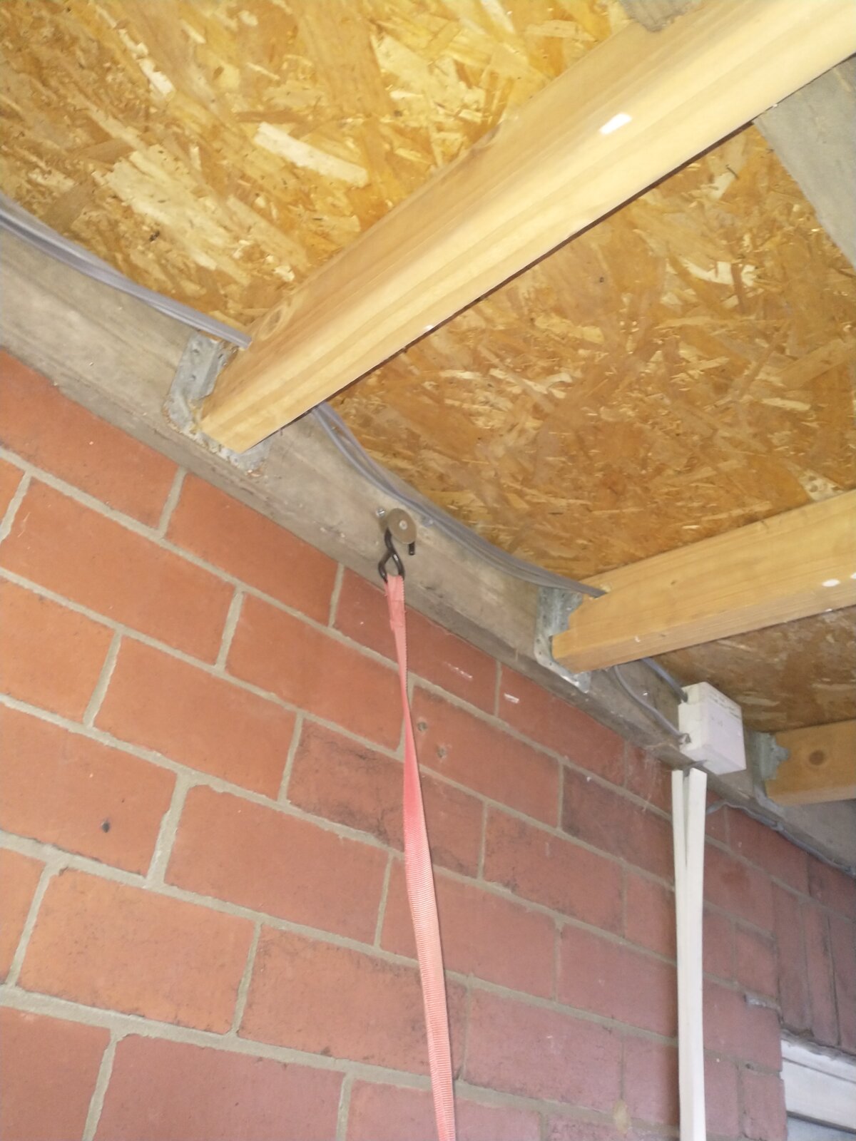

I like the use of 50mm truss clips as joist hangers.o_O
If they're free, and they look vaguely right they'll do me. You'll probably sigh at the (free) 9mm osb decking but with the rafters at 400mm centres it's all nice and solid.
