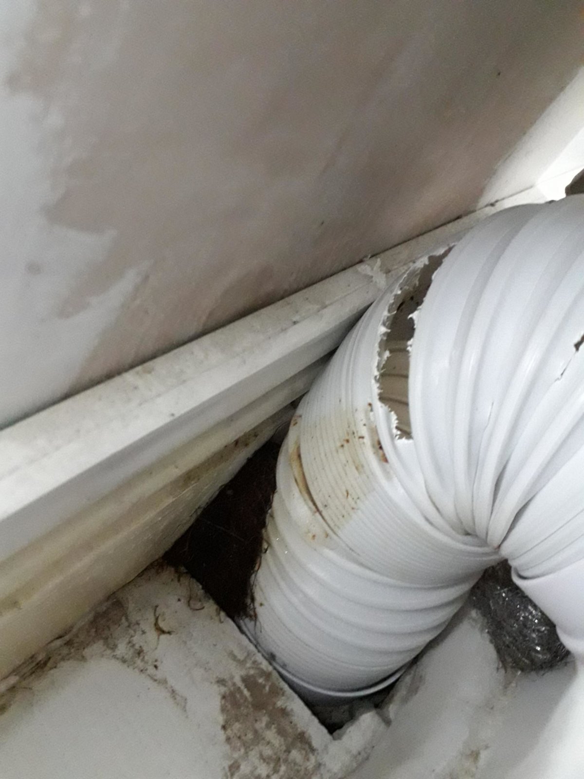

    Hi Folks,
    Our downstairs toilet had a new Flexi pipe fitted end of last year, after the original flexi had cracked which was 5 years old. But the new one lasted only 5 months. Even when the plumber fitted the last new flexi, it wasn't right I felt as there some smell lingered, unlike before.
    So now, how do I ensure that I get it properly replaced.
    Do I need to buy a stronger flexi or not sure if there was a rat/mouse responsible, but we couldn't see any signs of them downstairs.
    Any advice appreciated

    Don't use flexi connectors. It's obviously at such an angle, it's straining, cracking and then perishing. Use a combination of rigid ones. Maybe using an extension, and eldon and a straight would solve the problem.

    As above. Flexi's are a last resort at the best of times, that looks like its been forced to fit, and is under so much strain, failure is inevitable. I'm only surprised the original lasted so long. Replace with a rigid pan connector, if fitted properly you shouldn't have any further issues.

    trim that skirting and a good quality tight 90deg McAlpine should fit in no bother

    So I should be looking for 90 degree pan connector and forget about the flexi connectors. At first I thought it could have been a rat/mouse to cause a tear, but you guys think it's sheer straining that likely caused the damage.
    If I can fit a 90 degree solid pan connector, I take it that is the best option? From my photo, do you think it's suitable?

    Looks like rodent damage to me. The jagged edges are tell tale signs ,chewed up to the wire. If the flexi splits it does not leave jagged edges and a wide gap.

    Looks like it’s been chewed thru .

    Had a DIY friend coming in today lunch time and we went to screwfix and got a 90 degree flexi Mcalpine and he replaced it.
    Had mash wires inserted between the gaps before, so will ensure I do it thoroughly this time, so not sure why damn rodent comes through. Didn't see any rodent activities downstairs, strange.

    Rats come up from the sewers ,get to your flexi pan connectors ,they allow light thru them which they head for,and chew away. Can't always get thru between the wires in the flexi and into the house.

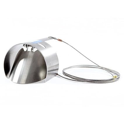

    [​IMG] [​IMG]
    • Like Like x 2

    It's not a good idea to have holes that size around pipes - it could still allow vermin in from other sources under the floor. Mice for example only need the tiniest of gaps to squeeze through - such as broken air bricks. But yes, rats managing to get up the sewer into downstairs toilet's isn't unheard of esp. in older properties in inner-city areas where the sewers won't be in quite as good a state, and the infestation in the sewers is likely to be worse. A solid plastic pan connector in a situation like yours means it's harder (but not impossible) for a rat to climb. As Terry pointed out, the flexi-connector is thin plastic and will allow light through which rats may be drawn towards.
    My point about rat-flaps relates to a device that goes in the sewer branch itself and acts as a one-way valve to prevent the rats getting near the property. I would have thought the fitting of such devices would have become pretty standard in recent years.
