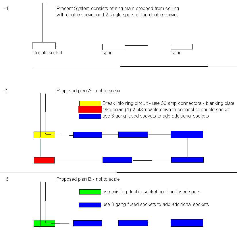

Can you connect a fused spur directly to another fused spur ?Thinking of 3 gang socket fused outlets connected together.
If it is ok - is it good practise?
Not possible anymore with ordinary spurs - although my house has been wired that way in one instance. Not by me, but it was acceptable when done.
DIYNOT have added a pic to my original post . Hopefully it is clear enough but I can have another go if not.
Although not clear from the diagram - the wall is 28ft long with (1) 2 gang socket and 2 single spurs off the socket (not acceptable now but ok when done a good number of years ago) I need a few more sockets on the wall for convenience more than anything else. I do not like trailing socket oulets but at the present time am forced to use them.

plan "A" loks good (assuming existing is 2.5 t & e, which it probably is)
Yo - plan A.
But why 3-gang sockets? That's an awful lot of outlets - 17 on that wall, whereas with Plan B you appear to be happy with 11. Why not use ordinary 2-gang jobbies?
Also, in B, you should, strictly speaking, have a fuse to protect that length of single 2.5mm.

I prefer plan A as it just extends the ring circuit and does away with the chasing down to each socket.

Yes it is 2.5 t&e

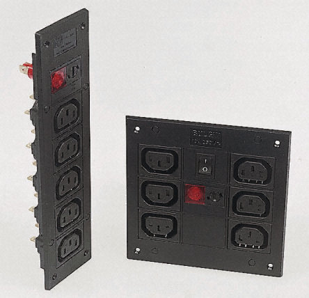

Also, if you have a spot where you are going to have a whole bunch of AV equipment, you might be interested in fitting 1 or 2 of these:
Either plugged in, or wired to an FCU, as a way of achieving a high density of outlets in one place. Available from RS. You can get flush mounting ones which look a lot neater:
but they don't do back-boxes, so you'd need to search for something the right size, or make one.

Thanks - they look neat. Prefer flush fitting although they would be in an alcove.
