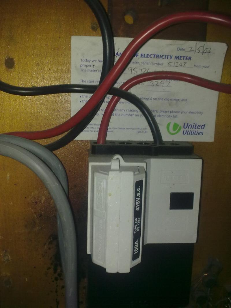

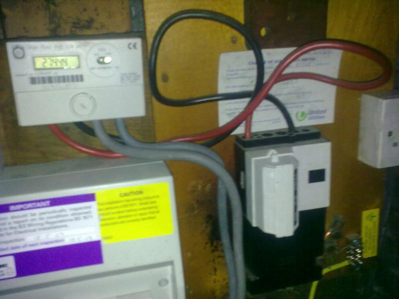

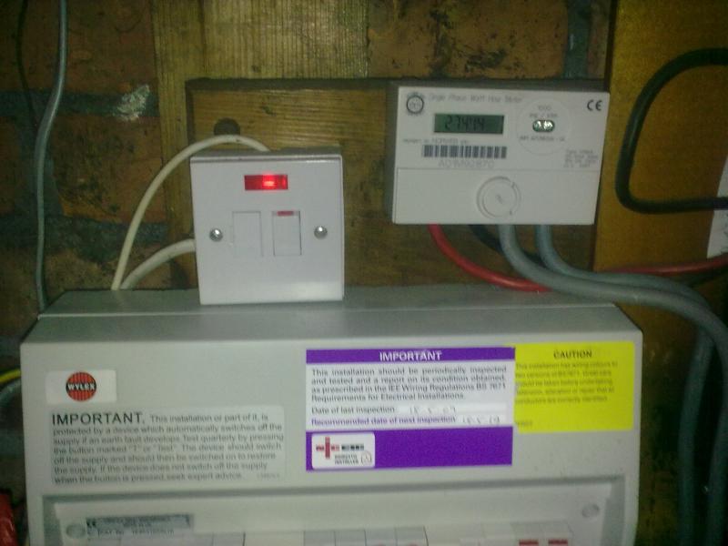

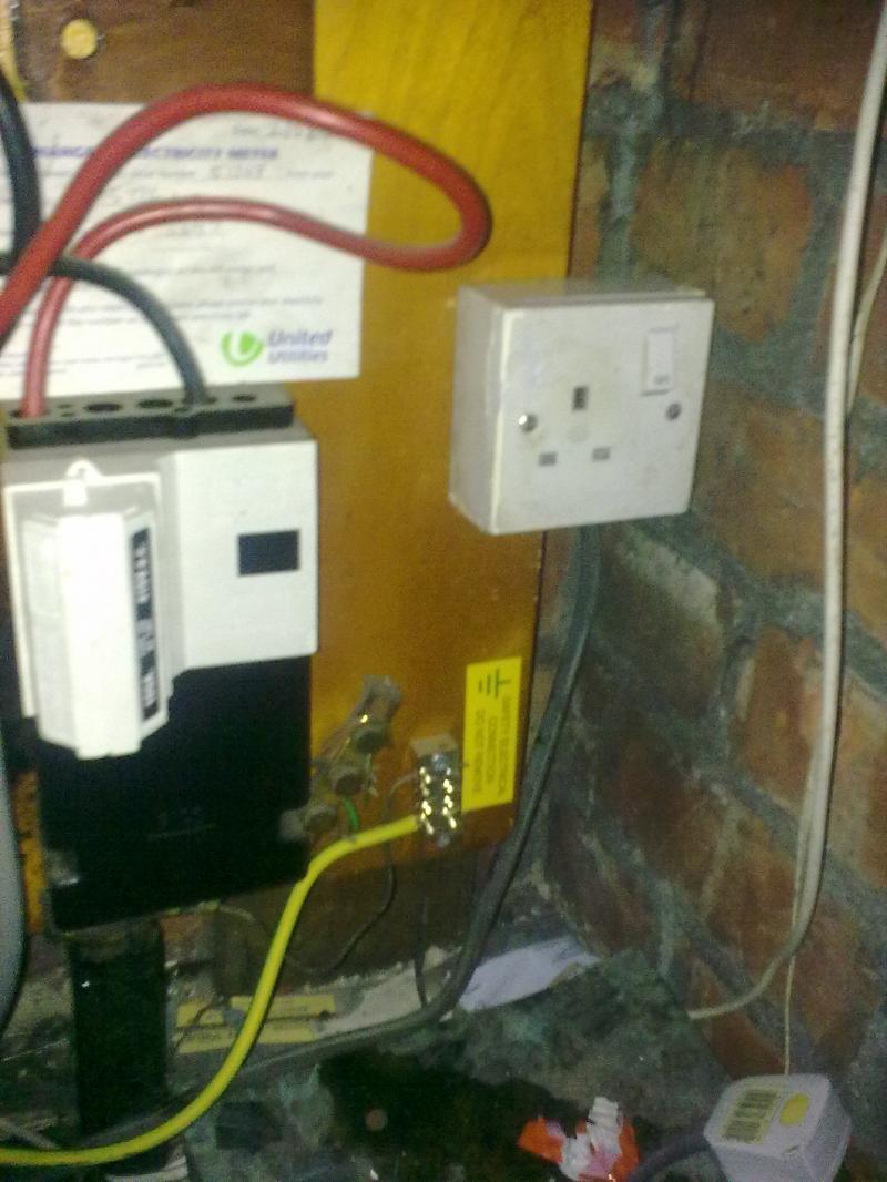

If you want to post a picture of your fuseboard and metering area we will see if we can tell you what sort of earthing arrangement you have... TNCS has more stringent requirements for bonding conductors, and if you have metalic services entering the outbuilding (gas lines, etc) then you'll need to bond them, which means the earth in the supply cable also has to meet the requirements for a bonding conductor (which is 10mm copper* for TNCS)
Or if another material, a size which will give equal conductance (and as the ratio is about 1:9 for steel), the chance of armourings meeting it are unlikely!

Here they are
Hope they suffice. However, I repeat, there are no metal (pipework)services being run to the cabin
