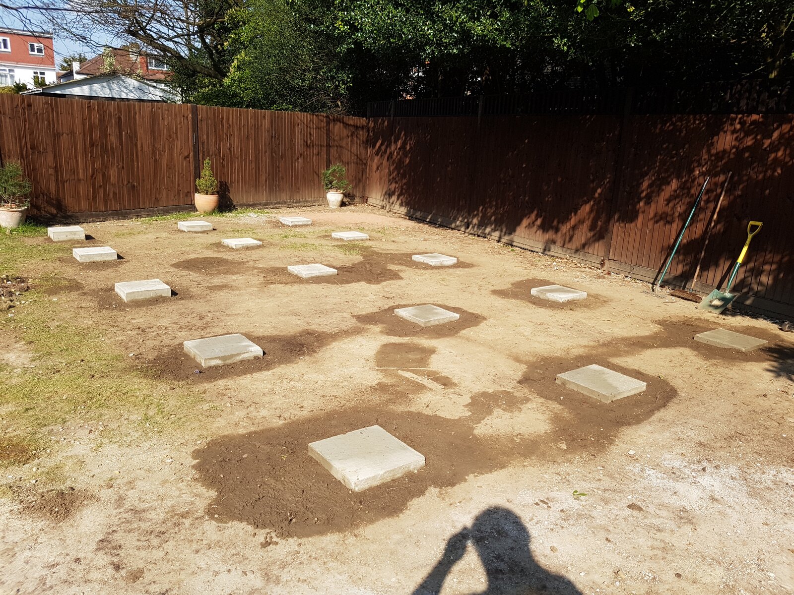

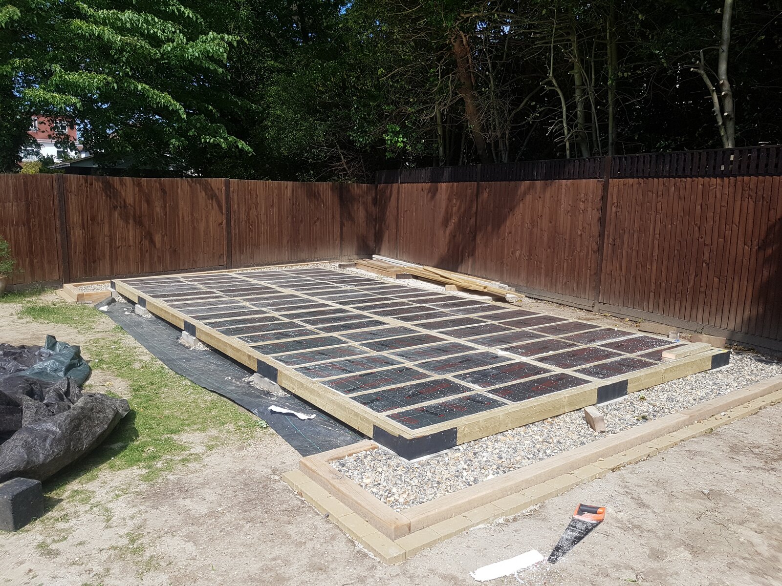

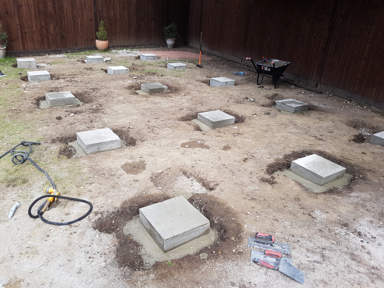

The foundations are adequate for a garden room. They are concrete pads sitting on MOT type 1, running from 400 - 500mm deep. I poured them myself with high strength cement and installed ss rebar into them. The amount of rainwater run off is the issue, it would have lifted a slab, raft, strip etc... potententially cracking them to, so I am glad I didn't do that. The heave is not from seasonal movement but in effect what would be the same as a burst pipe as loads of water that would not naturally be in the area suddenly engulfing it due to no presence of a gutter.
Rolling it out isn't a possibility as it is bolting down into the concrete pads themselves.
Also it falls within the permitted development and is over a meter away from all boundaries..
I also attached images of the foundations

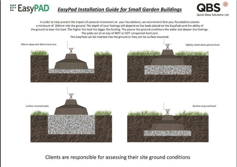

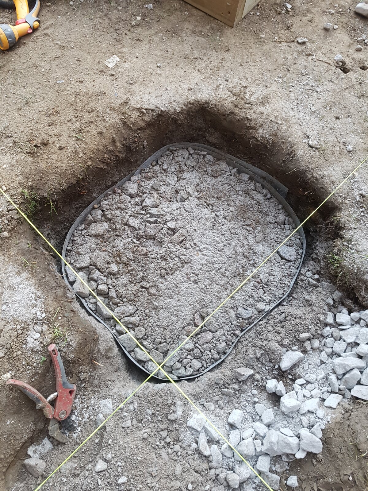

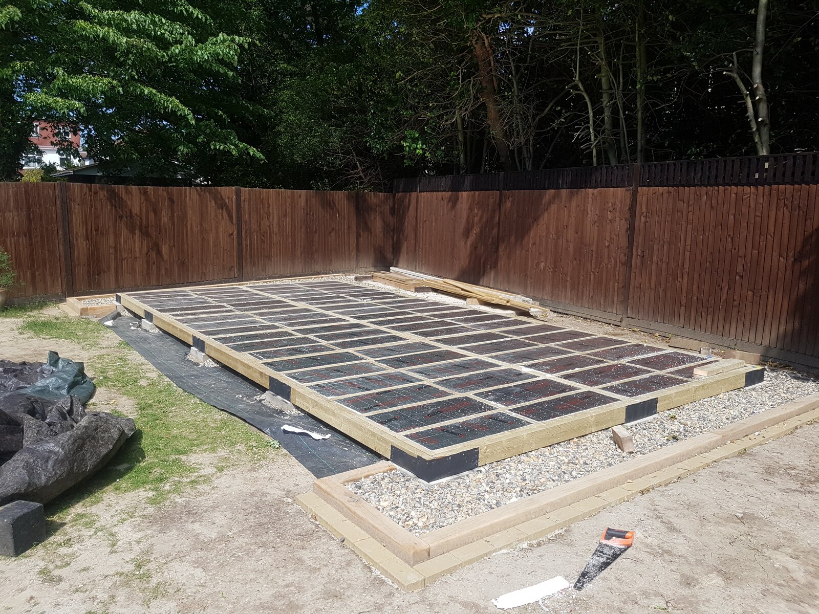

To be honest I did think twice about laying them on hardcore, my idea was based upon a company called easy pads, I will attach a picture of what I mean.
I was concerned about tree roots to, so I did install a root barrier around each block to prevent any roots interferring with the foundations.
Thanks for your advice about the internal finishes. I hope to get some kind of flexible filler for internal board joints as I will ply line and paint the inside.
