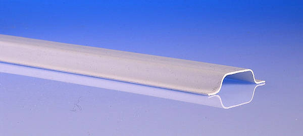

1. When I sink my cables into the wall, ideally I want to place some sort of trunking/PVC cover over them, which is what I've seen professionals do. Is there any particular reason why they do this as a matter of course these days?
2. Can anyone suggest a cost-effective and labour-saving method of chasing the channels. Also, what is the type of trunking/PVC cover I should use?

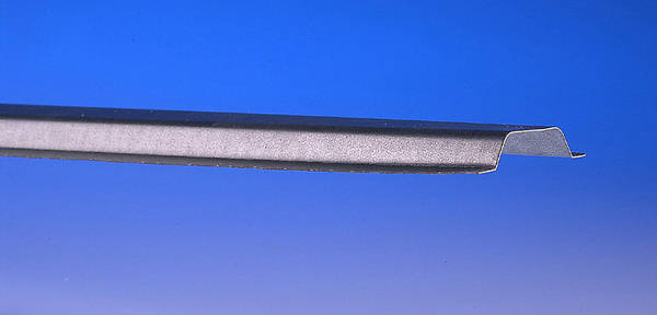

1) capping. it stops rener destroying cable, protects cable from damage (alegedly) and in theory you can pull it out if you ever need to
2) pay labourer
3) you mean cheap dont you, quality costs, dont skimp. consider hiring one
4) capping is fine

1. Great, I'll definitely be using that then
2. I have to do it myself. I work away at various times and cannot afford to rely on a labourer turning up when they're supposed to, anyway, what's a few channels right? ;)
3. I don't mind paying a reasonable price but £190 in Screwfix Direct for an EBS set is very expensive. Isn't there cheaper kit you can buy?
4. Sorry, I know this is probably obvious to you, but what is capping and what type should I buy? I've looked in Screwfix and can't find anything obvious! :?

If you ever want to be able to pull new cables through, I'd strongly advise conduit and not capping. Plastic will do if you don't need mechanical protection. If you do need that then capping won't hack it anyway.
