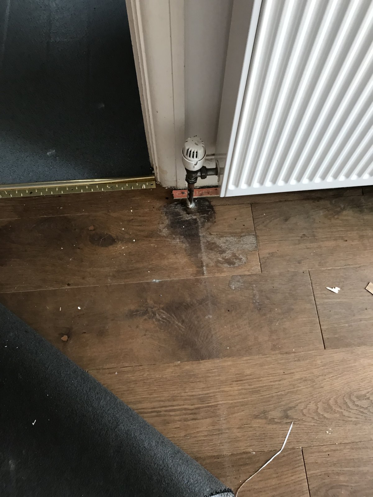

Hi there does anyone know how to get water stains out of wooden floors.

Rub with wire wool in the direction of the grain, wipe every speck of dust off with a slightly damp cloth and allow to thoroughly dry then apply a few thin coats of appropriate stain/oil whatever the original finish is. Do it lightly to ensure a slow build up of colour for a good match.
