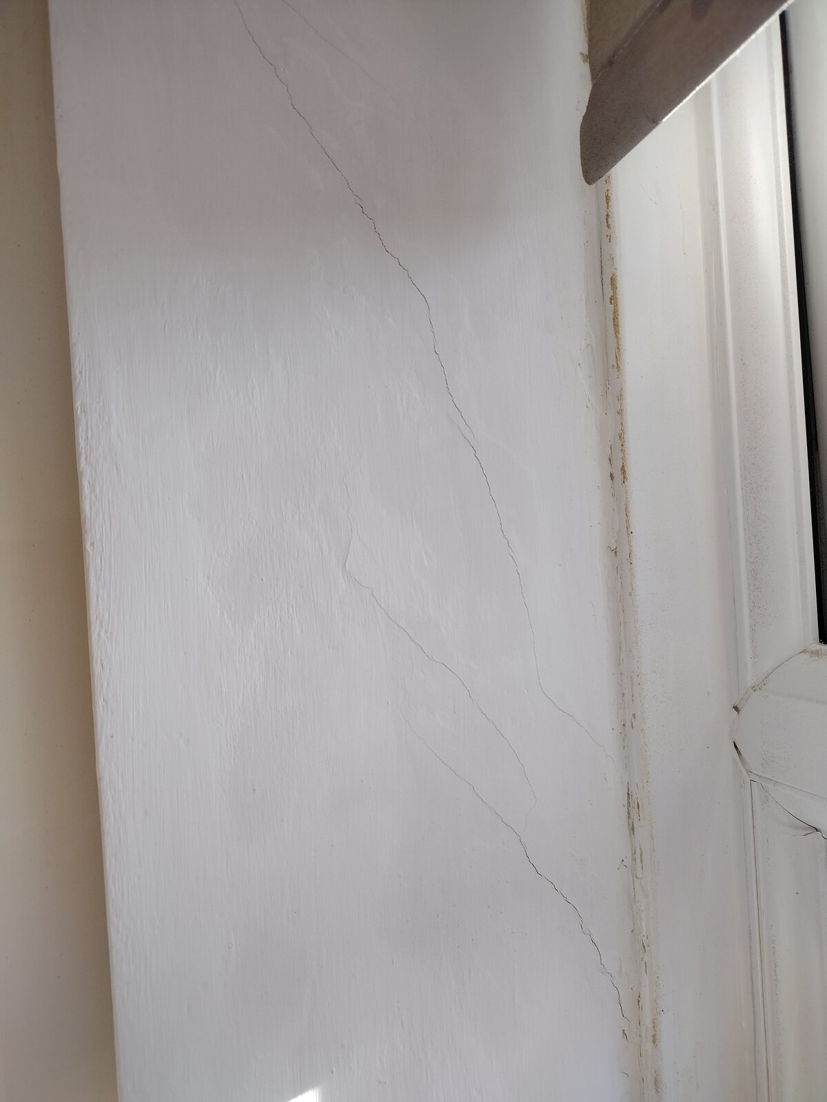

Hairline cracks around window on old plaster.
13 May 2025
2
Hello,
Small hairline cracks that show up as shadows when the sun is shining. Beside the kitchen window.
I've tried lots of fillers but just cannot seem to get rid of them.
Does it need replastering please?
Put some lining paper over.
If you knock it and it sounds hollow and moves then more work is required, but as it just paper over.
No it feels solid, I will get some of that lining paper. That's is a good idea , thank you.
