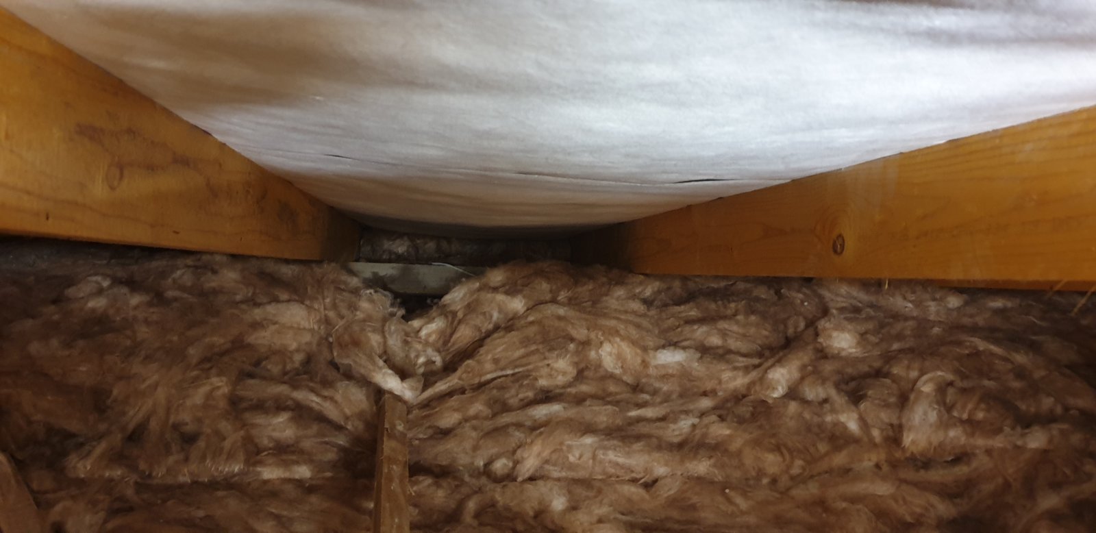

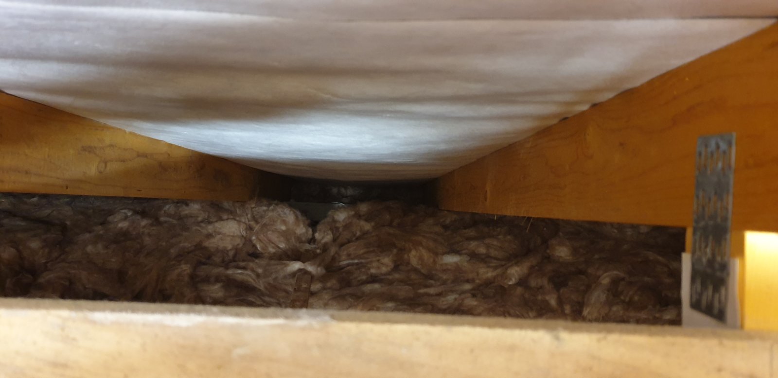

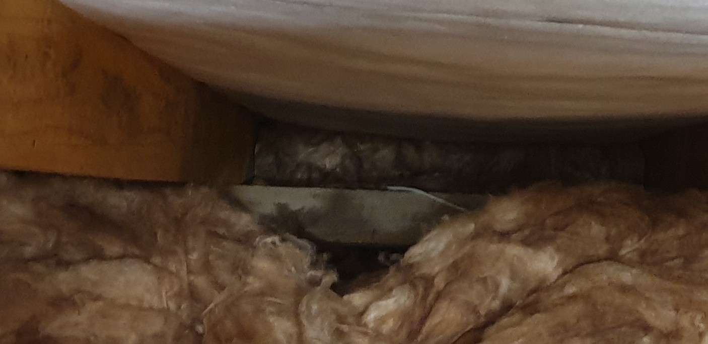

I've just been in the loft and the insulation above the cold bedroom is like below.. should it have this gap?
Is this a detached/semidetached? How many outside walls has the room above the garage got? My guess is that it is a semi, that the garage wall is a boundary so the bedroom above has 3 outside walls and an unheated space below. the heating system won't have been balanced properly and the thermostat (as already said) is in the wrong place.
If the radiator becomes hot in time with other rads in the house then it is not a balance issue. And yes, the stat is in the wrong place.
Is it a decent sized rad ? and does it warm up as quick as others in the house ?
