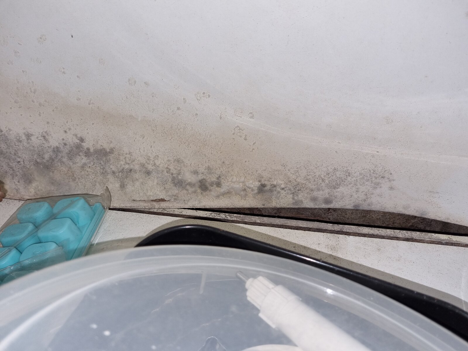

In my kitchen, which has been extended by about 2 meters in the past, the wall at the very bottom is conpletely mouldy behind my kitchen cupboards.
Its so bad that the two cupboards on that wall cannot be used as the mould spreads onto items and it stinks.
Also the back panel of the cupboard has warper so much that it has now popped out of the grooves

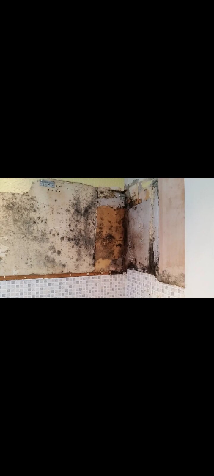

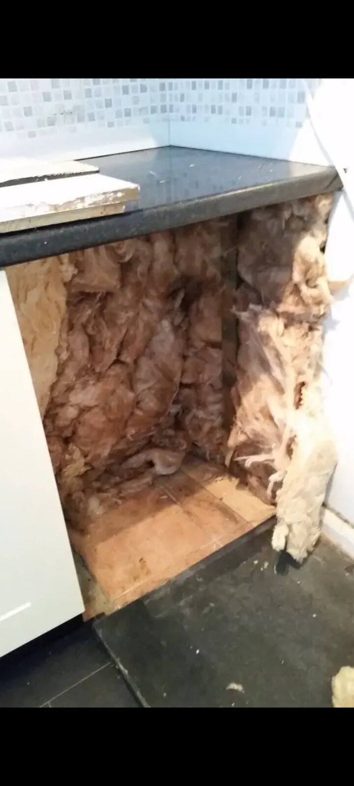

A bit of history, when i bought the house and redid the kitchen, this particular wall was covered in loft insulation which was soaking wet. And the wall up top was mouldy. Ive attached images of what it was like then.
Could someone please tell me how to fix this?
I think it is been caused by condensation, but it doesnt happend behind my other cupboards... why not?
The only thing i can think of is that the floor at that part is solid concrete and is freezing cold.
Could this be drawing all the heat from the walls causing them to then become cold?
Who would be best to come and take a look and fix?
Thanks in advance

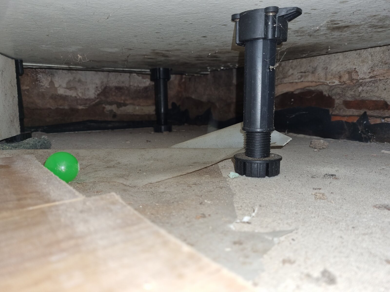

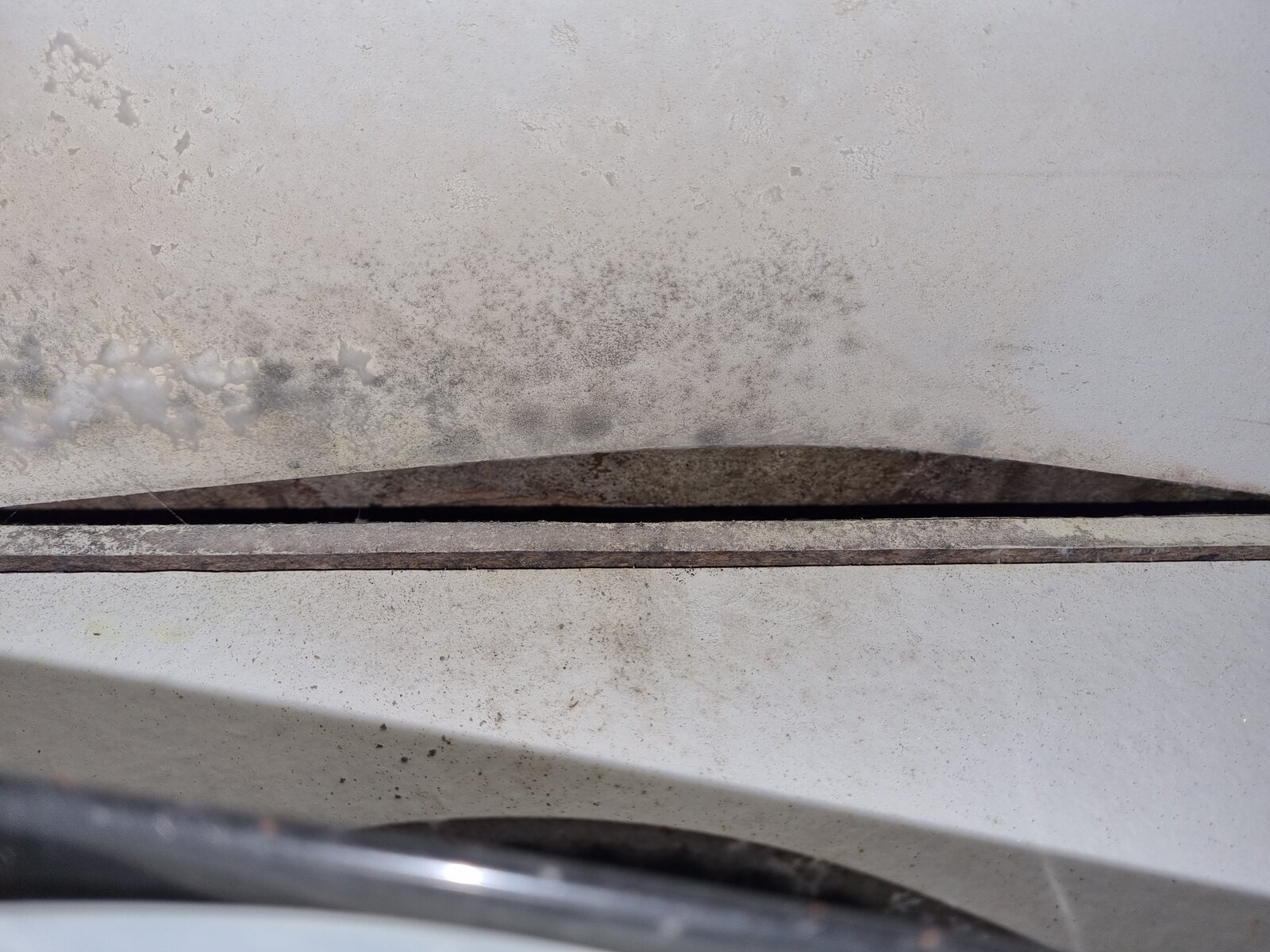

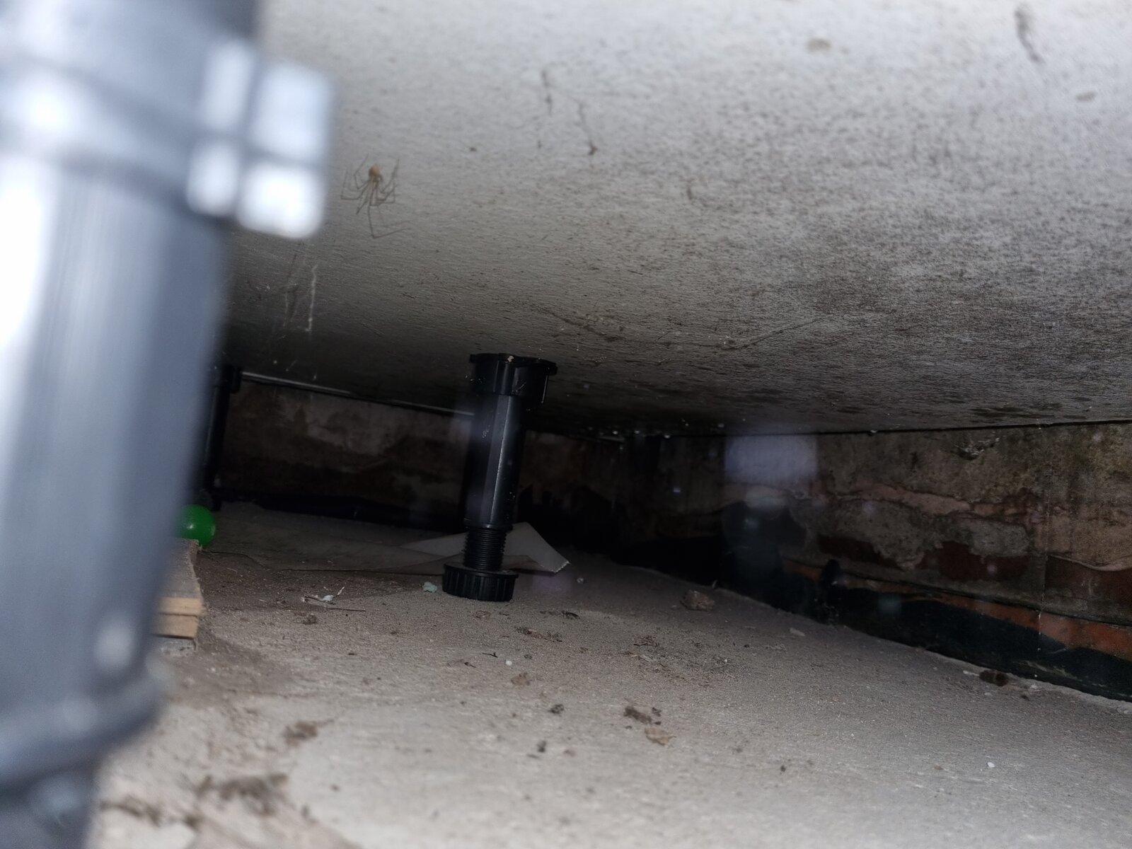

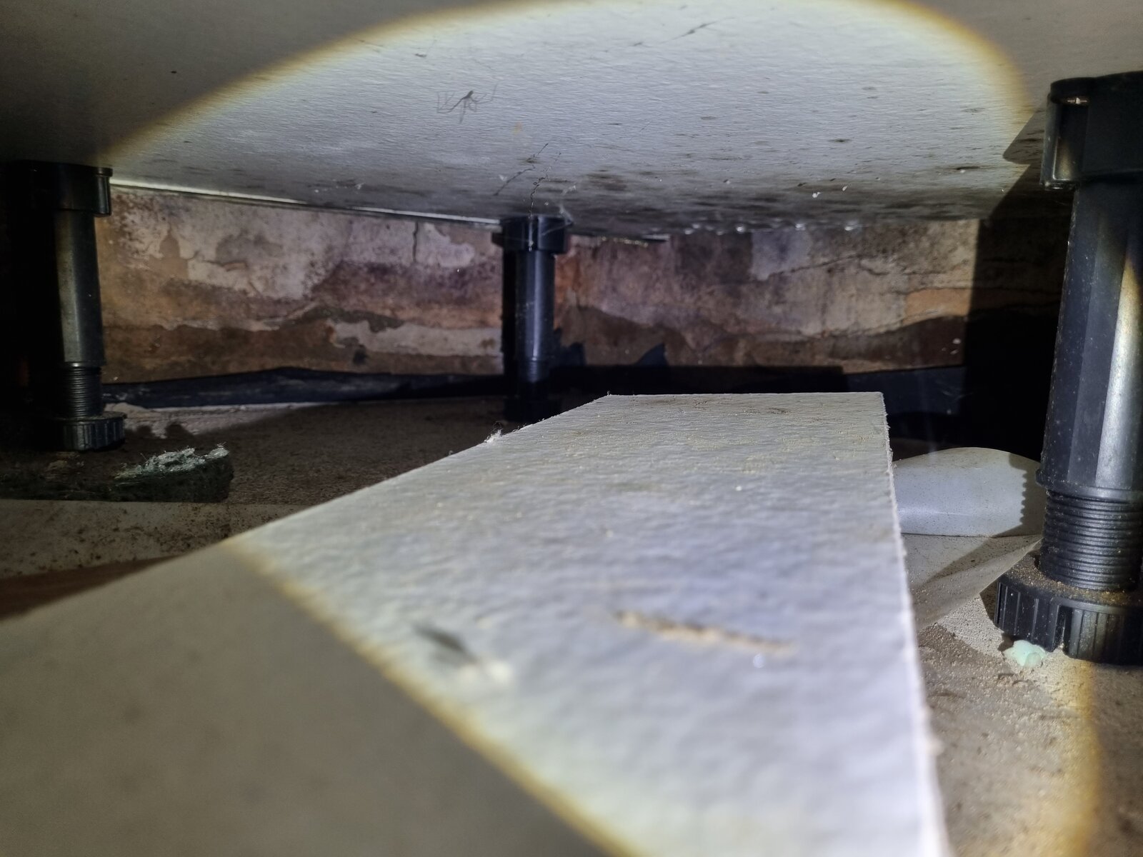

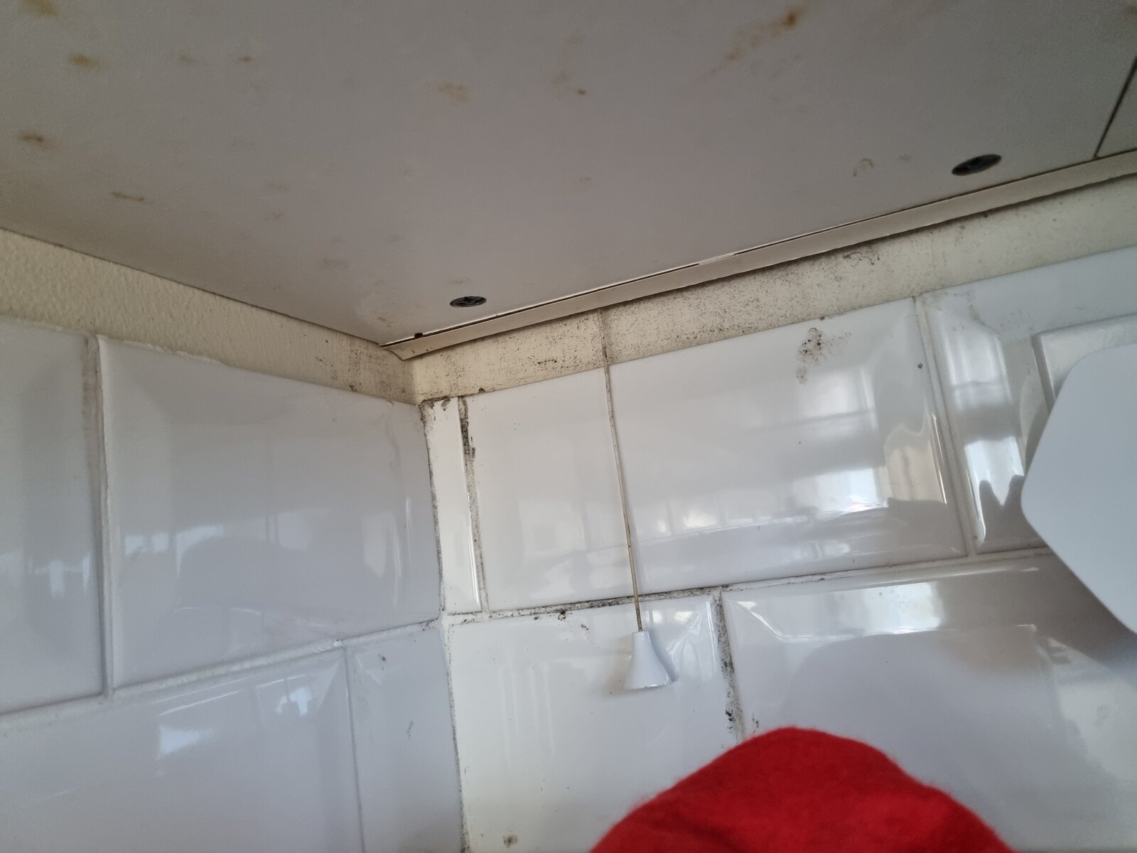

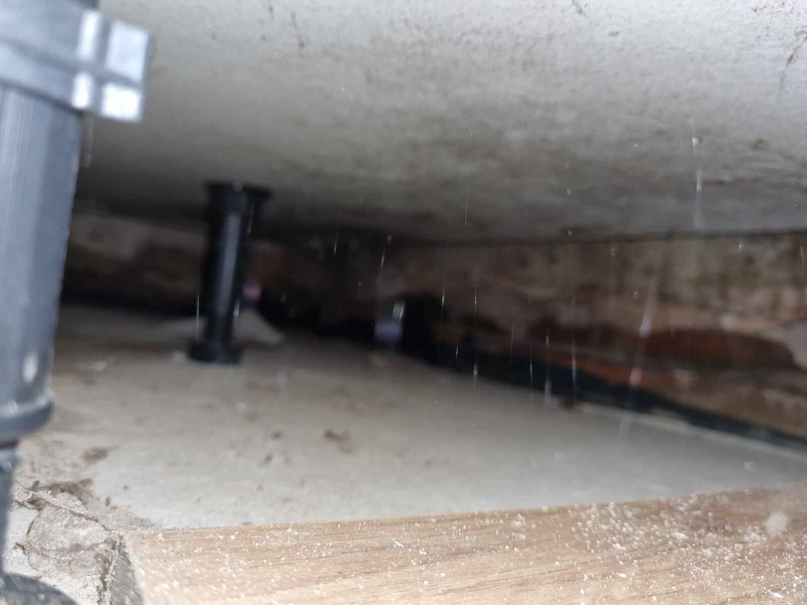

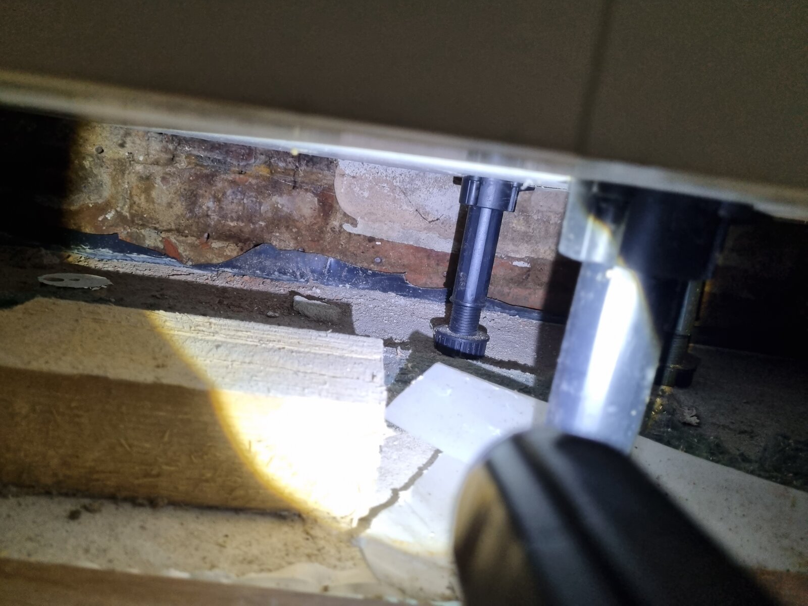

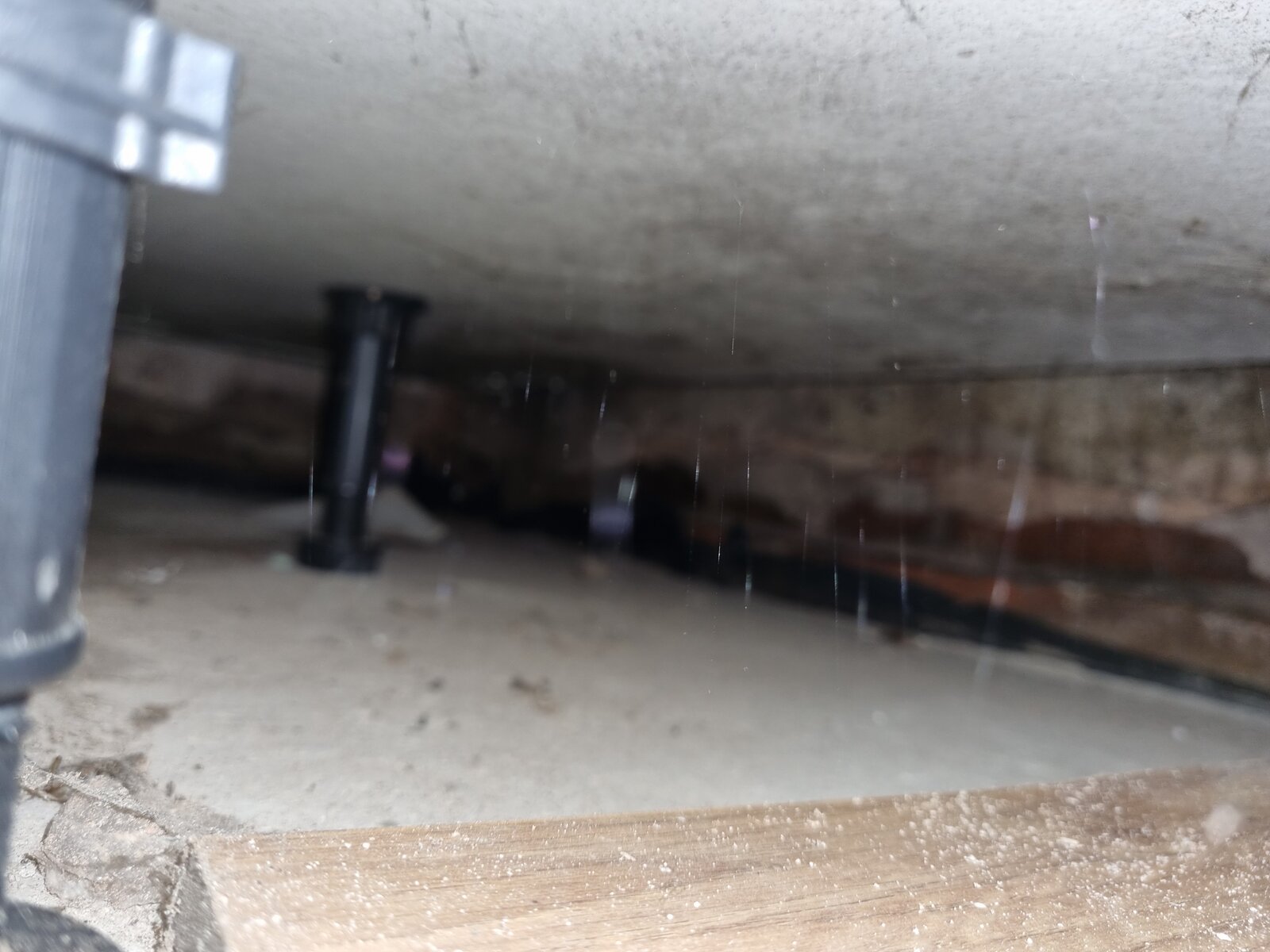

So this is the offending section now
This is a close up from underneath the above cabinet

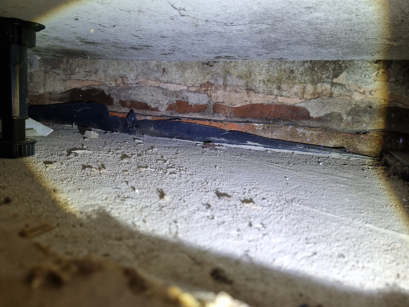

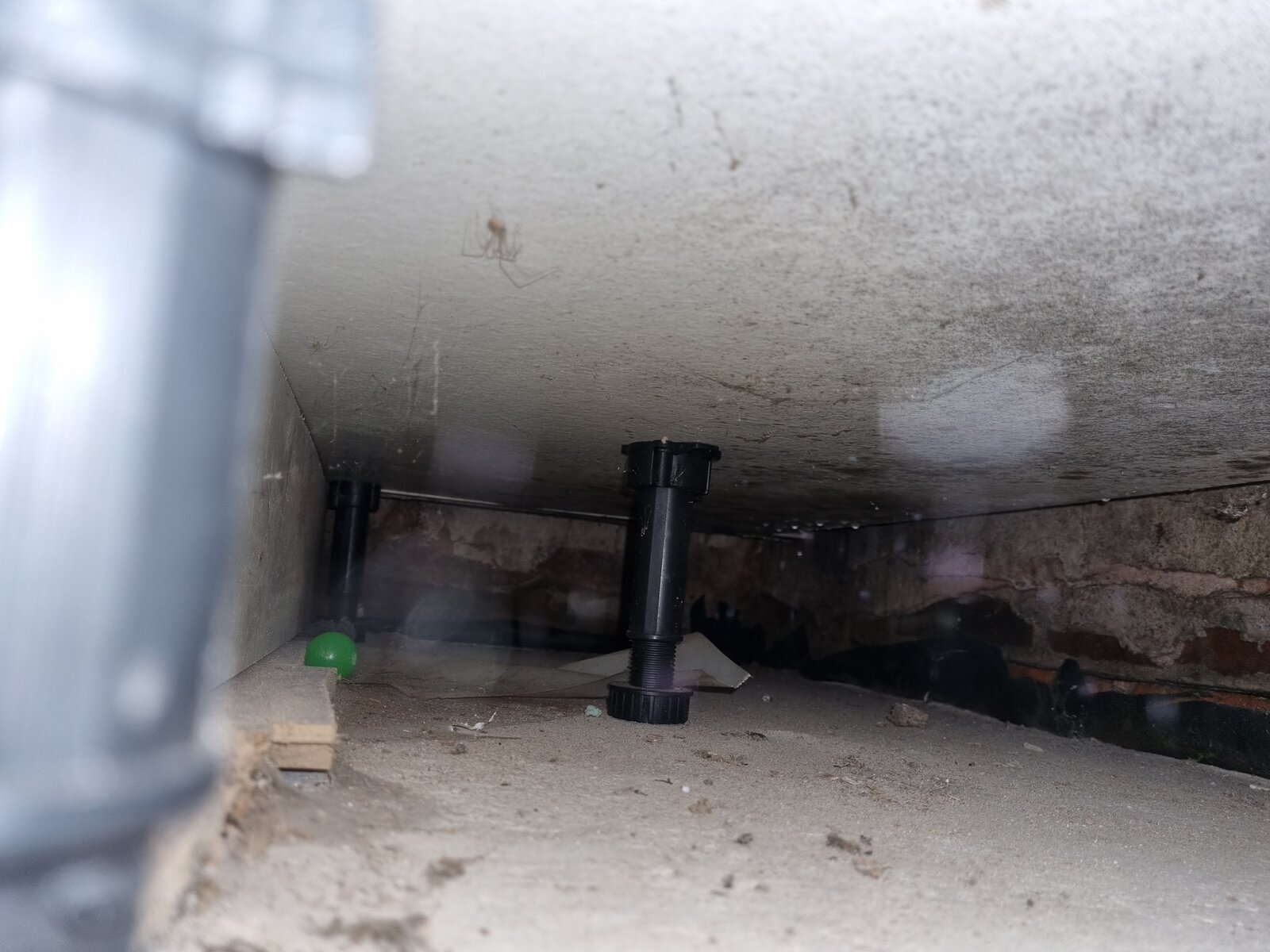

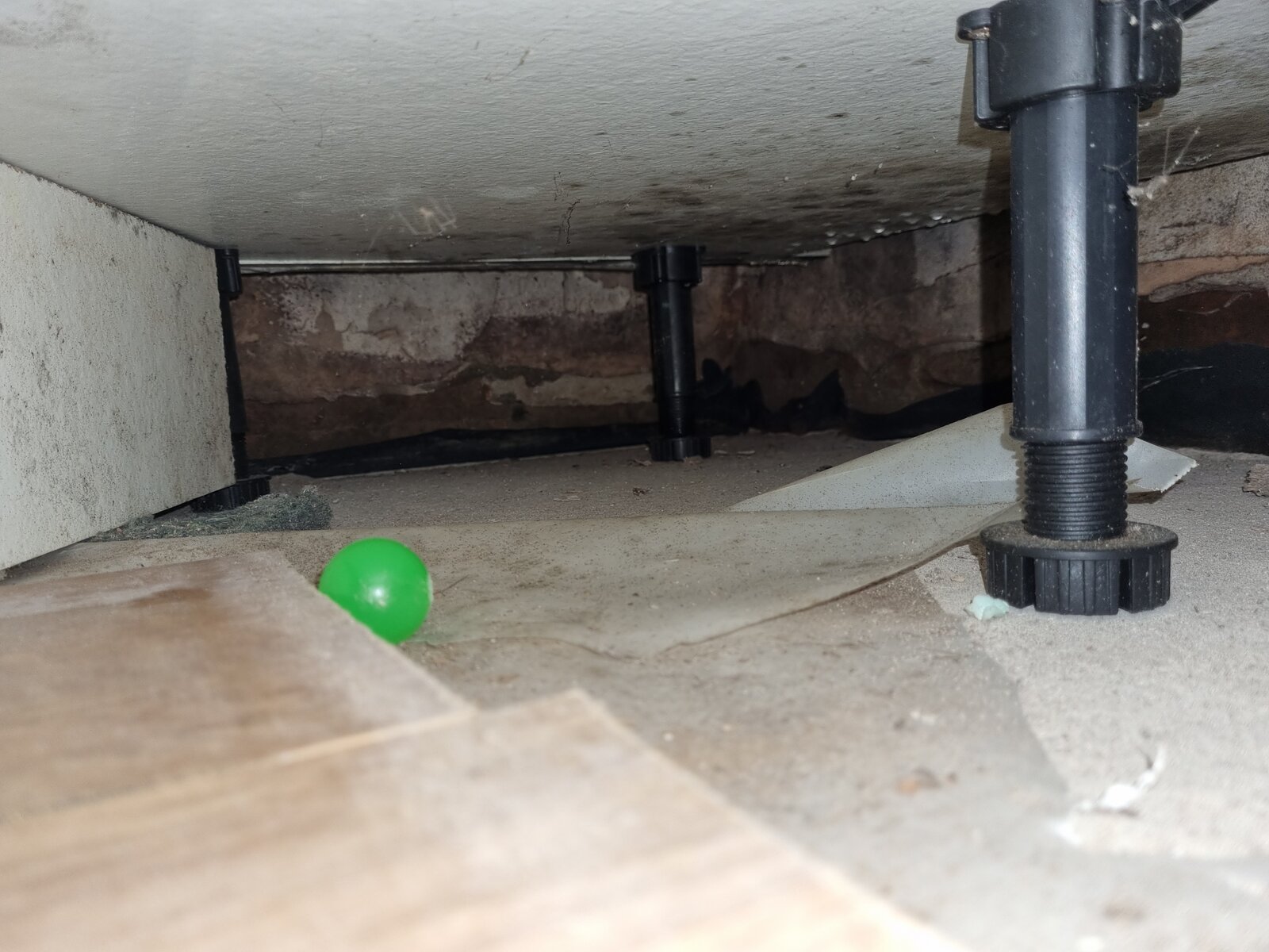

These are images from inside and below the corner unit
20231226_115146.jpg20231226_115146.jpg20231226_115143.jpg20231226_115137.jpg20231226_115133.jpg

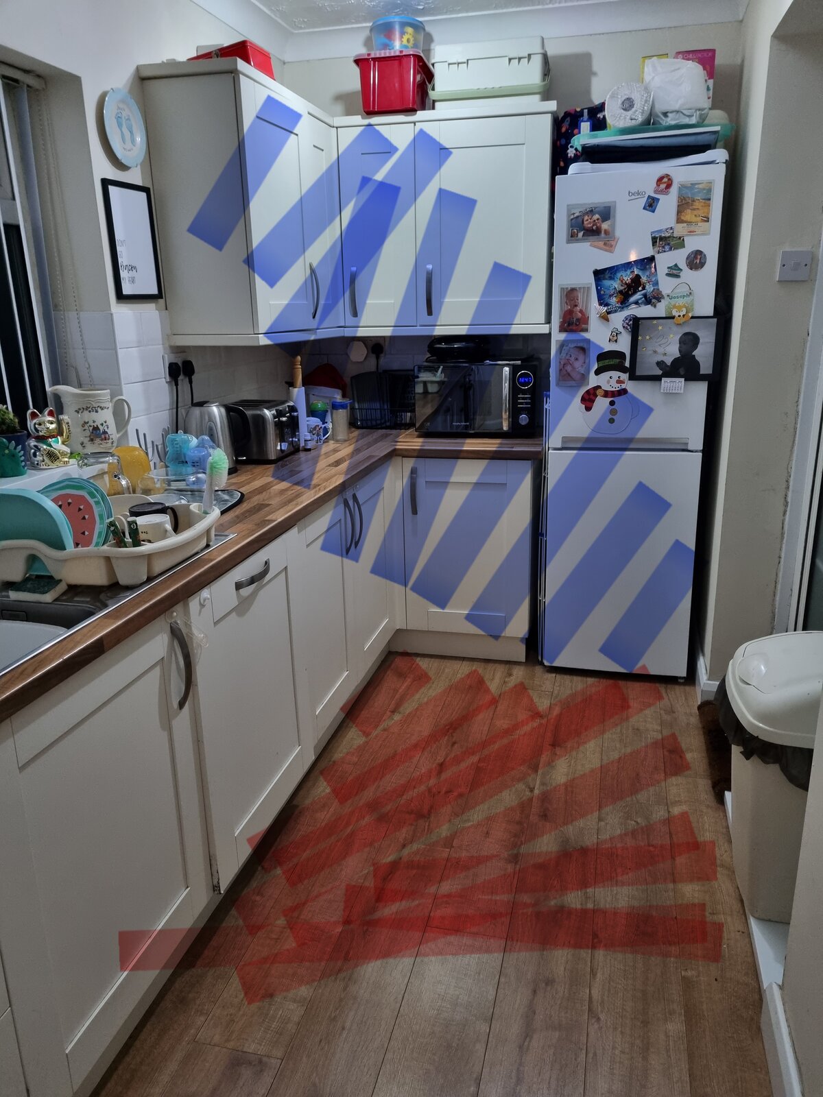

This image i highlight the mould
Blue is the mould
Red is concrete floor

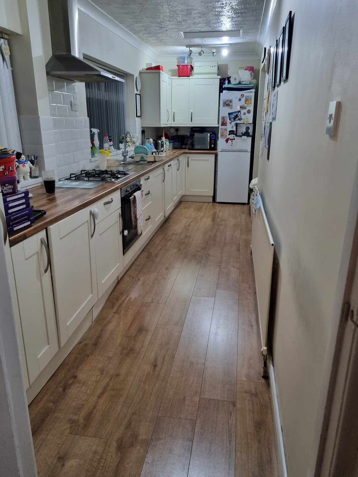

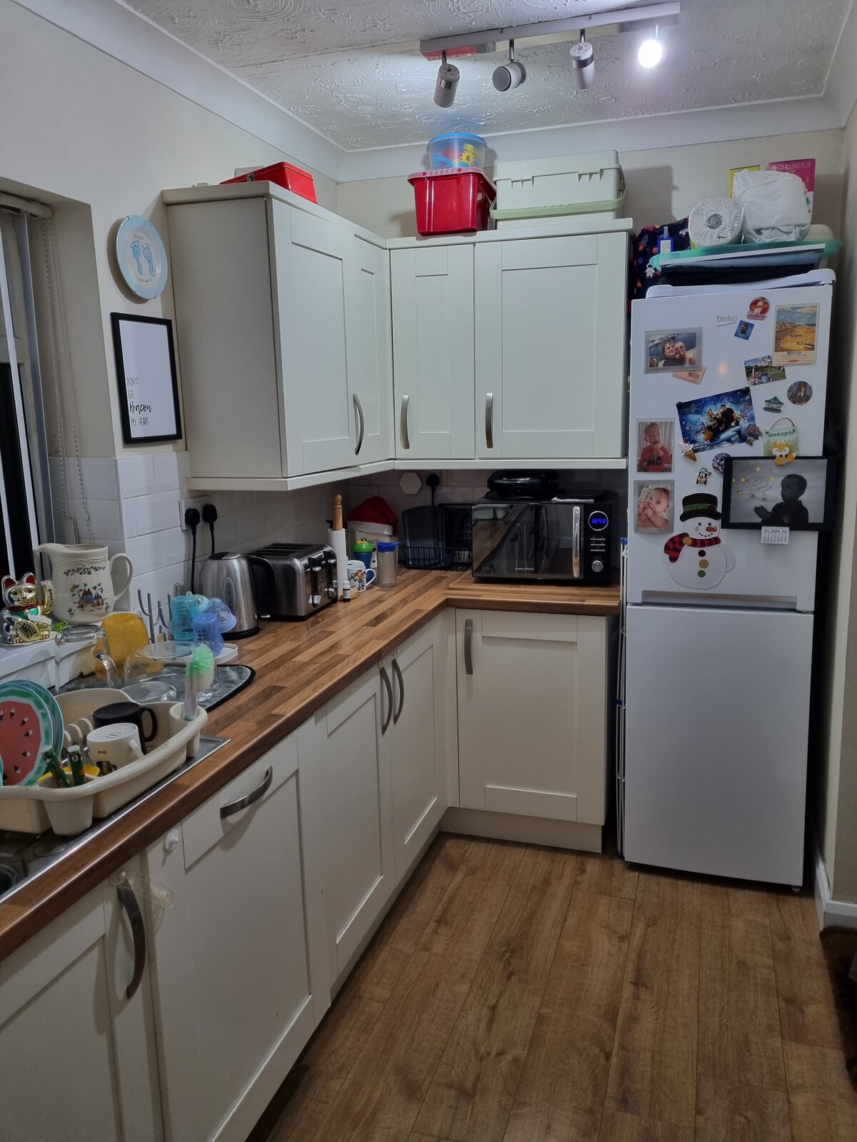

And just for a longer view.
The whole kitchen

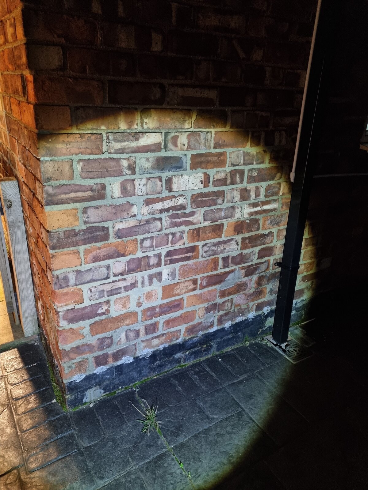

It was dark by the time i got home so ill do outside wall in the morning.

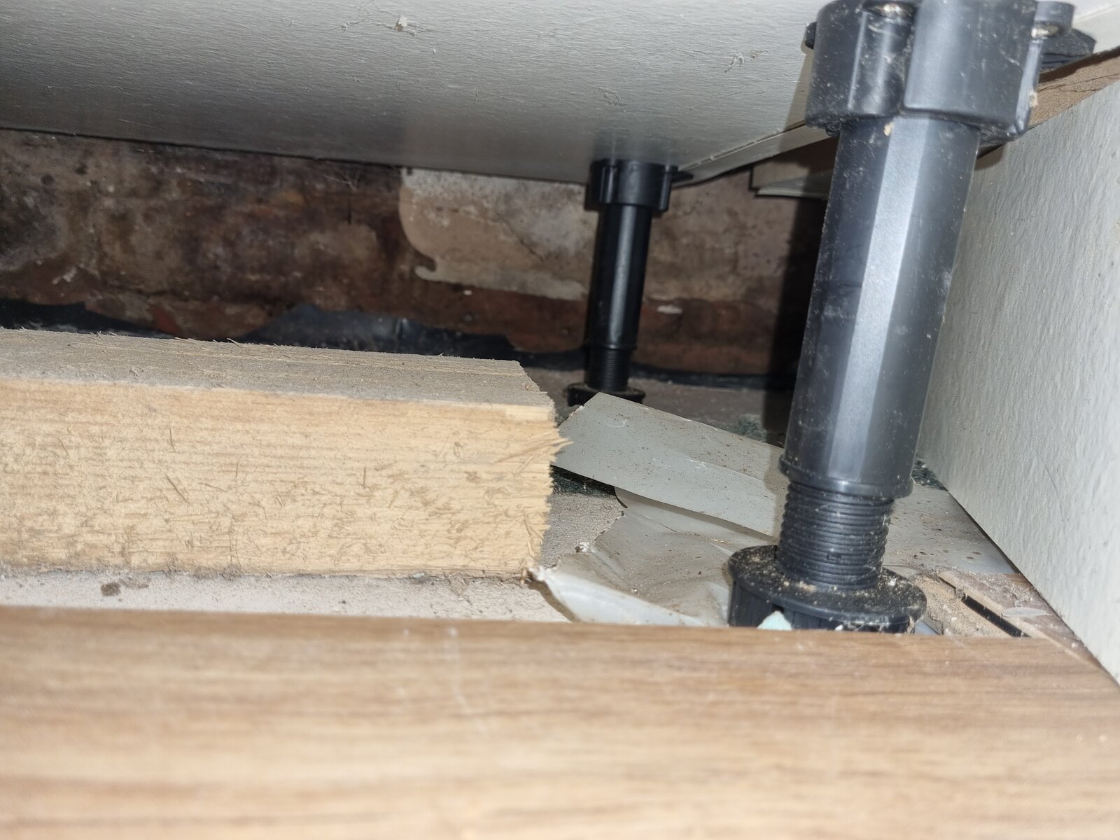

It looks to me like the damp is coming from below. The foot of the wall looks wet.
Is the concrete floor recent, with a DPM under it? Is the floor damp?
Are the base of all the walls wet, or just that one?
Where is your DPC?
Have you got a water meter?
What is the route of the water pipes, between the outside stopcock and the kitchen sink?
The concrete floor i think was 're done' about 6 years ago.

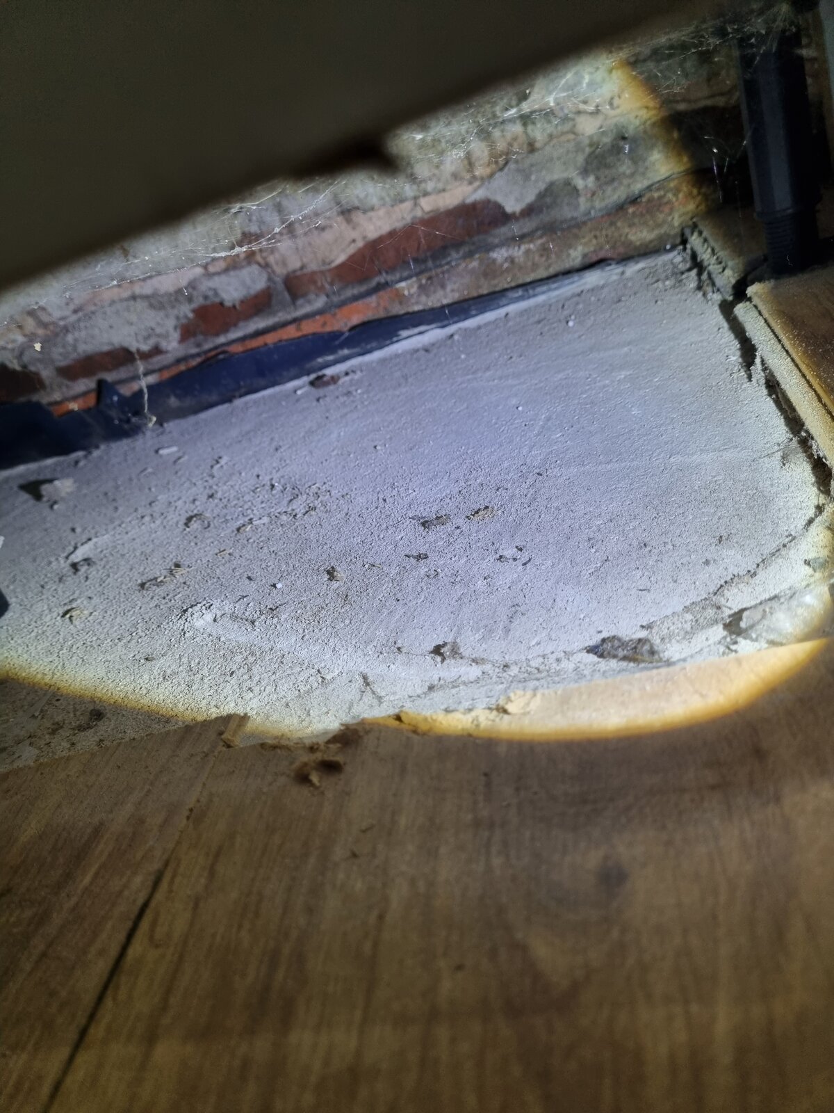

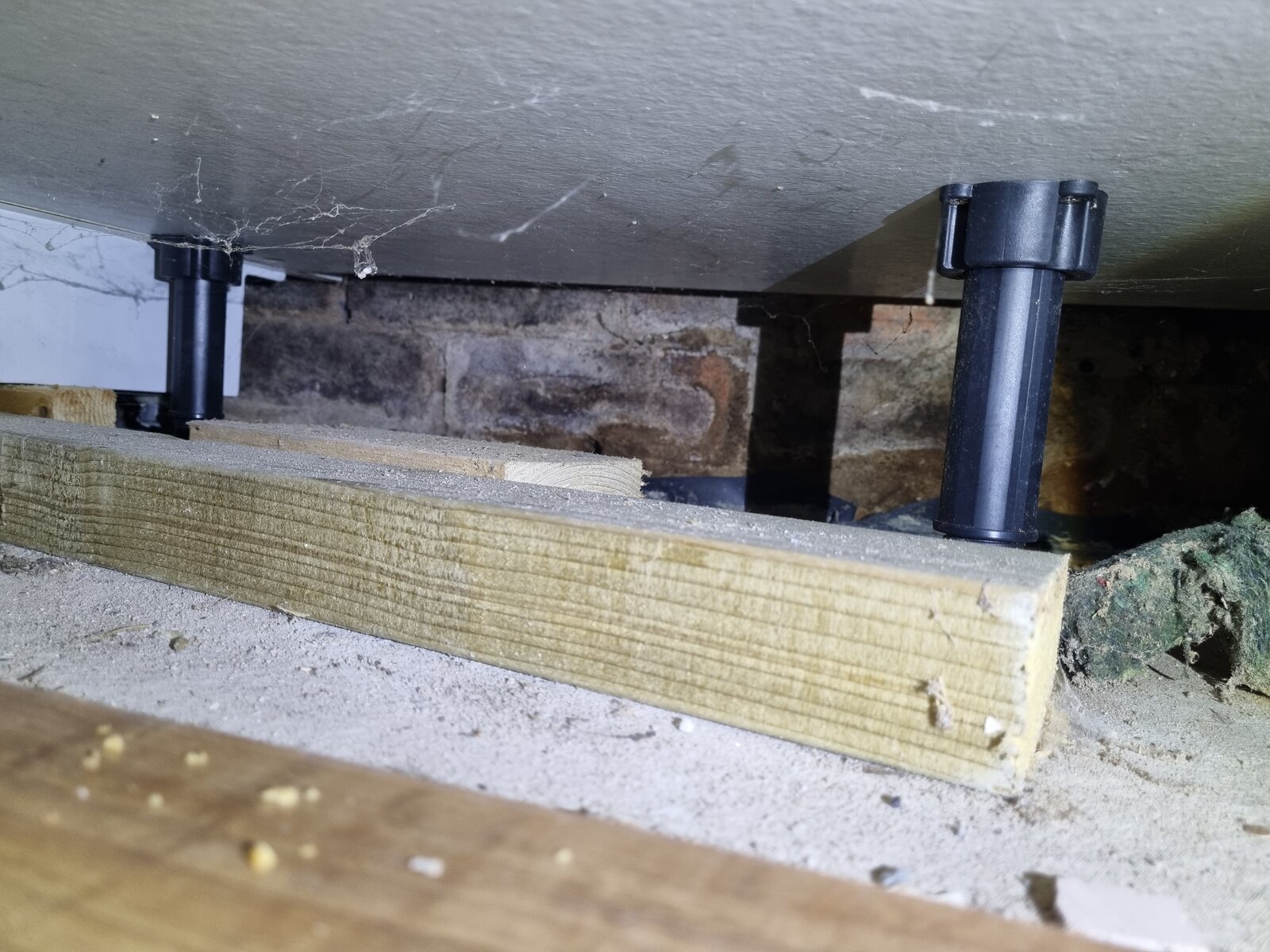

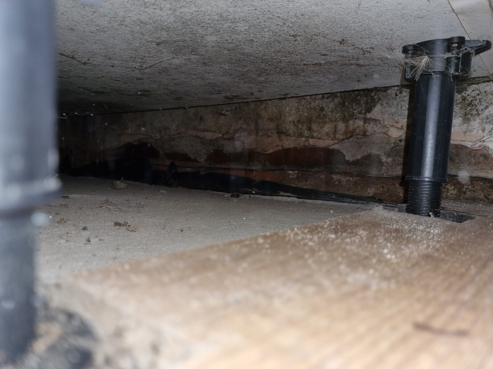

Ive pulled the other kick boards off to see if i can get some more useful images.
i think in one of these you can see a dpm for the concrete and one in the wall?
Theres a few where i used a torch rather then flash too.
This last one is just trying to show the concrete state

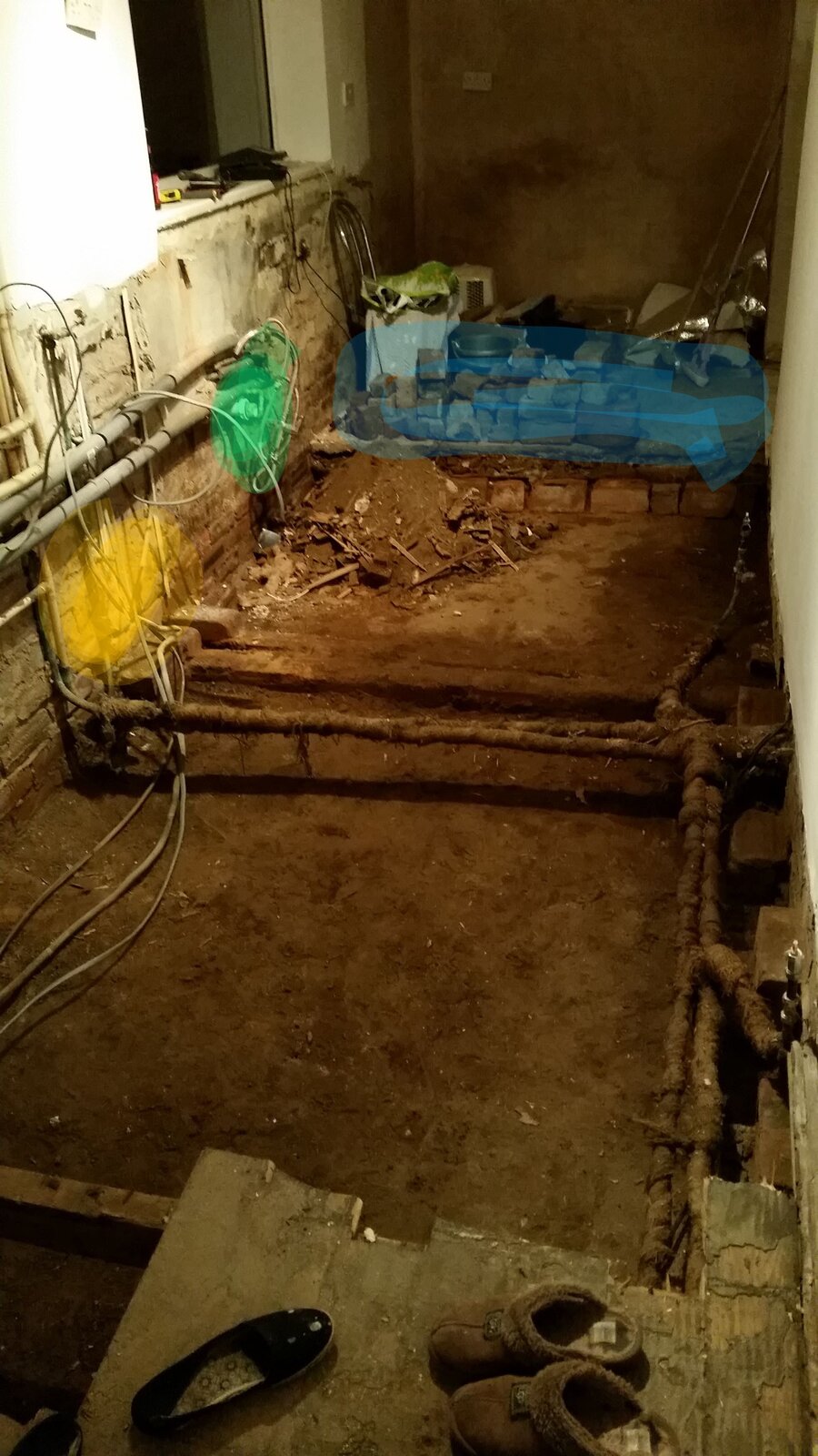

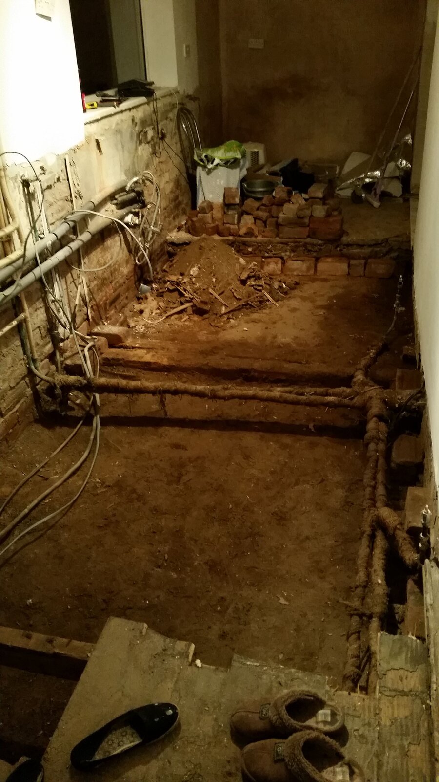

I found an old image of it all ripped out before the concrete floor got redone.
Ive highlighted the stopcock in yellow
Also the original without the markup
The wall im having issues with is the far one in the image which looks to have fresh plaster on

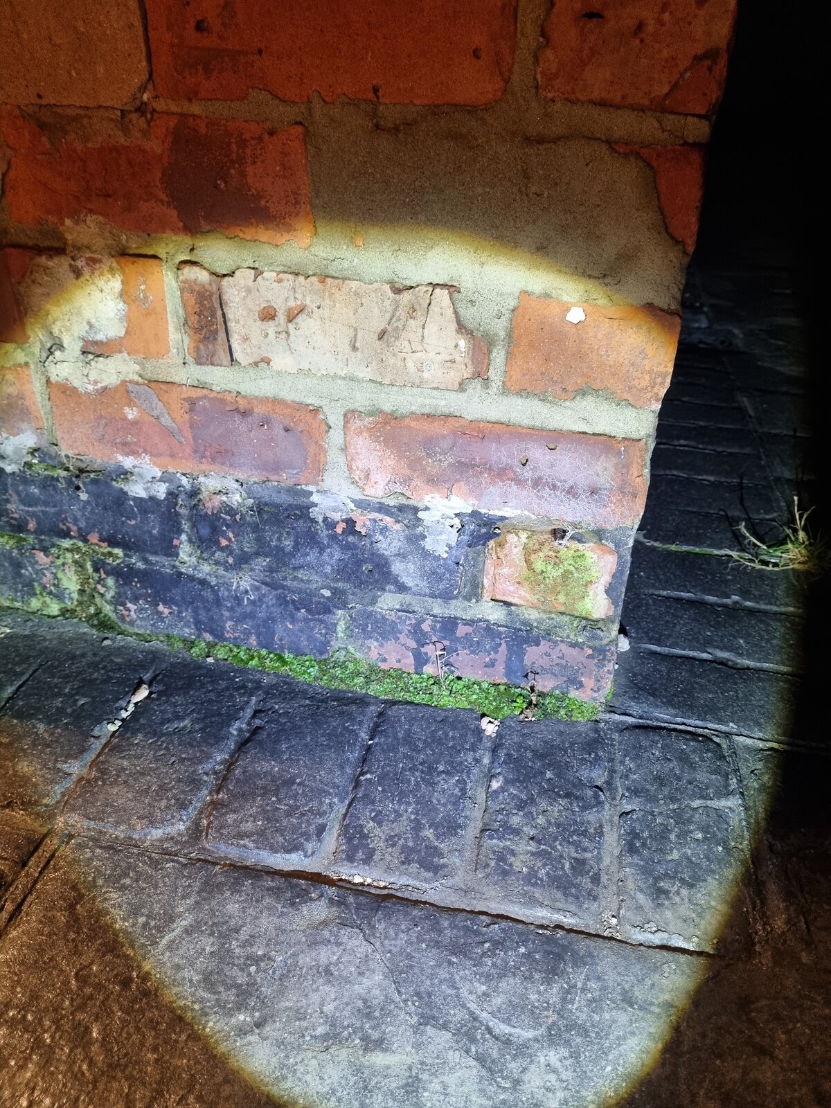

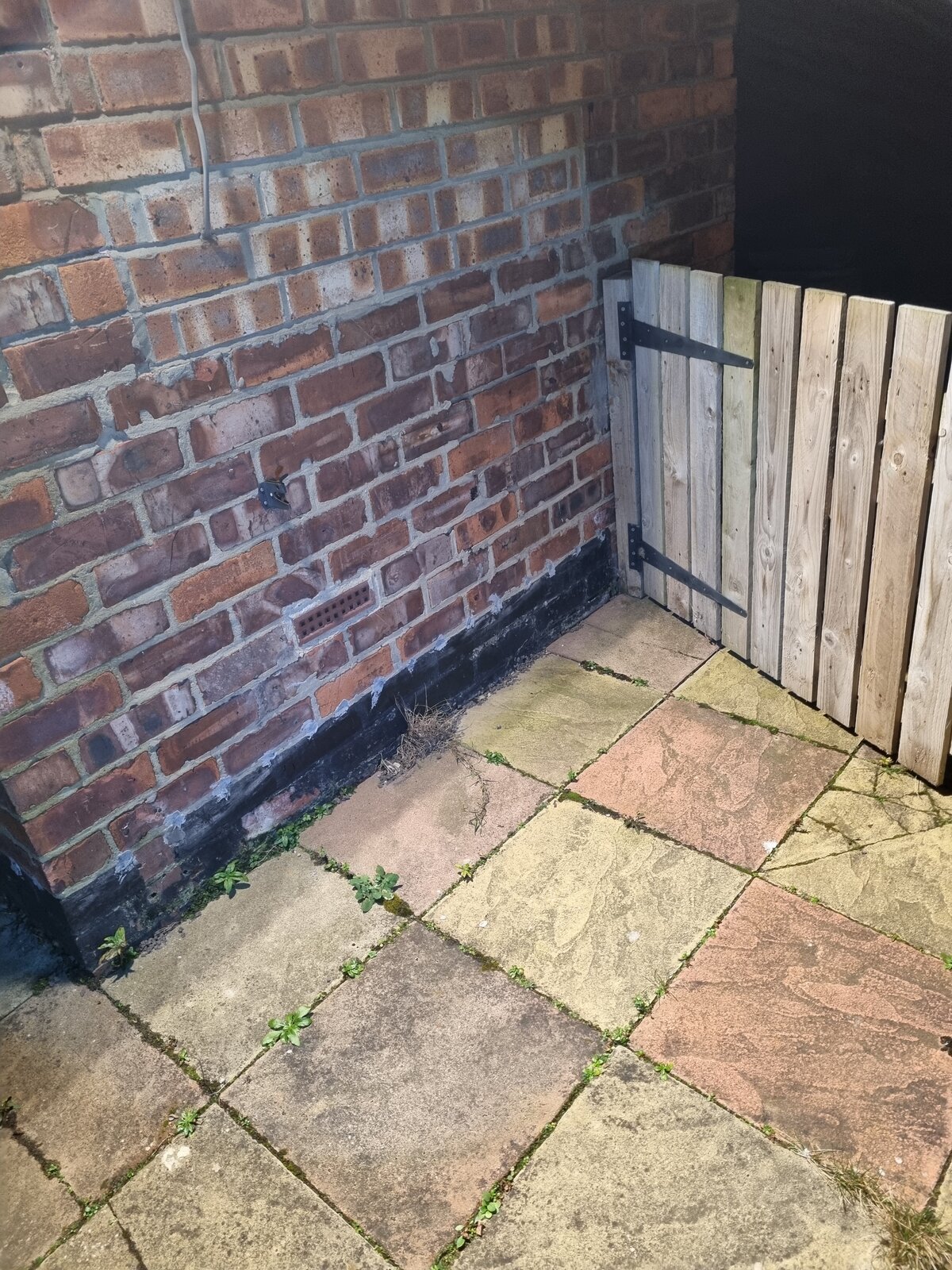

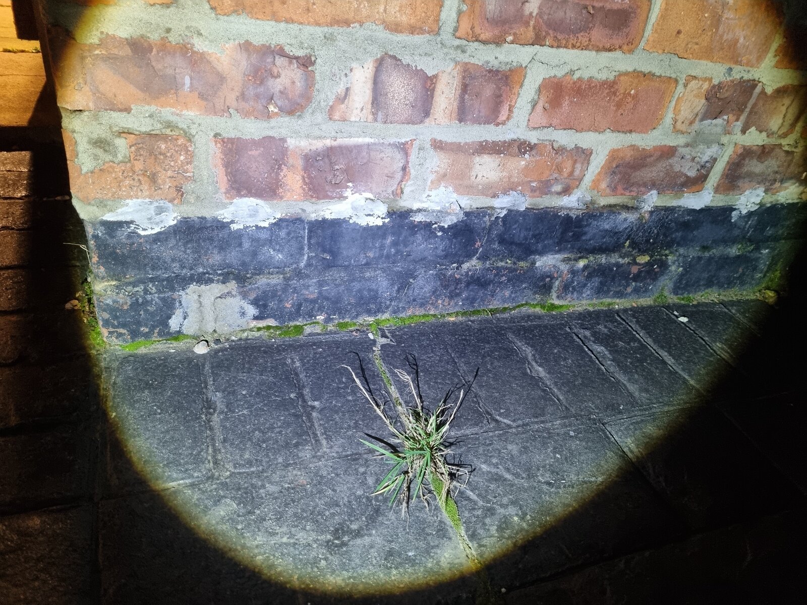

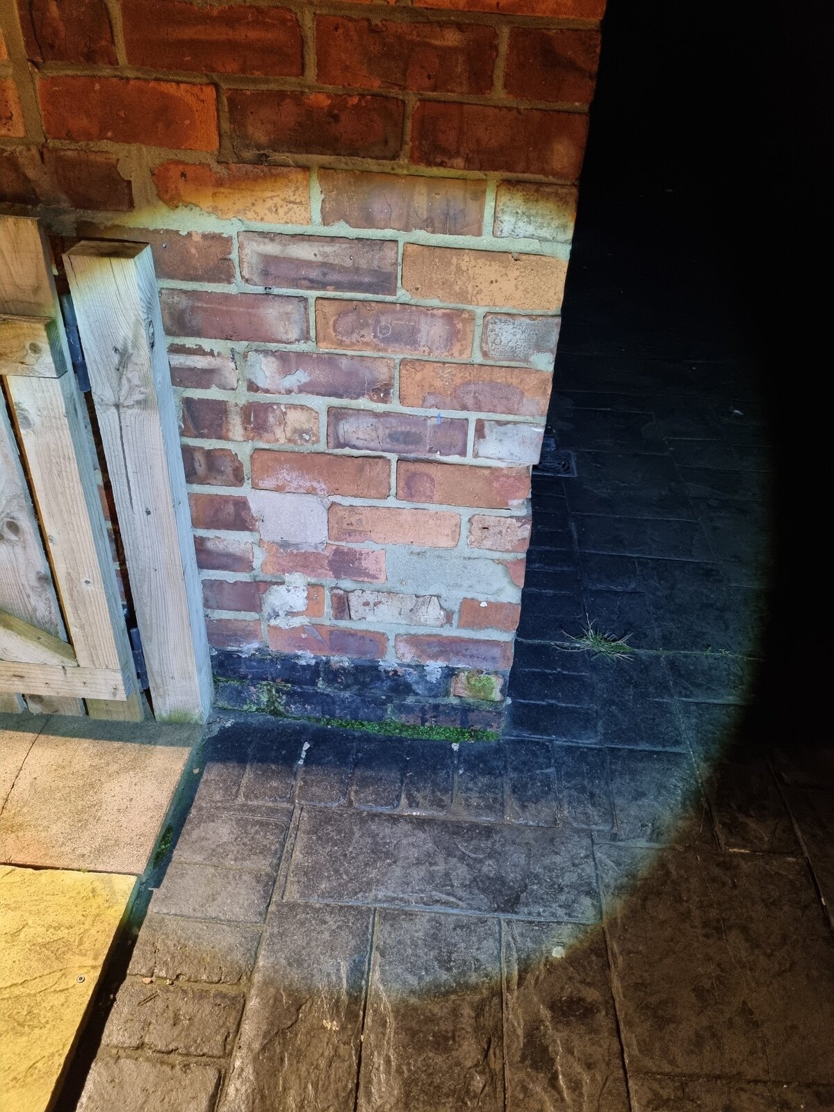

Its a concrete driveway. On one side
And a patio on the other.
here are some night shots for you.
ill get some better ones in the light
20231226_213823.jpg20231226_213810.jpg20231226_213753.jpg20231226_213804.jpg20231226_213759.jpg
