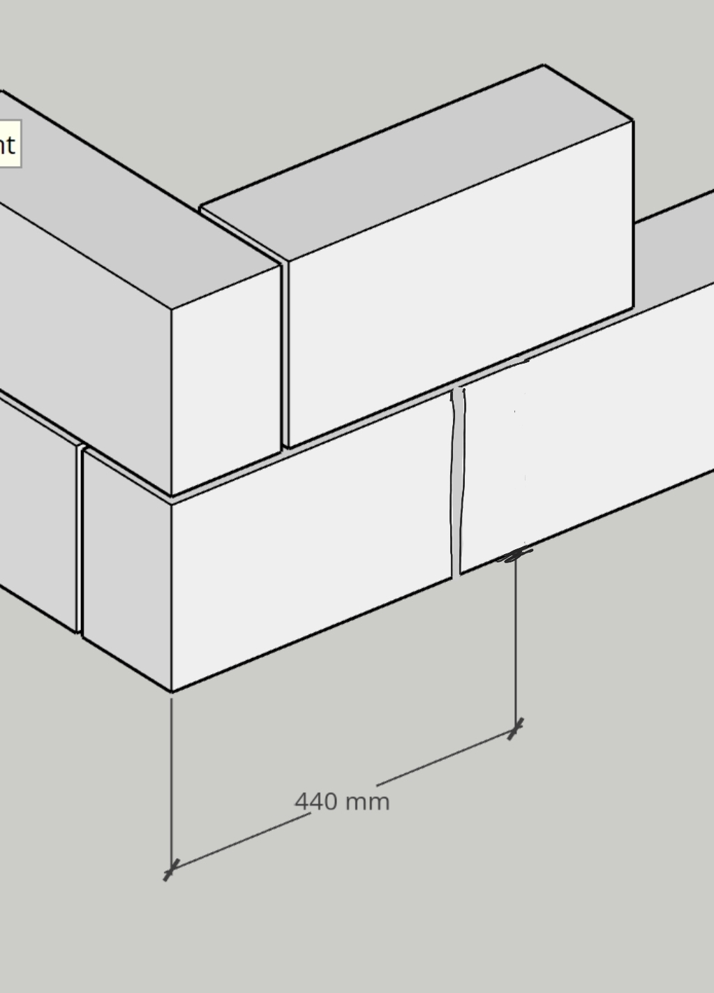

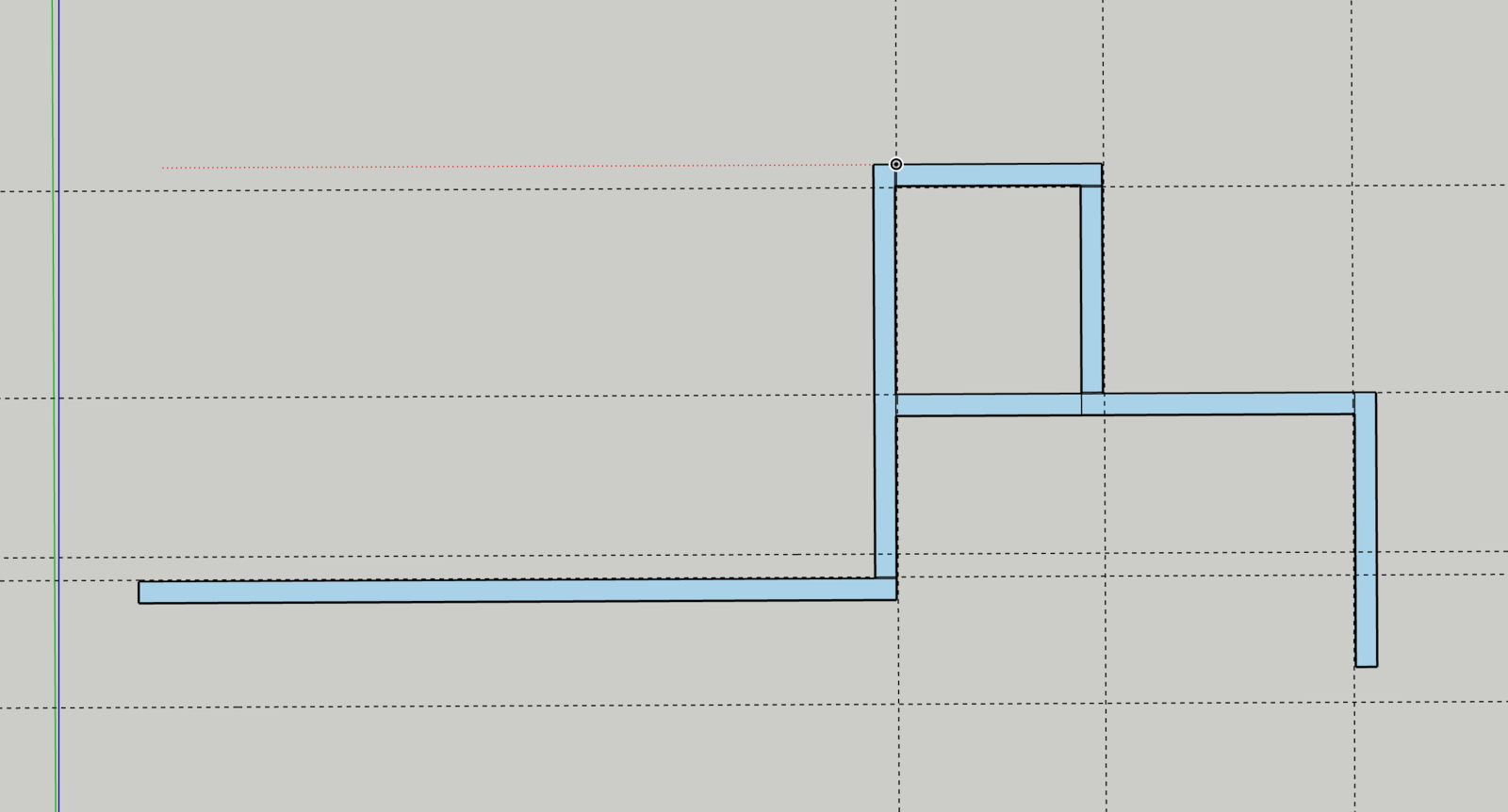

My first question is in terms of the design. There are a number of corners (see image) and I was wondering whether it is best to account for the length of the blocks at this stage to avoid having to make lots of cuts etc? There is scope for the design to change to accommodate a full number of blocks etc rather than having to cut.
My second question is to do with the bond. Is there a standard bond for this size/type of block? I can see it might be tricky at the corners.

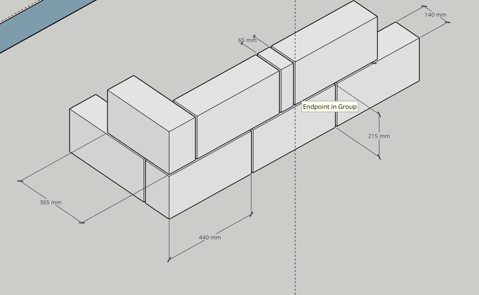

At the corners, I'd suggest you cut 75mm off the full block to get the bond rather than put a 75mm cut in next to the 140mm end block.
Start at the most visible section and set the wall out dry, or measure the wall ends for the corners so that it works blocks. The 'T' junctions of the wall should be where you can bond over the centre of a block, so as to give even cuts either side of the bonded block, otherwise just use some tie wires to join it.

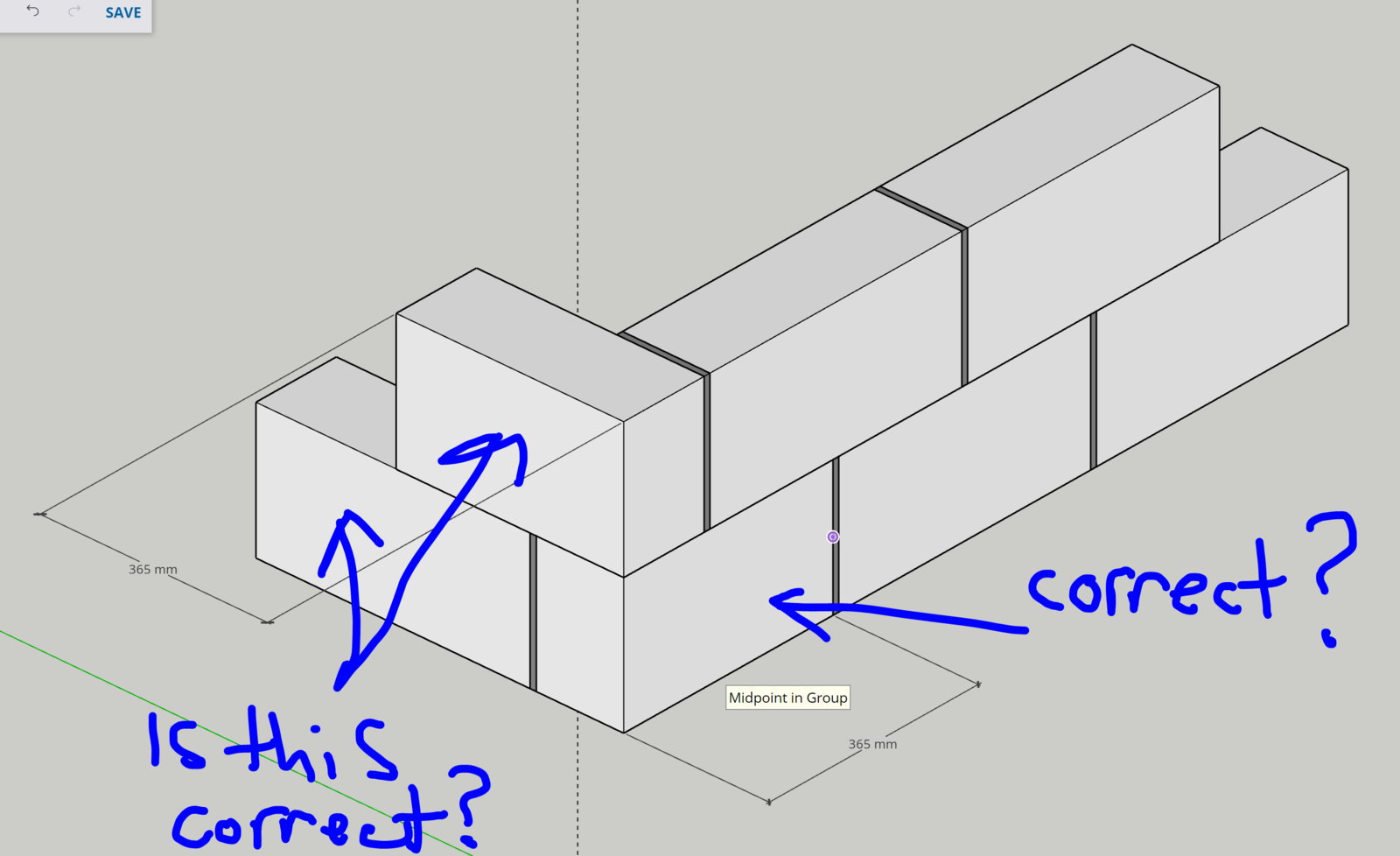

Hi, thanks very much for the info. Is it something like this you were meaning? It makes sense to me now, by cutting the pieces it gets it to half bond.
Is that what you meant?
