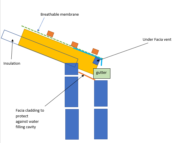

Hi, I'm working on a vaulted ceiling.
Currently I was considering, what I think is a cold roof (air gap above insulation), though I like the idea of a warm roof as it mostly eliminates the need for venting. If I stick to the original plan (cold roof) then I'm proposing to build as this illustration. Does this sound about right?

with a warm pitched tile roof the felt is fitted on the rafters a normal, then there are battens fitted on top, running in line with the rafters
then the tile battens are fitted
then anything from the top of the rafter down needs no ventilation.
that enables the venting to happen above the gutter -which might help you if you have no soffit to vent into the rafter space like a conventional cold roof
but it needs properly detailing
if you go to the dupont / tyvek website there are various construction detail options for cold and warm methods
