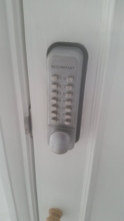

When we moved in two years ago one of the rooms had a Securefast lock on it. We don't know the combination, and have no way to contact the previous owner.
I'd always meant to remove it but never got around to it. Then last week someone knocked the snib off and pulled the door closed, so now we can't get in.
Is there any way to get into this? Do we need to destroy and replace the door?
What would you do?
Pics below:

Thanks. I never thought about knocking out the hinge pins. I'll try that. And if not then the angle grinder on the hinges.

It might be possible to find the code by the sounds each key makes as it is pressed.
After clearing the lock ( key C ) one of the keys ( the first digit of the code ) will operate more of the mechanism than the other keys.
Hence the key that is the first digit will ( should ) result in a different sound ( ear against the door ) than the other keys. That might identify the first digit.
You will have to clear the lock before pressing each of the digit keys. C 1 C 2 C 3 and so on
Then to find the second digit
C * 1 C * 2 C * 3 where * is the known ( suspected ) first digit.
And so on until the lock opens
This is a theory, no garantee it will work
Get two very thin flat blade screwdrivers. Insert them into the gap like this...
Lets say you only have 2mm of play to work with. Use the first screwdriver to press against the latch and lever it to the right by 2mm. Then with the second screwdriver, press against the latch so that it doesn't spring back to its original position, just to hold it there. Then, again with the first screwdriver, lever the latch to the right by 2mm more. Then hold its position with the second screwdriver again. Repeat these steps, moving the latch to the right by 2mm extra each time until it opens.
Bernards trick of 'feeling' for the code does work, but is only really possible on old, well worn locks that have had the same code for years. The springiness of the keys that have been constantly used fades and make a slightly different noise and feel different when pressed. Don't forget that with this type of lock, you can press the keys for the code in any order, or press all the right keys together, or two at a time, etc, etc.

Many thanks Gaz and Bernard. If the sounds don't help me I will try the screwdriver trick tonight. That sounds promising!

BTW - once you get back in you can reprogram the lock, so be careful aout dismantling it.
Stick it on ebay.
The 1mm disc is for cutting through the latch, use 2 screwdrivers to open the gap between the door and frame. Then cut through the latch with the disc and the door will open.
The lock will now be worth nothing and will need throwing away.

In the end I decided to try and work through the combinations, starting with the numbers that looked most used.
When I looked more closely I could see that the area around some keys was clean and slightly oily, whereas others were dirty and dusty. I got it on the 2nd attempt! You can just about see from the photo what i mean, though in person it is much clearer to see.
It was C 123 XZ
