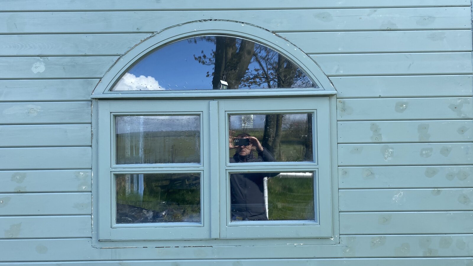

    Hi guys, I'm about to paint a shepards hut that I've got and wondered if I should be finishing these windows off?
    Is there anything that I could buy off the shelf that would arch around the half moon window?
    Should I just trim back the silicone and paint it in?
    What would you do? I have not access to joiners atm so creating something is not an option :(

    Remove the silicone, prepare the lot for painting, then replace the silicone with paintable one and once dry go on with the paint.

    Would I actually dig the old out, cut a V channel? Any particular silicone you would recommend? Try and do a neater job, smooth it out and no need for any trim?
    Sorry for the Q's just a little unsure on this and want to get it right and looking good.
    Cheers!

    I use soudal fixall which is strong and paintable.
    If you're not confident with silicone, mask the edges and then apply the silicone in the gap.
    Smooth it with a wet spatula for a very flat finish, then remove the masking tape an pass the spatula one last time.
    Let it dry and then paint.
