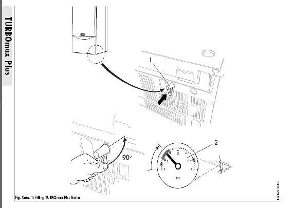

I have a Vaillant turbomax plus 824e/2.
Apparently this is the appropriate manual:
http://www.vaillant.co.uk/stepone2/data/downloads/cd/44/00/thermoi.pdf
Which shows this for re-pressurizing the central-heating :
This seems wrong, or out of date, for me too.

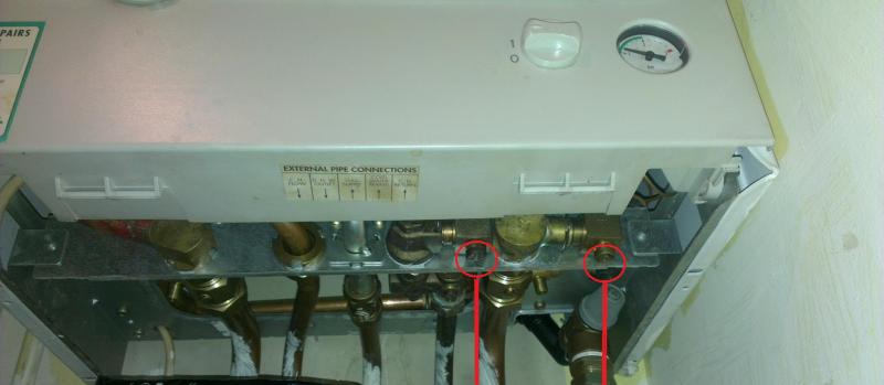

In my case there are valves turned by a screw, no sign of ever being a tap/handle.
I had an apparently F.28 (supposed to be a gas supply problem, p77) but was also seeing low Central-heating pressure.
So re-pressurized, and all was well.
To re-pressurize turn both the highlighted (in above image) valves 90 deg to get around 1.5 bar.
