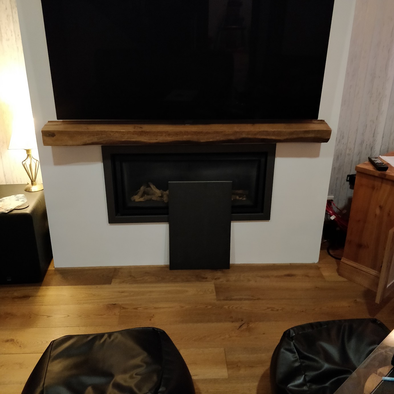

The wife wants the bottom of the fireplace tiling up to the wooden beam (see pictures). I've got a couple of questions that I thought you might be able to help me with...
Firstly... which way would you put the tiles on this... would you put them longways or up/down as per these photos?
My gut instinct is to do them longways (the photo above) but I've only ever tiled once before and it was a bathroom with square tiles so I've no idea.
Secondly, my instinct is to start at the bottom with a tile right in the middle and then work outwards on both sides and then up? Is this the correct way to go about it? Or is there a better way?
And lastly... the fire you see in the picture is a 'real flame' gas fire that gets very hot. Do I need a special kind of adhesive or anything in order to tile on to that wall or is there anything else I need to consider?
A big thanks for any help/advice you can throw my way.
Cheers
First off- check that they are ok at the temperatures. A tile shop may be the best advisor re cement?
Set out the tiles so you can see how the shape and cut pieces pan out. You need to avoid tiny slivers of tile which will look naff. Decide whether you want a grid pattern or brick bond? How about edging?

you dont need any special anythin just basic adhesive an grout
i dont usuly like mastic tub adhesive but a tub would be ok for that bit of tileing.
find/mark the centre of the c/breast
dry fit the tiles so that if possible you have a centred tile
and two even cuts at each end of the course
those tiles are usuly fixed vertical but with your job it doesnt matter - vertical or horizontle
the cut edges go to the floor and to the outside corner edging strip
leave a small gap at the floor for floorin movement
dont go to tight to the appliance surround - the surround might have to be future removed etc.
the edgin trim strip is glued with the adhesive make sure its plumb or level.
youl have to google for black trim but its probably out ther?
