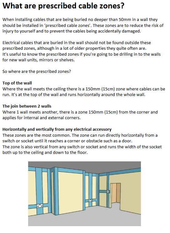

No, cables should not be run behind skirtings.
Ok, so behind the skirting is not an option then.
Has anyone dealt with this problem before and now had to rewire the ring to come down from the room above?
They can pass vertically down behind the skirting, but not run horizontally behind it. If the under floor is to become inaccessible, for any future modifications, and you expect them to be needed, then the only other way is down the wall, from above - exactly as would be necessary, with a solid floor.

Option 1 - cables under the floor but installed in conduit so they can be replaced in the future without removing the floor. 20mm or 25mm round conduit would be usual, either steel or plastic, with single insulated wiring pulled through after the floor is installed.
Option 2 - locate cables elsewhere. That could be in the ceiling with drops to each outlet, or more likely would be horizontally between the outlets which will use less cable. Suggest those are also in conduit so that future replacements can be done without destroying the walls.
