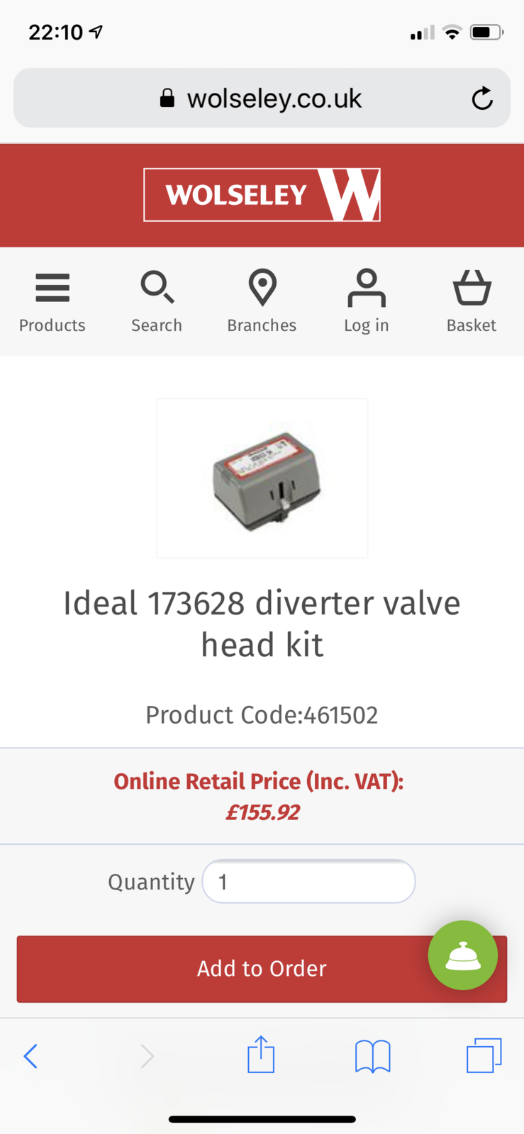

    Engineer turned up, investigated and the verdict was - actuator valve head. Advised me not to spend 250 quid on repair, save money and wait until the boiler brakes, then get a new Vaillant with 10 years warranty parts and labour. Didn't charge me a penny as well

    The part ranges from £10-£90 on ebay and is a 5 minute fit.

    They are about 170 retail for the honeywells which make the noise so it’s not really ott as a retail price is it?

    yeah retail price for gas engieer is over 100 quid easy plus his time

    Full valve or just actuator. It’s only the actuator that’s faulty.
