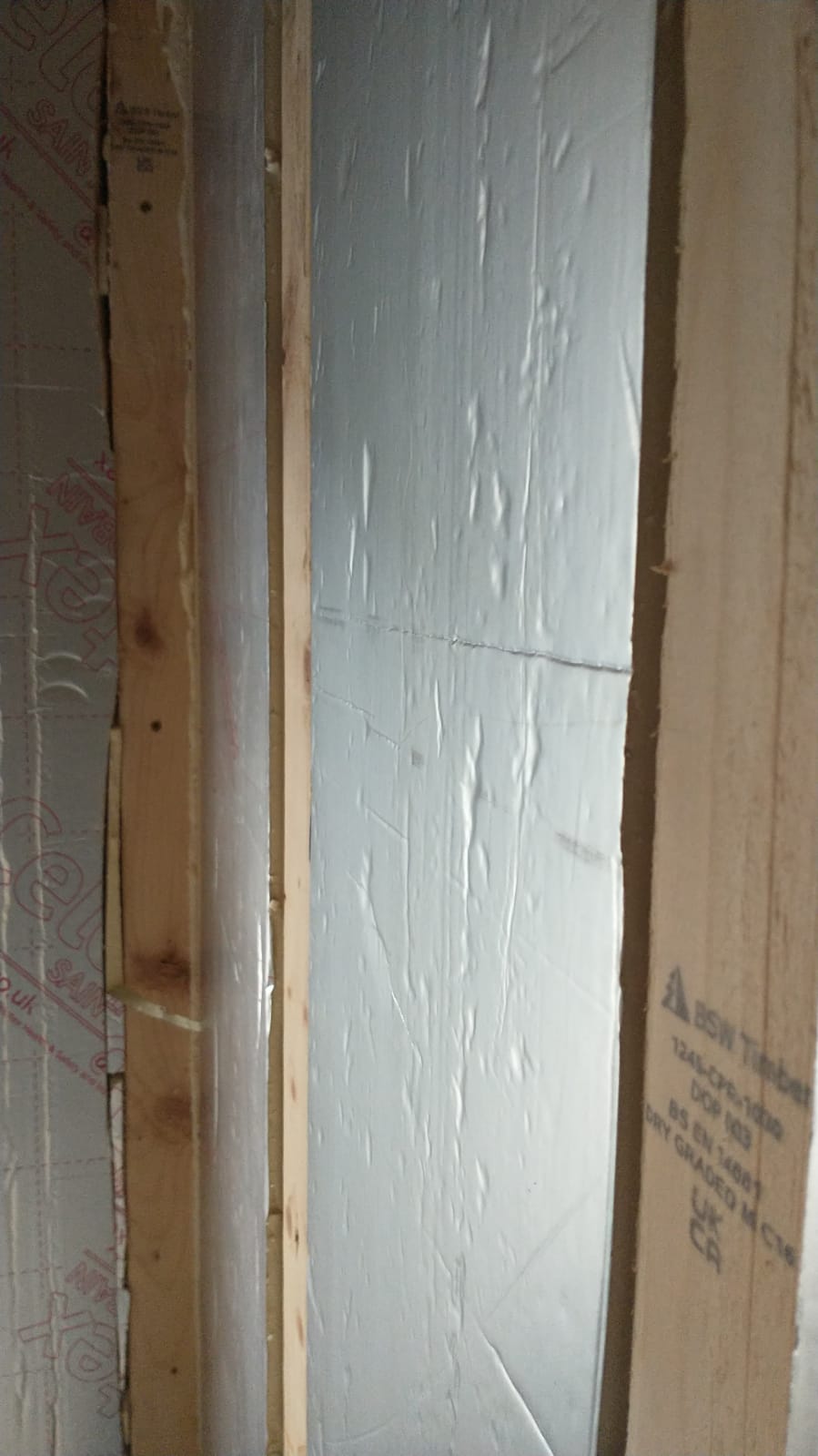

Insulation standing proud of battens
30 Aug 2022
37
My insulation stands equal to or a bit proud of the battens I plan to fix plasterboard to. In the picture below the insulation is somewhat loose and I can push it so its equal to the batten.
1. Is plasterboard pliable enough for this not to be a big problem?
2. Is this a problem for wiring?
Cheers
I
That won’t be any good, you will end up cracking the plasterboard as you screw in.
And those slithers aren’t very good - they are gappy, they need taking out and expanding foam in them: use a metal foam gun and gun grade foam and adjust right down so the foam comes out slowly
Yeah I was planning to spray foam the gaps and then cover everything exposed with silver foil tape. As for the electrics my plan was to cut channels in the insulation for wires and then foil tape that as well.
The wall undulates a bit hence the discrepancy. And the wood wasn't exactly cut as advertised but I never noticed till now. I will try my luck with 9mm plasterboard.
It's a gym in the back of the garden so will only be used for a few hours at most.
Batten it out again on top of the studs, using something thin like 19mm or doorstop
Nobody can judge from the photos. If you can push it in fairly easily then the plasterboard will be able to. If it needs a hefty shove then it will bend or break the plasterboard. Judgement required... yours!
But your cutting is terrible. There are ways of cutting a straight line, you need one!
