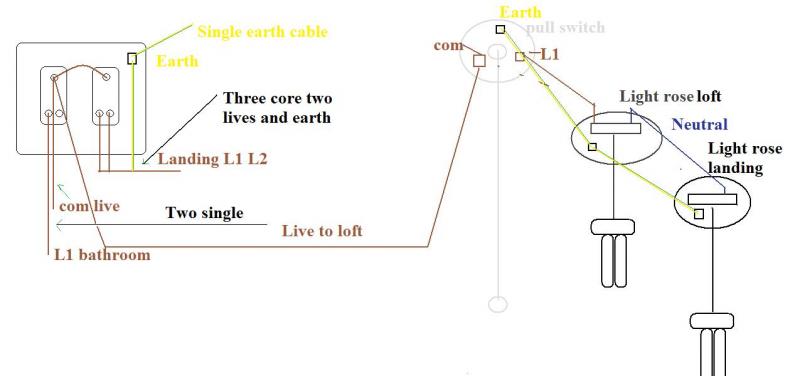

I finished wiring a light for my loft and i was just wondering if this is ok. origanaly there were 4 wires going into my landing switch 2 single wires com & L1 1 double cable with two lives & earth for landing light L1 L2 & 1 Earth. I then came of one of the coms for a permanent live connection as ilustrated in my diagram
