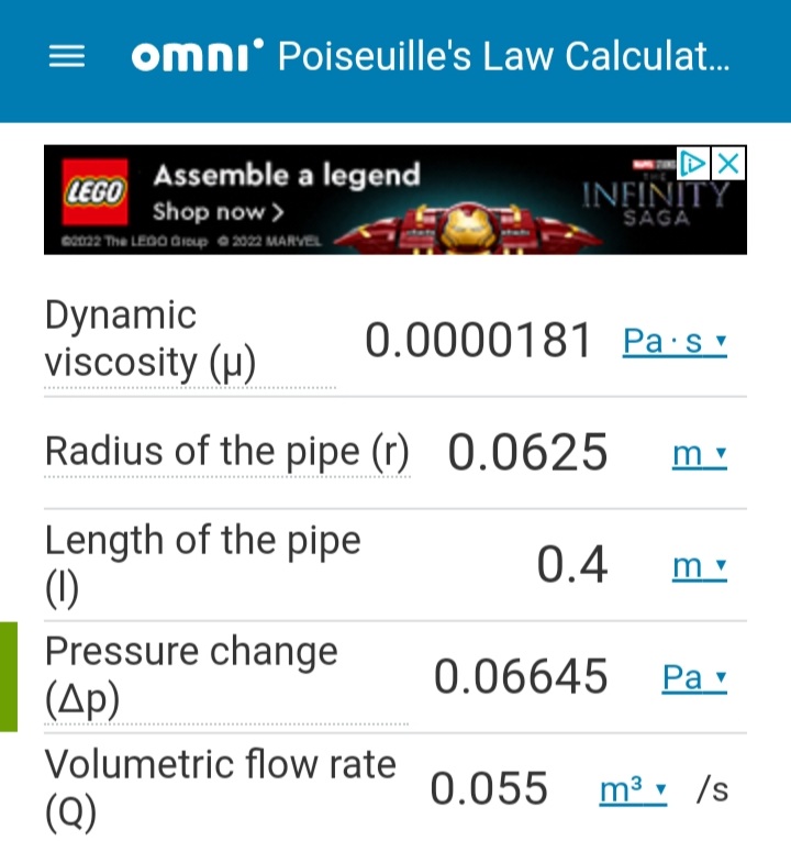

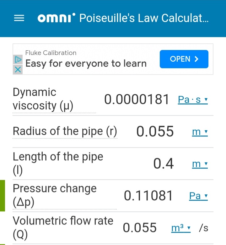

.... without any significant back pressure, flow rate in = flow rate out, accompanied by an increase in air velocity through the narrowed section - although there will also be added turbulence to the air flow.
... And here's an online calculator (some assumptions have been made - please correct me if I'm wrong! :) )...
I make that a pressure difference of only
0.044 Pa (4.4x10^-7 bar) between the two pipe diameters.

A 67% increase on a pressure differencial of 0.06 Pa, is still next to nothing...
