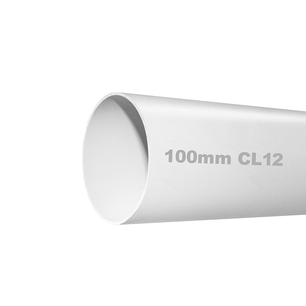

My question is, is there any sort of external extension which can be added to these, like a chimney type of arrangement, so that it vents either further up the wall, or runs horizontally to take it away from being opposite our door? I've googled to no avail.

Soil pipe is the same diameter and better for longer runs compared to flexible duct.

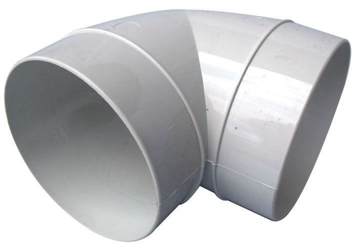

How about a 90degree bend and run up the wall?
I have worked out I need a longish run inside the house for the kitchen vent, So I decided on white pipe to carry it along the wall before venting out, the smoothness reduces the losses.
As it needs 5 corners due to a pier to navigate around I went for 6" duct. Pressure drop is proportional to radius to the 4th power, and corners have a big drop ~5 feet each for the 4-6 inch ducts.
