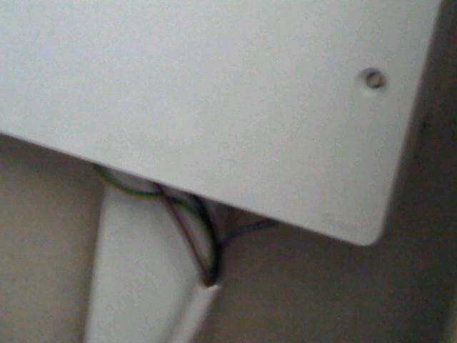

However, there still isn't any earthing on any electrics in the house or on the gas meter. We have been told that there's also a 'live' and exposed wire running down from the immersion heater tank into the kitchen underneath it to the boiler. Now, the estate agents have told us before that there isn't any 'safety standard' for electrics that have to be enforce like with gas because certificates aren't required. All the landlord has done to address the earthing problem is to replace the light fittings with plastic single bulbs and left it like that, the house also needs rewiring.

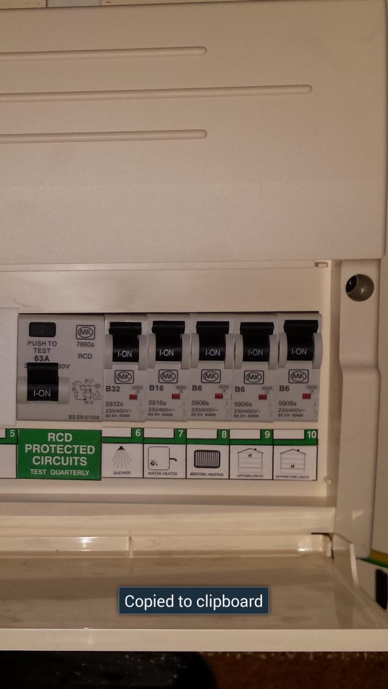

On the electric report, there's a tick/cross section for "Bathroom/shower room supplementary bonding" and "hot & cold pipes", "shower circuit", "radiator pipes" and "lighting circuit" all have crosses next to them - which hasn't been rectified other than fitting the plastic lights in.

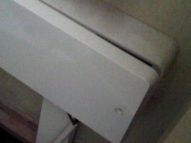

P.S. There's also an exposed wire leading from a 'pump' by the immersion tank to the boiler, I'll upload pictures so you can see.
This will most probably have been rectified or nullified by the fitting of a board with RCD protection of all the circuits which will, with a couple of other conditions, mean that the bonding is no longer a necessity.
So that may remove one of your worries.
Please do.
Please do.
Hope the images are uploaded right, this forum is all new and confusing to me at the minute.
So basically, in your opinion with knowledge of electrics, the shower may be safe? We haven't used it in a few months because we heard the unit making unusual noises and when the landlord inspected it, he claimed he didn't hear anything but it made the noise still after he left. We could be too paranoid about it, but the bad experience with the electrics and gas in this house has made us wary of it. [/img]
I put it in two pictures so you guys can actually see the labelling clearly. Hope this helps? :)

The shower is 8.5kW. :)
