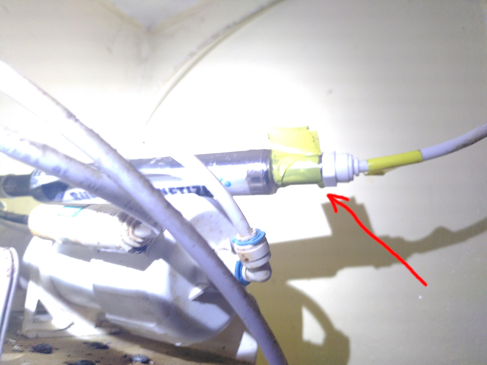

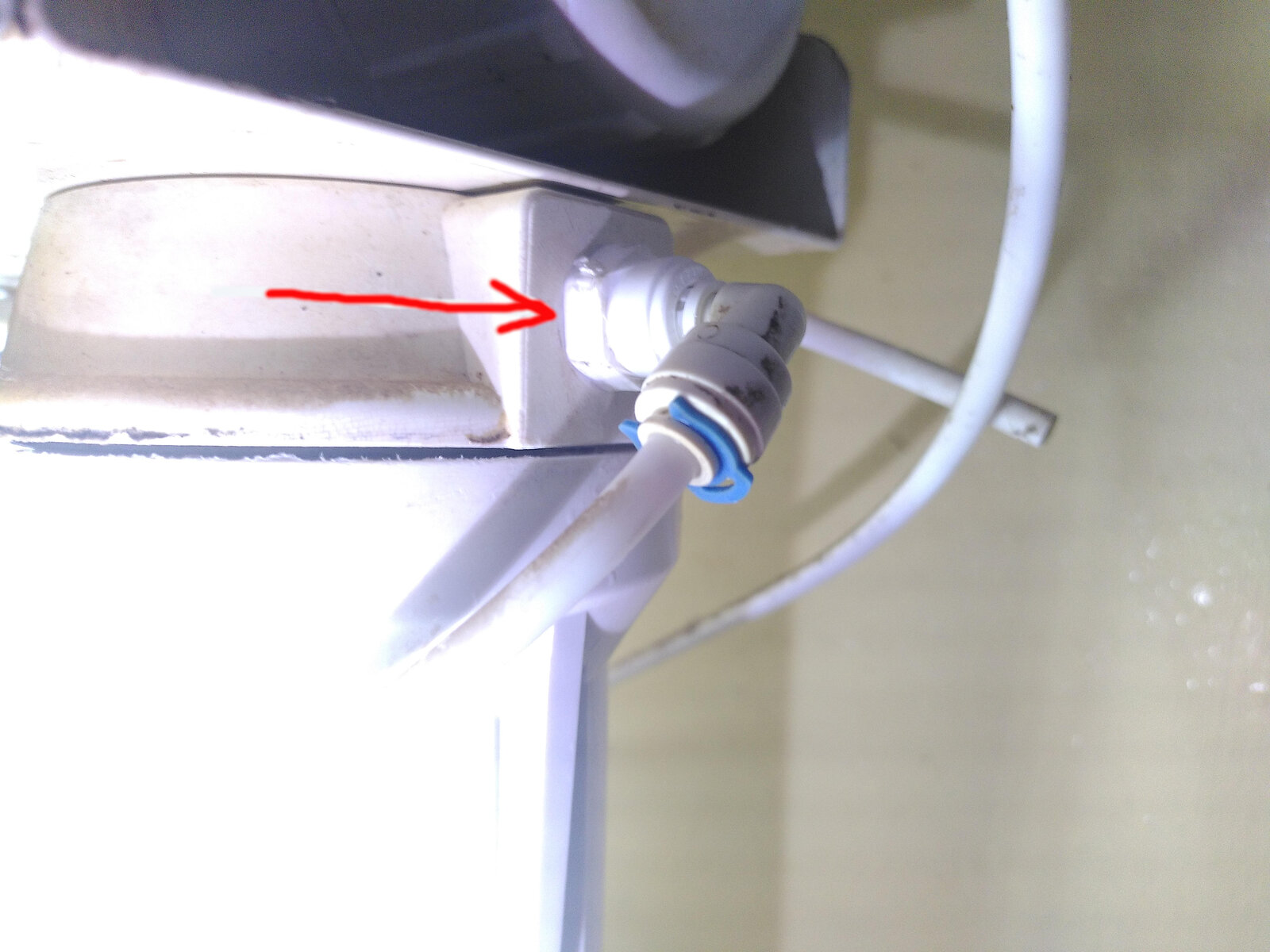

I replaced the filters on my RO water filter and the system has sprung two leaks. Both are from the 1/4" thread connector on the pieces of the filter they connect.
One is a plastic filter housing and I've tried it with and without PTFE. The other is on a magnetizer unit which is metal. I've also tried PTFE tape on the thread, but no joy. I've tightened them up as much as I dare, and they look to be fully screwed in.
Any tips? I'm a bit of newbie to this and only do the filters once a year at best, so i have serious little experience to draw on.

How many turns of PTFE are you wrapping around the threads,you may need more.
Well, more than one or two. Maybe five or six? I'll give it a try with 10 or so. I was worried they'd just stop it screwing in.
