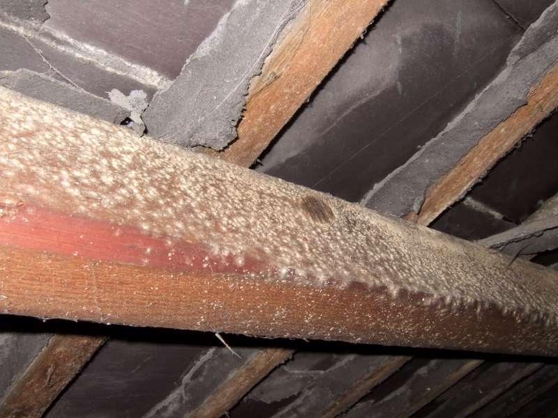

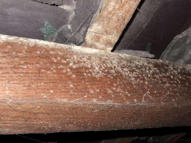

Hi, I recently moved into an 85 year old house that turned out to have 'White Spot Mould' on the rafters. At first I thought it was Wet Rot from looking at pictures on google, but on inspection by a reputable company I was told it was white spot mould. The rafters are a little soft but on prodding with a screwdriver it appears to be very superficial. I can only prod in by about 1mm.
I blame the loft hatch as it appears to be the loft hatch side of the loft that is affected the most, and I've seen lots of condensation building up on the tiles after we've had the heating on high.
The company we had take a look quoted £350 to treat the mould and said we need need to be out of the house for one hour while they treat. This seems a bit overkill, but I do want to sort the mould out and protect the rafters.

lofts are normally kept dry by ventilation, and by preventing warm moist air from rising up there.
Check the eaves are not blocked by insulation, most old rooves are quite draughty so should be OK.
Check that you loft water tanks have covers on them and are not warm and that hot water does not come out of the vent pipes
Look for cracks or holes in ceilings (e.g. round pipes and light fittings) allowing warm air to leak up, especially from the bathroom, and especially if an extractor fan is not used in the bathroom
Draught proof the loft hatch
If you are in the habit of draping wet washing and towels about the house, or over radiators, your house will always be damp and will not be cured unless you change.
Having dealt with the damp which encourages and permits rot and mould, it will stop growing and chemical treatment should not be necessary unless you want to.
It is more usual to treat timbers with a timber preservative than with bleach or household cleaners. I use Cuprinol Green which is the best-known. I am told that Wickes own-brand is similar and cheaper. You will need plastic (not rubber) gloves, and protective mask, goggles, hat, overalls etc.
Sounds like it is the residual effect of somebody treating the roof previously with either a fungicide or insectcide.
This is quite a common problem but to be on the safe side check with the previous owners for any records pertaining to works in the roof.
Dont spend money on having it treated complete waste of time.
Thanks for that, looks like treatment is a complete waste of time in this particular case. I must have spoken to loads of people now who have said that this will just go away once the source of the condensation on the tiles is sorted out. Below is what it looks like.
