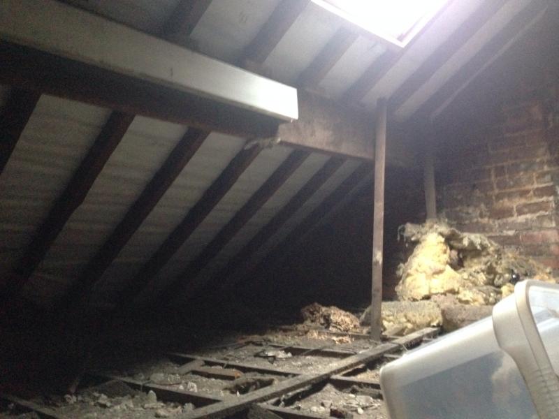

I have attached a few images but bascially they had a new roof put on a few years back and the guy that did it must have been dodgy.
We had British Gas round to fit insulation as there is none and he said he couldn't do it as half the loft has no timbers (like strut things) i know nothing about loft structures and tried searching endlessly online to no avail?
Anyone any ideas what this needs doing as i want the insulation in ASAP.
Thanks so much
3 Dec 2014
7
First 2 pics are the side of the loft that seems ok and other 3 are the side that the guy said needs sorting before he comes back? :(

Well you must be able to see what is missing go and buy some roofing batons an fix them in place, measure first if you only have a car and cut them at the timber yard.

Thanks Catlad, i'll do that and get it sorted but i just wanted to check it was as easy as that? Do you know what the purpose of them are and why the insulator guy wouldn't have done the job without them?

They are not major structural items - they are only there to stop the ceiling bowing excessively when someone walks about up there or piles junk in.
As above, just get two or three pieces of 3x1 or 4x1. Nail them to the purlin at the top (that hefty piece of timber) and to the nearest convenient ceiling joist at the bottom.

Thanks so much Tony1851! I'll get some this weekend and ask my husband to fix them in.
