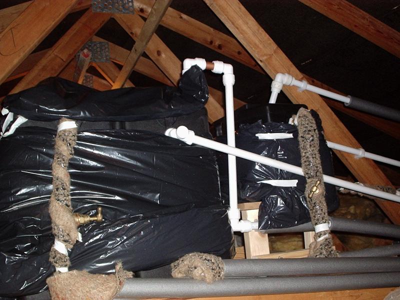

Hello again.
I've created an album called "Tanks and Pipes" which hopefully will show you all you need to see. I've numbered the pictures so that they are in order from the tanks down to the shower but am not sure if they will appear in the correct order in the album.
There aren't any air bubbles mixed in the water and I'm not really sure but think that the shower heats the water up. I'm pretty sure that it uses mains water.
this one
shows that you have a cold water tank, and the smaller one is the feed & Expansion tank for your boiler and heating system, which is a vented one

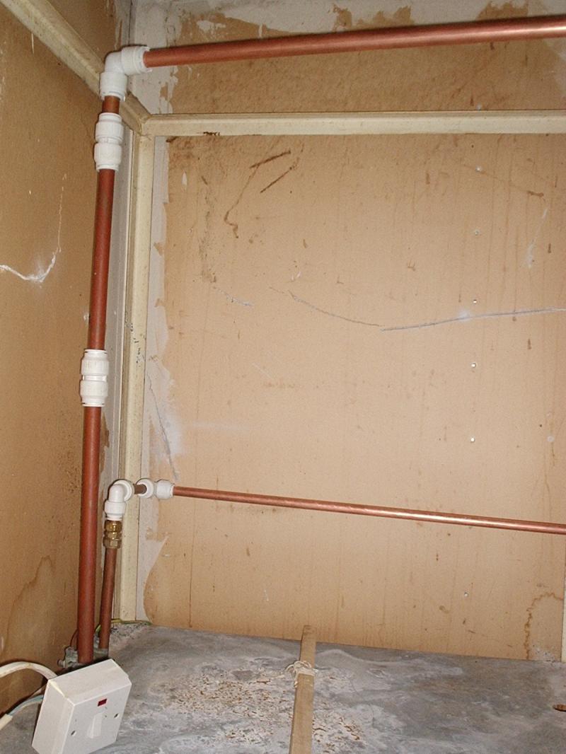

in this one
it looks like the copper pipe with the stop-cock on it feeds the cold mains to your water tank in the loft, and has a branch going sideways to the right, which maybe goes to your shower
did you formerly have a hot water cylinder in here, and has it been removed? Is there a hot cylinder somewhere else now?

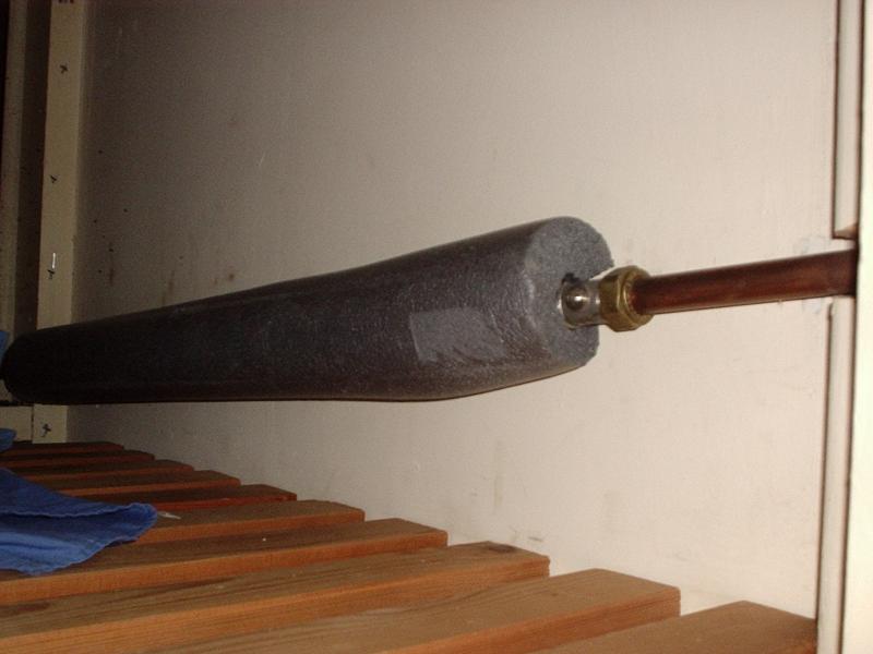

if this one goes to your shower, the chrome fitting on the copper pipe, peeping out of the insulation, looks like a service Valve. this should have a screw head on it which is used to cut off the water supply, and, if partly closed, will restrict flow. Have a look at the screw head, and see if the slot is in line with the pipe.

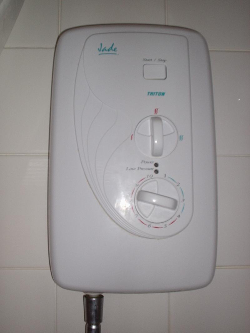

and this looks like an electric shower, which has a heating element inside.
it does not look like what we call a power shower, which is one that has a pump to squirt out stored hot water at great pressure. An electric shower should have a large electrical switch, probably a ceiling-mounted one with a pull cord. It will be much bigger than a light switch.

I've checked and the slot on the service valve is in line with the copper pipe to the shower. This pipe is also absolutely freezing cold when I've got the shower on and the water is running through it so I guess it must be coming off the mains?

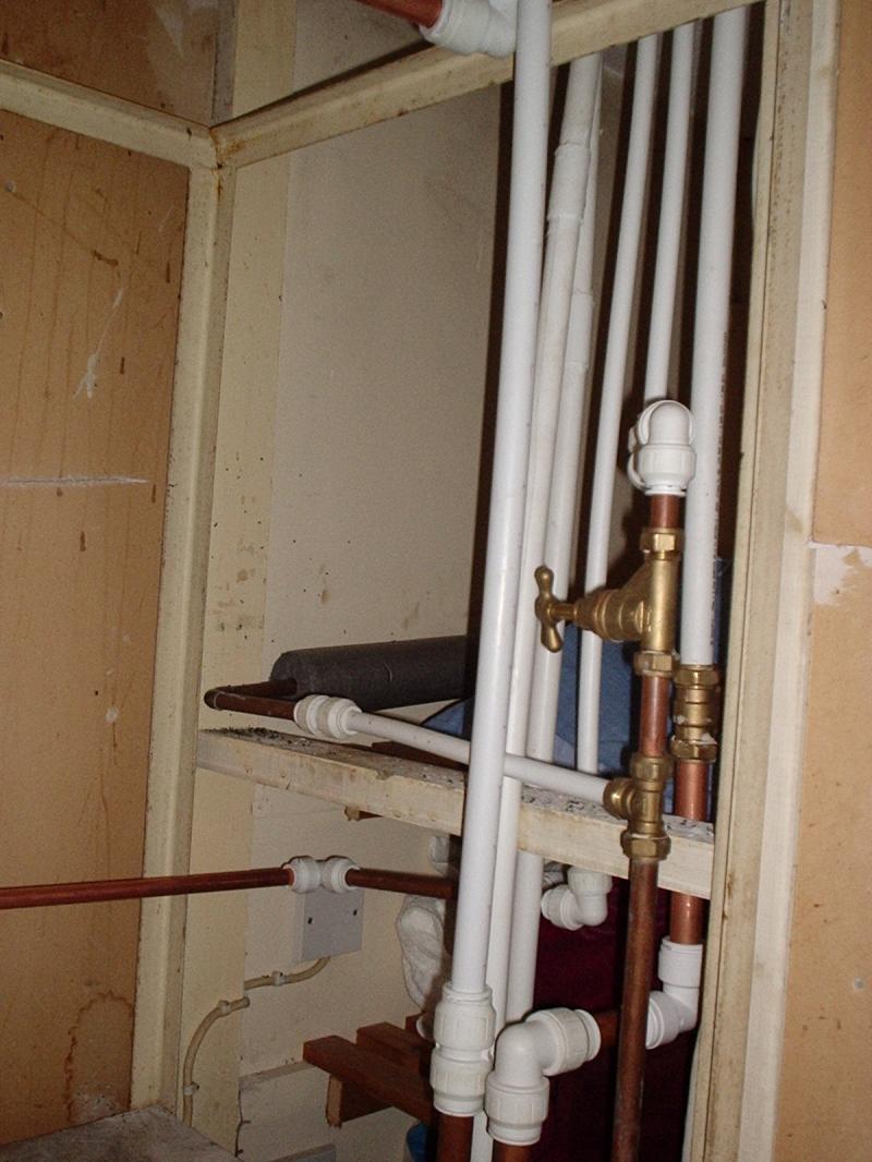

Follow the cold water main, and observe all the stop cocks and valves you can find. It might be that the plumber turned down the main stopcock to make the water tank fill more quietly, but there are better ways to do it. you may need a thick leather glove to grip any valves and open them wide (a tip: always turn back valves half a turn from fully open this reduces the risk they will seize).
You are particularly looking for stop cocks, note the unique shape.
