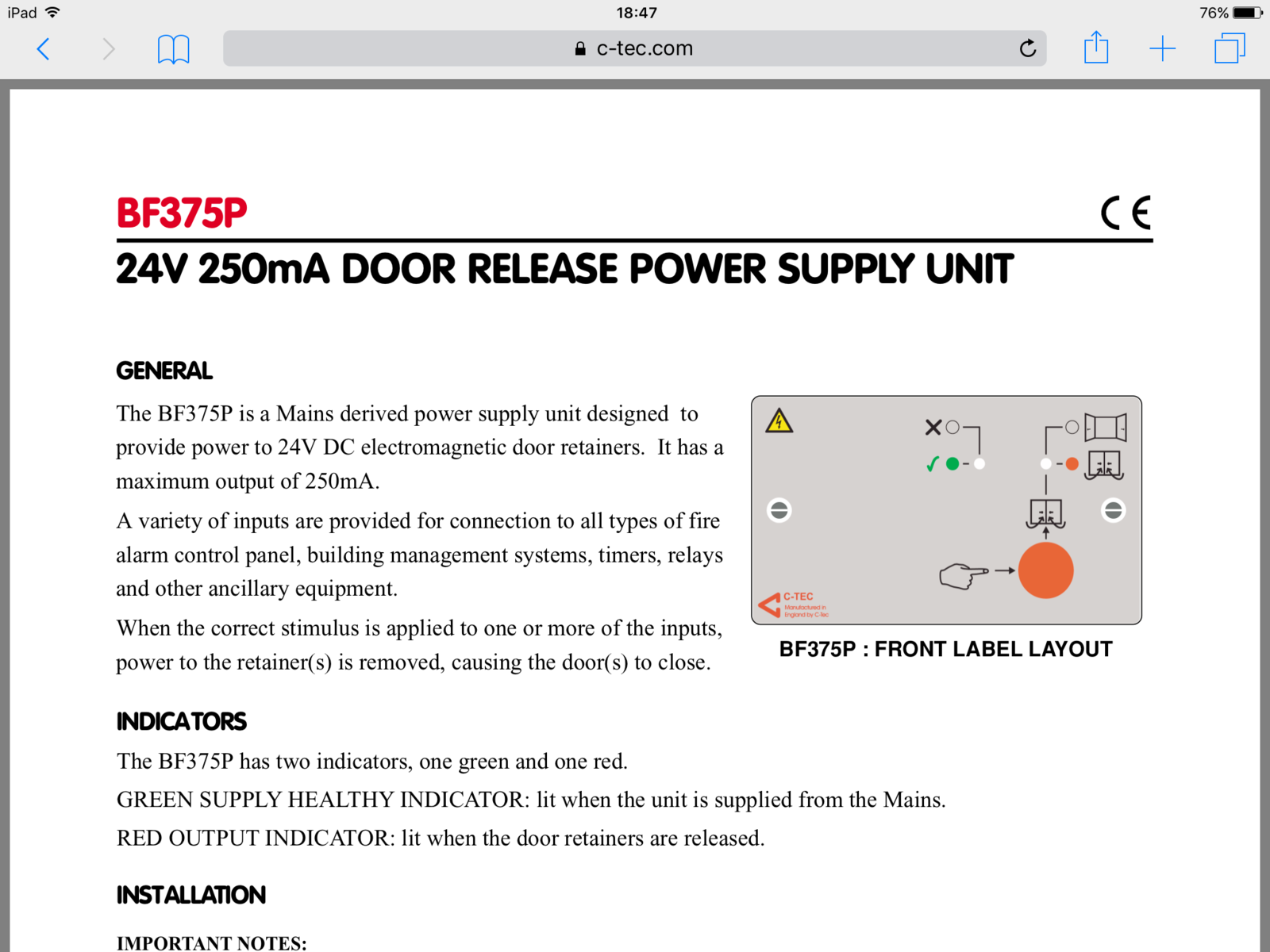

    IMG_1716.PNG Fitted a few of these on systems requiring door closers as a afterthought
    Bit more flexibility on these if your panel does not have a relay only a switched output , can power 5 retainers and has a manual release button on the front
    Made by C-Tec
