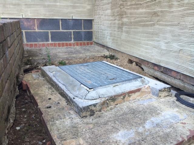

Hello everyone, pleased to meet you. My first post on the forum and looking for some help. I'm laying a new patio behind my house but there is a manhole cover just a few inches from the back wall of the property (see image). Everything I've read suggests that the patio should not be less than 150mm below the DPC, the manhole is level with the DPC ! What are my best options ? Any help appreciated
