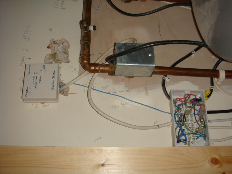

Thank you all for your help. The system was on a downstairs/upstairs originaly with Drayton Digistat RF2 and digistat SCR and another to controll the upstairs. As i say, the plumber himself took out the upstairs stat so i could get some heat on because it wasn't working. Another problem is that i sometimes ... allthrough rarely... the water will go cold. My plumber told me the water is suposed to be constantly heated and i shouldn't be getting cold water at all... again, not sure about this as i don't have a clue myself. I'm going to have to find someone once i get christmas out of the way.
I'll post some pictures out of curiosity so you can see what you think. Thanks very much again. Mark.

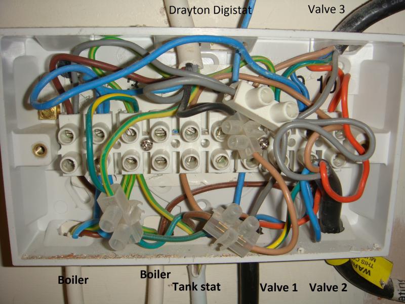

I'm assuming the "Tank stat" connection is the thermal cut-out of the Megaflo?
It is very important that this is wired in series with the DHW control circuit so the Megaflo doesn't boil if things go wrong.

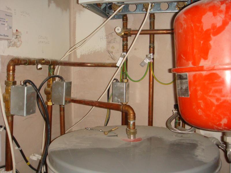

I haven't had time to take a proper look over the picture of the wiring centre yet, but I would suggest you employ the services of a much better electrician. That single insulated neutral between the wiring centre and the digistat (that looks to have been stripped from a piece of T+E) should not be there, and wouldn't be acceptable under any circumstances without being enclosed in conduit or trunking. Looks a bit of a lashup that is rather typical of builder's contractors, I'm afraid.
EDIT: Sadly it's a bit too difficult to follow the wiring in the pictures, due to the way everything has just been stuffed into the box. We can say for sure that you don't have any 3-port valves, though - all those in the picture are 2-port. As they are three of them, it suggests that it should indeed still be possible to get the system working as it was originally intended with multiple heating zones. You just need a more competent electrician.

That single insulated neutral between the wiring centre and the digistat (that looks to have been stripped from a piece of T+E) should not be there. Looks a bit of a lashup TBH
Well, i think that may of been the plumbers doing after the electrician failed to resolve the problems. The plumber and his mate were at it for ages just trying to get me some heat this time last year. It was supposed to be tempory :)

Hi Snoot, I live in Bishop Auckland, I would be happy to lend a hand in sorting this for you, recently wired a system in a house, 3 x port valves and 3 stats..David
Do I see only 1 wireless receiver, this must be 2 channel then to distinguish between up and downstairs or is there another receiver to connect in.
Just thinking out loud so guys please correct me....
so the boiler has a permanent 240v feed
There are 3 x 2 way port valves, 2 x wireless stats and a cylinder stat
one valve is downstairs, one is upstairs and the other is feed to tank hotwater
all 3 orange wires from the 3 port valves are joined together and go in with the feed into the boiler which calls for demand and ignites the flame
all greys together too and they get a pernament live feed
So one wireless stat needs wired to its correct valve for down stairs
and one for upstairs
and one for hotwater
So the switched live return (call for heat) from say the down stat goes to the brown for the correct port valve for downstairs plumbing circuit
same for upstairs
and same for hotwater
Then simply when any stat calls for heat, valve is opened and supply is given to boiler for it to ignite, if all 3 stats call for heat then all 3 valves will be open an pumped hotwater is shared between them until each stat reached set temp and then they stop calling for heat thus closing the valve and well thats it
See OP. Due to the system never working as advertised, it has apparently been converted to run as a single heating zone from one stat.
Presumably, judging by the fact that there look to be two flexes going to it.
Only one stat right now.
Presumably.
Again, presumably, although if this were all wired correct then you would expect it to be working, unless it's not the wiring at fault.
same for upstairs
Sounds reasonable, although I'm not sure how the HW stat is working in this installation - I'm not familiar with Drayton's range of RF stats, or any RF stats at all for that matter as I consider them a poor solution to a problem that doesn't really exist.
That aside, I assume one of these RF units must be a combined timer/programmer to control the hot water, as it wouldn't want to be permanently controlled by a cylinder stat alone. Depending on whether or not the upstairs RF stat also contained a timer (back when it was wired in) will also have some bearing on the situation, as if it doesn't contain a timer, it will need to come on/off with the main CH programmer output. You'd need to look at the documentation for the Drayton products in question.
any good guys?
That's the jist of it.
