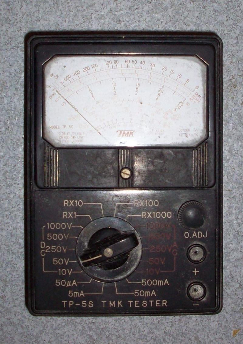

I still like to carry an old fashioned moving needle low impedance meter.
Very sensible - and, as I've mentioned before, I still even keep my 'old faithfuls' (with the emphasis on the 'old' - I've had both of these for ~50 years!) in my drawer:
Mind you, in the context we're talking about, one still probably has to use a fairly lowish voltage range to 'completely kill' many of these voltages due to stray capacitive coupling. Many such meters, like the AVO above, were about what used to be described as "10 kΩ/V" (reflecting the underlying 100 μA meter movement), meaning that on the 250V range it would have an input impedance of about 2.5 MΩ. The second meter above has a 50 μA movement and therefore is probably about 5 MΩ on its 250V range.
