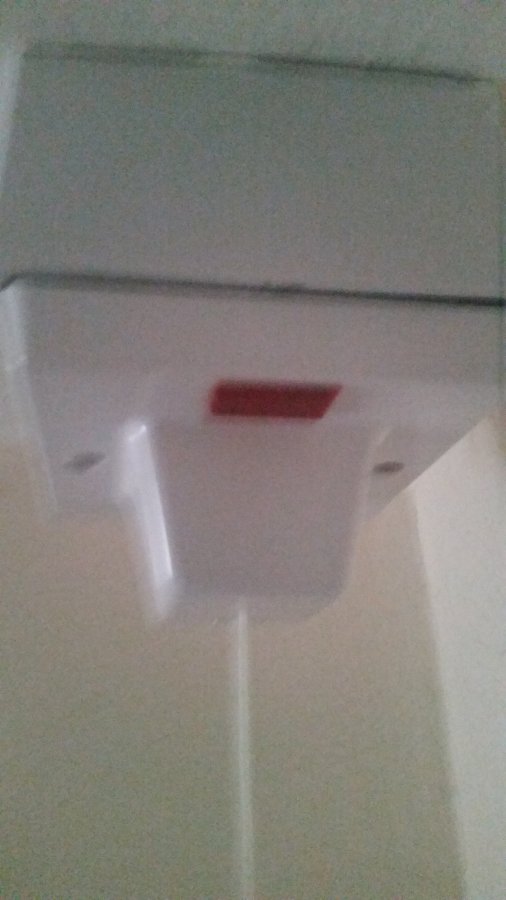

My electric show has stop working yesterday I don't get any power from pull cord shown below. I have turn switch board in CU on and off still no power to electric shower. Light in bathroom work fine any solution also a newbie thanks in advance

I would suspect a broken switch.
Does it feel 'normal' or is it stiff/hard when you pull the cord?

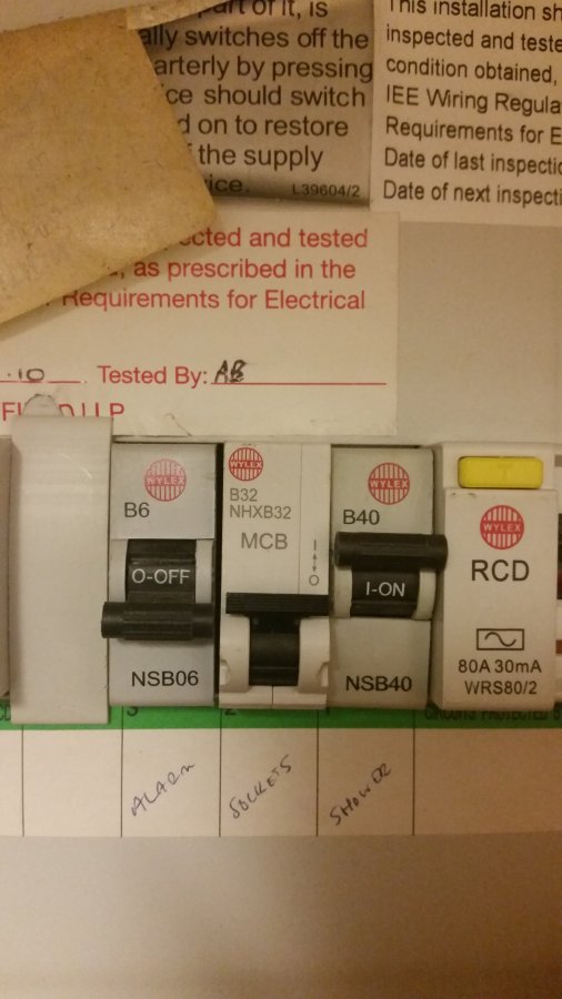

Is there an RCD in the consumer unit? (larger device with a test button, may be more than 1). If so, is any other device powered by that RCD working?
Does the red light in that switch come on and go off when you pull the cord? (If yes then problem is probably not the switch)

I have checked the RCD box switch it off and on by press the yellow button. Sockets are working fine from the same RCD box. Also a small red light comes on just for second on the switch when i turn it on.I have upload picture with below how my RCD box looks like
The switch is damaged, or one of the wires to it is loose - which usually means the switch has been damaged anyway.
New switch required.

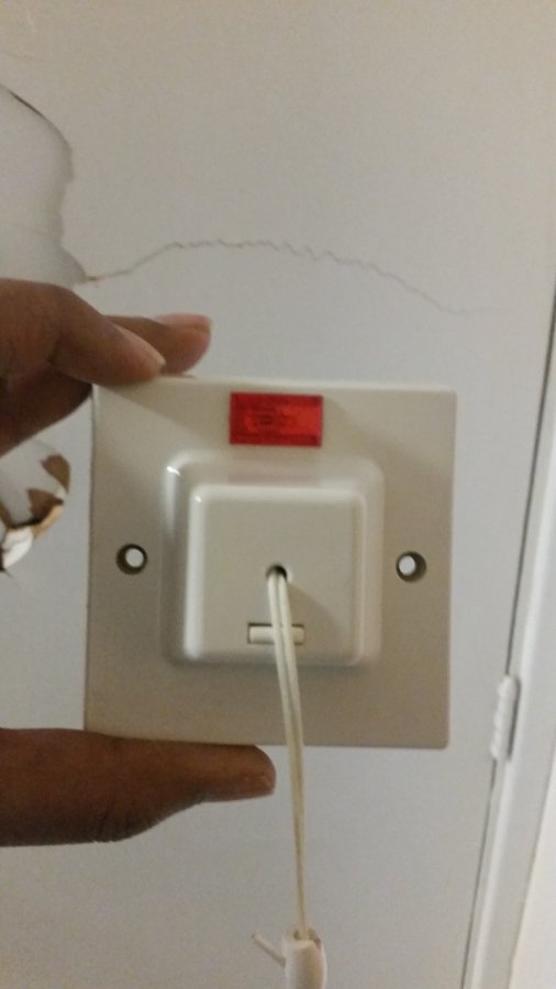

Just taken off the switch where is the best place to but replacement one ?

Yep, new switch time. Is the place rented or do you own it? (If rented, landlords problem)
Screwfix or Toolstation, get yourself a good screwdriver and a multimeter while you're there (unless you already own them(
