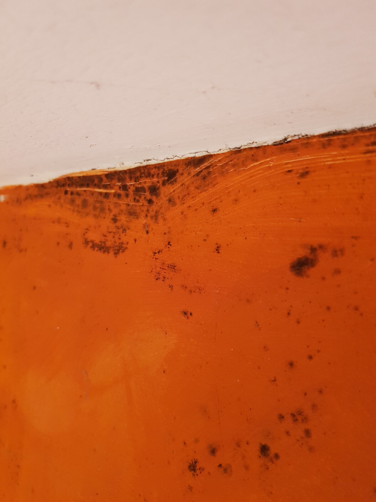

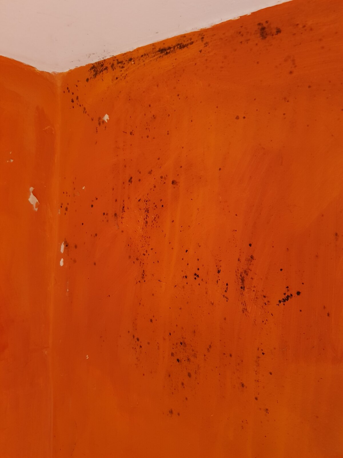

    Hi
    I have a problem with damp on a bathroom wall. It's an internal south facing wall so gets the brunt of Winter weather.
    Can anyone suggest the best process, and materials needed to sort this problem ?
    Finished, it will be painted again.
    Thanks in advance.

    There are a couple of black mould treatments available in hardware shops (HG springs to mind). Alternatively a dilute bleach solution. Wash off well and allow to dry out properly.
    presume there is a loft above the wall - make sure the loft insulation is complete and well fitted, no gaps and maybe add more over that room.
    make sure the extractor fan ducting is clear. That the fan has a long 'run on' time.

    I quite like it. That's a positive thing to post. Reminds me of a victorian ****oir. [Edit: how can that be a profanity? ]
    As above, bleach or other treatment. Then repaint it. Maybe do the walls and ceiling the same colour, or, get someone with a steady hand to do the cutting in.

    In answer to your question, as someone else suggested, HG Mould Spray (you may as well get the bathroom one) is excellent for shifting mould.
    I know the Lakeland shops do it.

    Does this get wet, and did this mould form this summer, or is it older?
    Insulating the walls always helps though - internal insulation with kingspan (or similar) boards and boarded over, or an insulated tilebacker board (marmox etc), will help reduce condensation on walls in bathrooms if the wall insulation is non-existent, or just very poor.
