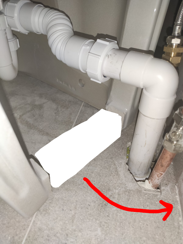

My builder has cut part of the base of my new WC and bidet

I don't understand why he cut that.
Are you sure it wasn't already like that?
Also, why did he use that flexi waste?
Because the unit has to be pushed back against the wall to its final location.
Supplies would have clashed with the ceramic bar and you use a flexi to make it easier to plumb up out of situ.
There's nothing in the way of that cut part, so no need to remove it.
A little planning would avoid using a flexi in the waste.

The flexi will be there to allow fitting then the bidet to be pushed back. Must agree though, if done properly then that waste pipe should be in the wall.
That brace was there for a reason (probably as a side support for when the fitting kit is tightened). As long as the bidet/pan is secured properly then it should be ok. As suggested though it should have been discussed first. Given he has altered them in such a way that I'd be asking for a guarantee written into the invoice.
Was he around as part of the intial design and first fix work? Did he get a proper plumber or is he just a builder, if the latter that'll be why it's been missed as part of the setting out.
Could still have been fixed, rather than cut the support out, as the pipework could still have been put into the wall, any cuts/void would be hidden by the bidet once fitted .... bit of a mug TBH.

Sorry but with proper planning there should be absolutely no need to cut any part of a ceramic toilet pan. All it does is compromise the casting.
There are some things that can be cut and there are some things that shouldn't ever need to be cut IMO.

There are plenty of pans and bidets out there without the moulded bar at the base. And are designed thus, to avoid clashing with first fix plumbing.
I would never expect to have to route a 4" pipe from the floor, up into and out of a wall, just in case the (usually yet-to-be-chosen) pan came with such a brace!

it's also clear that there are circumstances where it is impractical, without considerable expense, not to cut the porcelain
No there isn't. It's called proper planning and setting out that a good pro should always consider. There shouldn't be any instance where cutting a porcelain pan like that is needed ever. If the pipework cant move then that pan should never have been specc'd for that job the way the room's set out.... simples.
