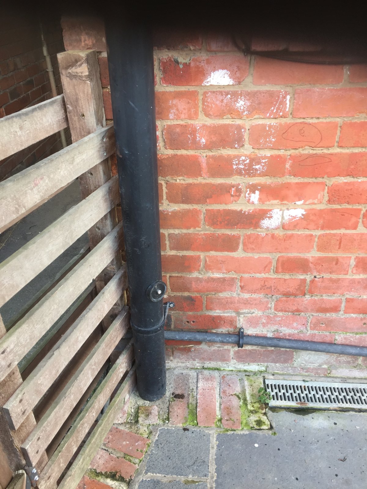

I have a damp patch on the corner of a house and am really struggling to understand where the water is coming from.
It starts right behind the soil stack which is right on the corner of the building. It spreads upwards and to the right, but there is no damp lower down as you move to the right (above the patio drain area. The photo isn't that clear but it is damp higher up on the right side as well).

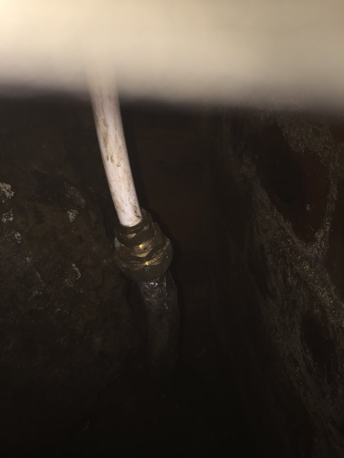

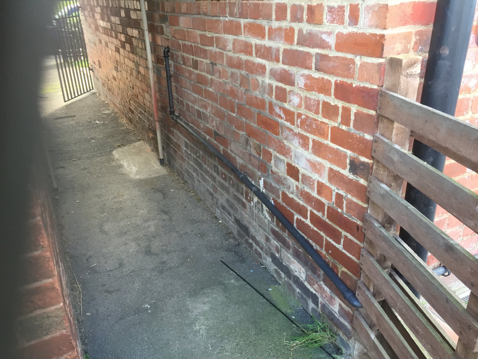

The lead water feed comes in through the alleyway and turns into the building right where this corner is. I have been under the floor today to check the pipe work down there and all is ok. The lead comes through the wall and then goes up and changes to plastic (i did this work 4 yrs ago). The void under the patio line is about 1m high in there.
The water company has been out to check the soil pipe and drain connection and all ok. The actual soil stack is just a vent. The toilet connects into the sewer directly underground. The photo of the lead water has the down pipe next to it, but it is encased in a rough concrete mix done when the house was built 1930's approx.

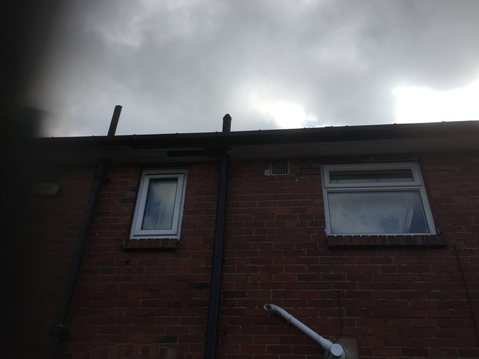

It is possible the flashing for the soil stack is faulty and so rain water tracks down the stack in heavy rain and the wall sucks up the water that way. The flashing was fitted 4 yrs ago and i think this was an issue hence the rotted weather boarding on the eaves.
The pointing on the house needs redoing. Could water be entering higher up via the pointing and tracking downwards ?
