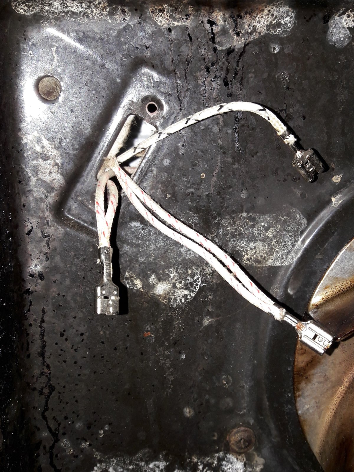

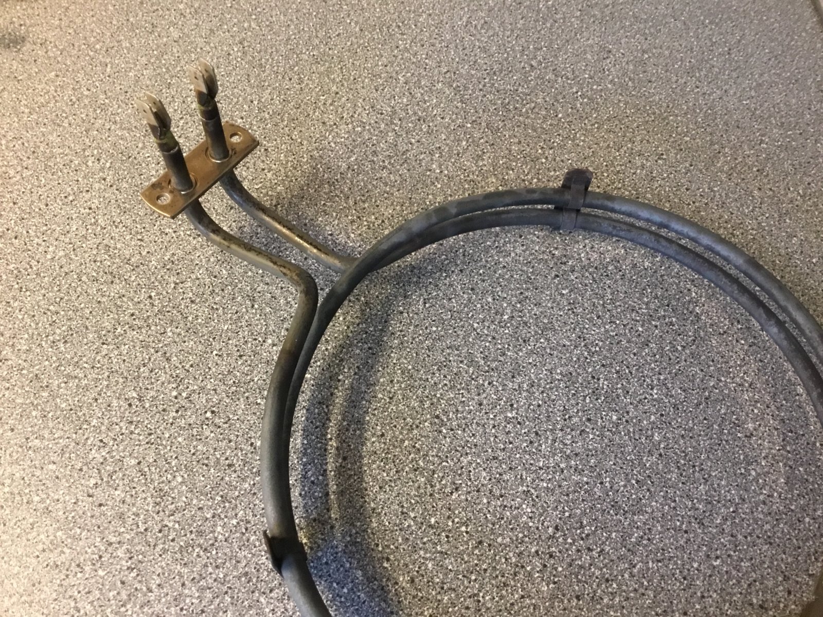

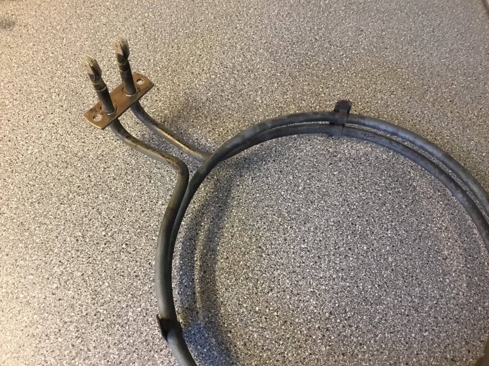

View attachment 161926 Hi, was a little over-keen and have removed all the terminals from a faulty element without marking them? As in the picture there are 3 wires all with white sleeve, but two with red flashing, and one with blue flashing. There are 4 terminals on the element two on each end. Can anyone please advise which goes where, as whilst I think I know which one went where, I am unsure as to the consequences of doing it incorrectly.

Looking at your rather dark pic. it appears you have only 2 connectors. One should attach to each side of the element not both to one side. It does not matter which goes to which.
Than you for your advice, most appreciated.

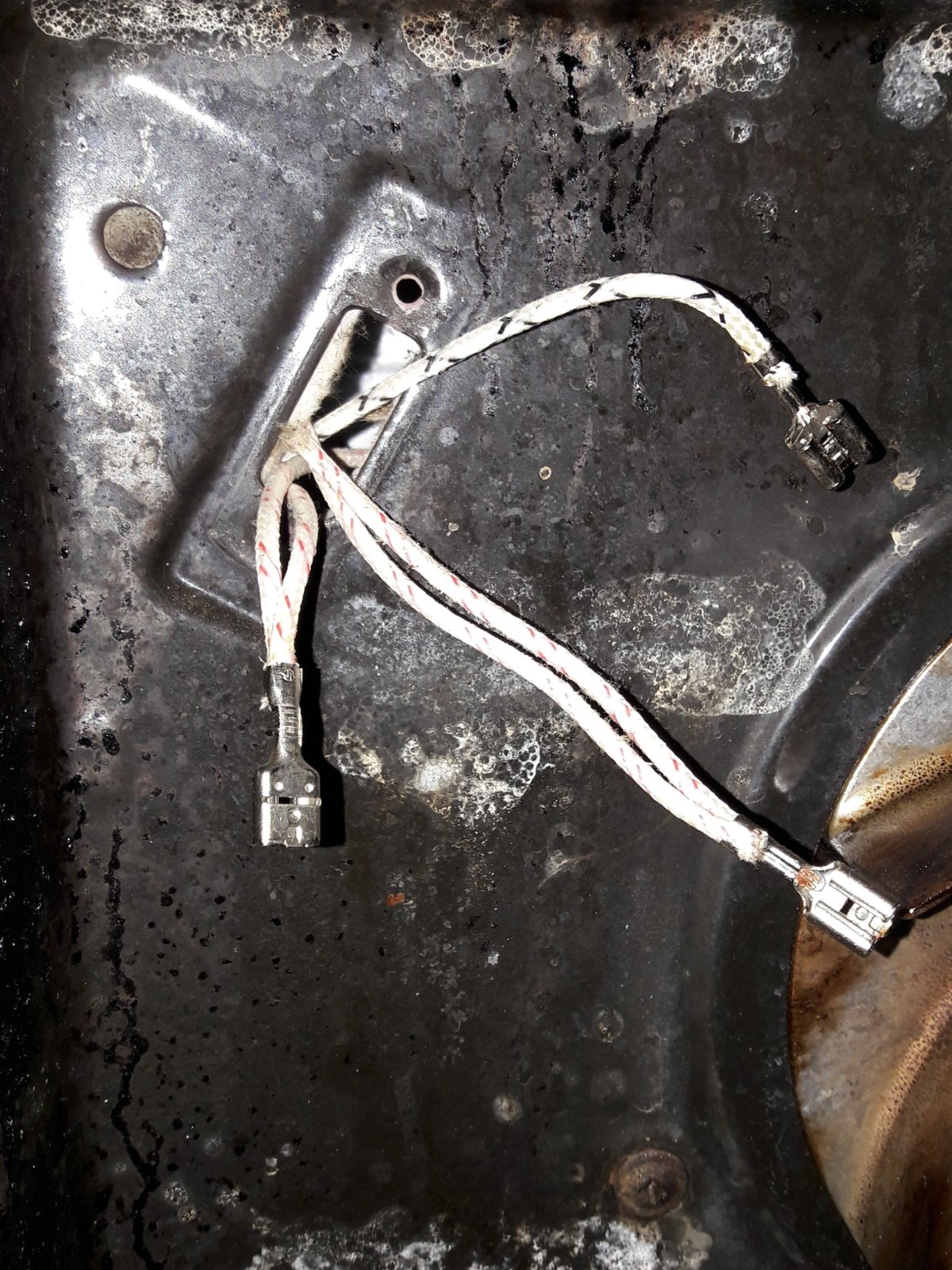

I’ve attached a better photo that will hopefully better show the situation
