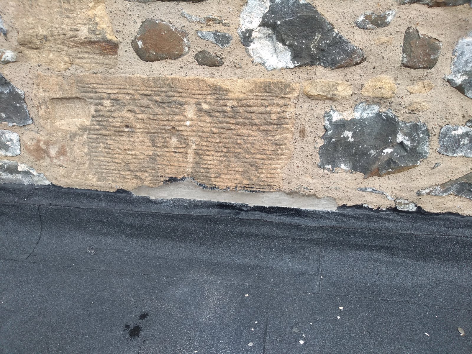

Morning all, hope you are well and staying sane in these crazy times. Sorry, below bit of a long story but wanted to include all the details.
I have had a new felt roof on flat roof of extension, which is built on to a 200 year old sandstone/whinstone house. Keep getting a leak on one section of the flashing (not sure if that's what you call it when its felt). Roofer came back out and replaced that section. He thought that it was getting in behind the joint due to crumbling parts of the stone so also dug some of this out and cemented in that section after replacing flashing and used CT1 in the joint between felt and stone.
However, it is still leaking. Its a small leak, and it takes a lot of water to get it to happen, and as its running down the old wall I wouldn't even know about it if I hadn't opened the ceiling inside to put insulation in (I saw a damp patch and checked with a hose to see if it was residual). Having said that, I don't want to fill a void with insulation where there is even a small amount of water coming in.
The roofer has offered to come out again and trying cutting in a bit further up, but not sure I want to just keep doing this and hoping for the best, I'd rather something more conclusive so that I can close up with confidence.
Once thought I had was to put a render fillet above the flashing tapering away from the stone and covering the felt. Not sure if this would work. Another was to cover where the leak is with a bitumen mastic or some other product where I could make a fillet that would push the water away towards the roof.

No window above. I've tested it pretty methodically with a hose to narrow down the area, and its either the joint or the felt. I've just trowelled on some bitumen mastic in the area I've narrowed it down to and I am going to test it again with the hose on the same area. I think bitumen mastic is waterproof more or less instantly.

Yes, a raggle was cut and felt run into masonry. On the second attempt he raked out the stones above the raggle in case it was getting behind and cemented in above the raggle, the fillet that can be seen in photo.

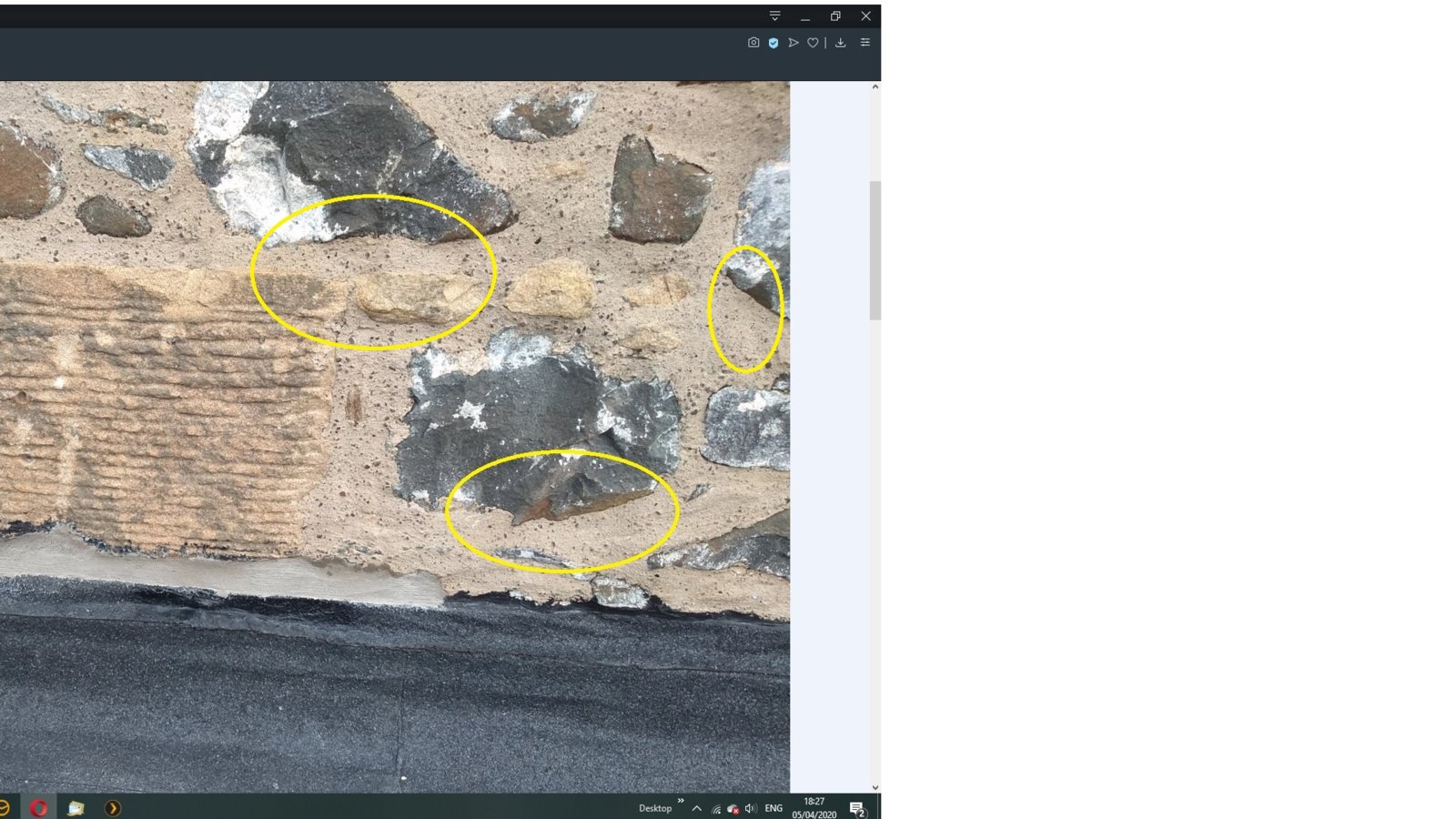

However, I'd be suspicious of the pointing around the stones
I was too initially, but I brought the hose down to a few inches above the raggle and was still getting the leak.

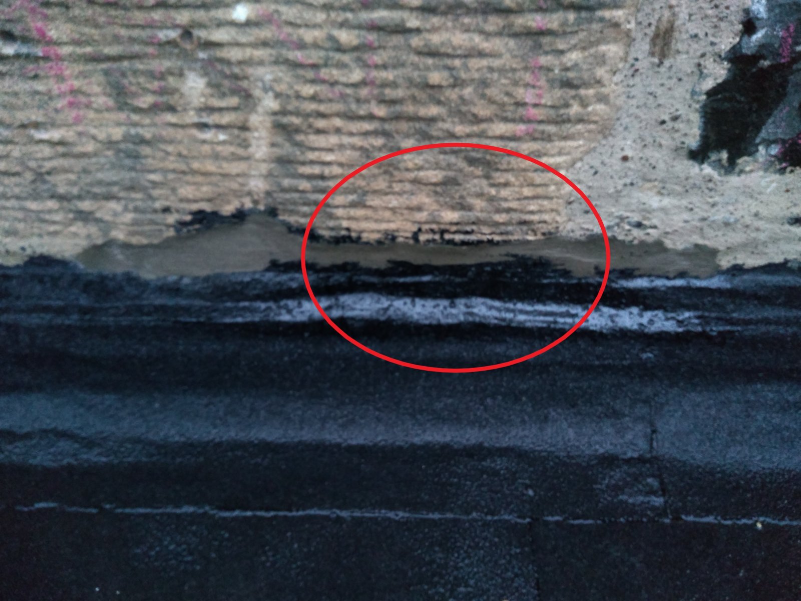

I have been concentrating the water on the area in the red circle, and in this photo you can see the bitumen mastic I added. However hosing again tonight after the mastic was added it was still leaking. When I lowered the hose so the water wasn't going any higher than the mastic I got no leak, so maybe I will try some bitumen paint over the cement to seal that area and try again tomorrow.
This morning I painted a thick coat of bitumen paint overlapping the raggle joint to about 100mm above, covering to just above the cement fillet in the pic.
Early this afternoon I rigged up the hose pointing at the position where I was getting the leak before, and ran for about 30-40 minutes and no leak. I will probably give it another hosing over the whole area later just to be sure, but that appears to be the leak fixed now.

As it stands there is still a small leak there. I am utterly baffled by this. There was a definite leak on the raggle before he put the cement fillet in above it, but even if that leak was still there I highly doubt that water is passing through a visibly continuous layer of bitumen. I've also pressed all weather sealant into any points in the mortar where it doesn't look completely continuous with the wall.
I am starting to wonder now if the mortar pointing is shallow and there is a void behind there. Maybe the raggle crossed this point and was a weak point, but it might be coming in at other points too. The thing is that there are no obvious gaps, and I am now wondering whether the small leak that remains is water passing directly through the lime mortar, which will be porous, but would it be so porous that water would pass through within 30 minutes of spraying?
