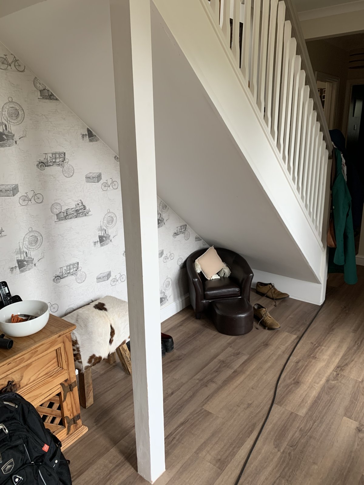

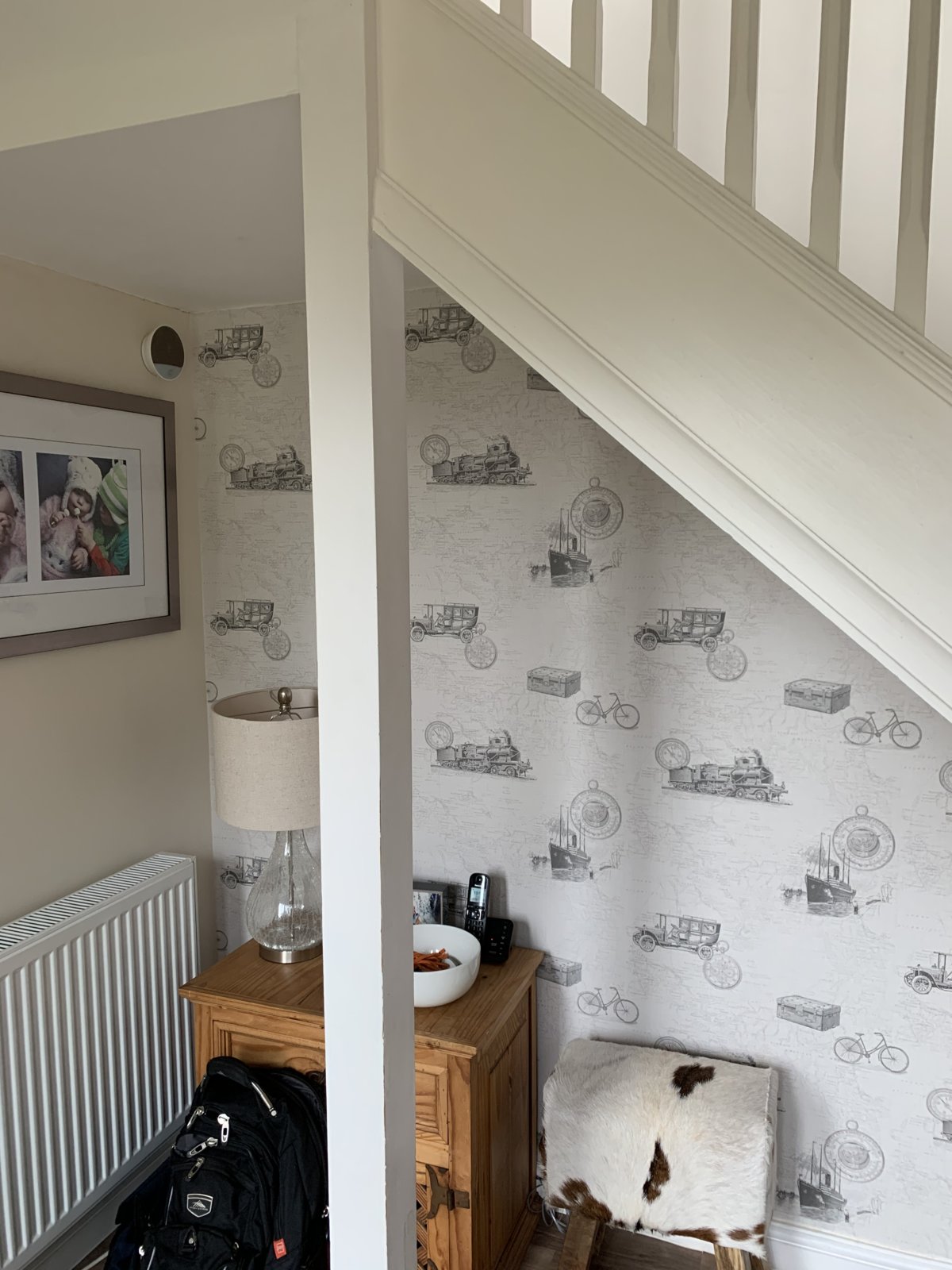

Hi I’m new to this but I’ve got this eye sore newel in the middle of the hallway. Can I cut it short or is it structural?
I would leave that one alone myself. Apart from support people pulling on the bannisters will cause the upper newel post to move.
