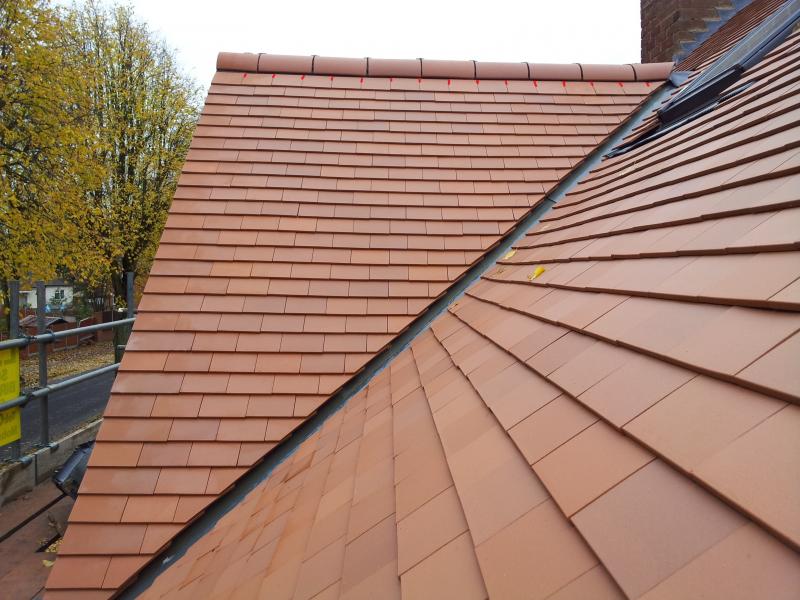

hi there
a roofer has installed tyvek supro breathable membrane on my semi detached house. he has then tiled it with clay ACME tiles. on the apex ridge at the front of the house he has not put any top tiles at the top and has just layed the ridge tiles on. i have looked on the inside and there lookes like a 1inch gap between the tiles at the top where i can see through the membrane where the sunlight shines. is this right and will any water come into the house
thanks for your help
So am i right in saying to ask him to fix it by putting top course on. is there any other way or shall u tell him tommorow
That's bizarre. As Alistair says, its a nice looking job, but WTF has gone on with that missing row?
Its straight forward enough to remove the dry ridge, he may have to drop the last couple of battens down to accommodate the last course.
I'm just finding it strange why he would leave such a tidy job then leave out the top course of tiles.
Has he left them out of the main roof?
