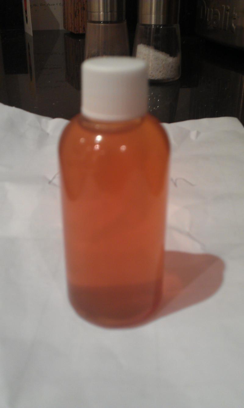

4 bed detached house. Had a chemical flush, new vaillant boiler, manga clean & inhibitor fitted. August 2011. System is pressurised, new cylinder in loft, boiler not combi, rads downstairs on micro bore. Some rads cool at bottom. Boiler now noisy. 4 (3 by vaillant engineers) attempts made to resolve noise by resetting gas ratios. Noise has changed but remains, intermittent howling type noise, seems worse in bedroom above boiler. Latest engineer drained off small amount of water and stated unexceptable quality n power flush required. Also said he could hear slight kettling noise, not mentioned by previous 3 engineers. Ratio set to 7.1%. What I am concerned about is that if I have a power flush what guarantee is there that the water quality issues will not return as I have only treated the symptoms? The water was clear on installation of new boiler. Boiler was serviced at 12 months, manga clean practically clean. Also, if flush has no impact on the noise isn't it a waste of money? Is there any cheaper action I can take to prove if the water is acceptable? Would appreciate views on what to do next.

In your case the colour of the water will demonstrate the condition! What colour is it?

It's looks as if it is clear of any particles, but the colour isn't just inhibitor, there is something else in it as well. but that does not tell you what is trapped in the heat exchanger.
It would seem that the chemical treatment may not have been completed properly!
As a cheap and simply try, then I would drain and flush twice and then add X100 inhibitor and set the CO² to about 8.8-9.2 and see how it behaves then.

That reddish colour can indicate newly oxidised iron and may result from a leak in the system or a leaking filling valve.

Could a rusting radiator be the source of the rust in the water?. The filling valve is new, we r not aware of any leaks. Pressure remains constant according to valve on expansion vessel.
