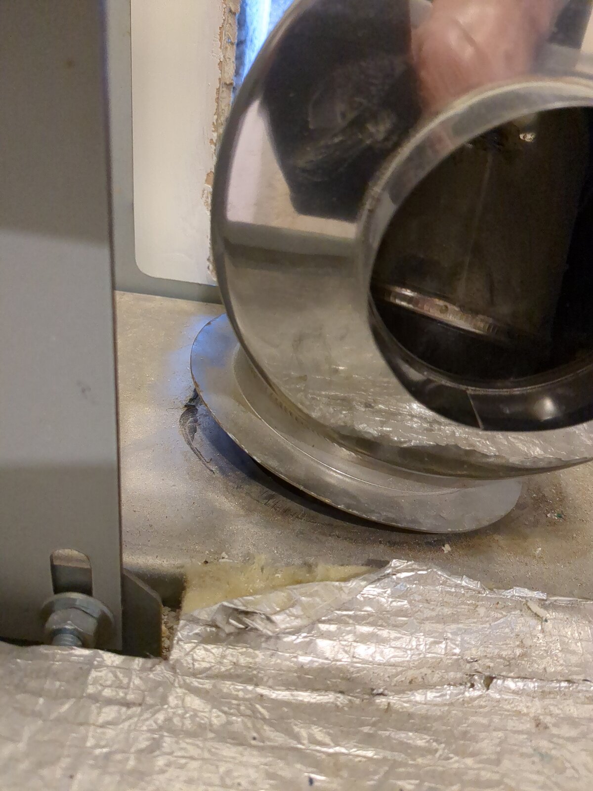

Is it good practise to put a bead of silicone (high temp?) where the glue connects to top of oil boiler? Thanks

If necessary improve the seal with some fire cement - or you could use automative exhaust Gun Gum. You didn't say whether your oil boiler is a condensing type. If it is, you may get away with silicone but, if it isn't, you definitely shouldn't use silicone - even high temp stuff won't stand the heat from a non-condensing oil boiler flue.
That looks like a Grant boiler/flue as I said above no need for any sort of extra sealant the factory fitted gasket all that's required.
We are Grant registered installer's and have fitted hundreds!
Thanks both. It is indeed a Grant
Next question..... the rope seal where burner fits into hole - what's different about a Grant part for 30 quid, and a peice you'd use on a word burner - prob a fiver max??
We would always use the correct manufacturers part especially as it's part of the room sealing of the appliance.
Up to you is a 20 pound note worth the risk?
Since the consquence of a leaking flue is carbon monoxide escape into the room, which can kill the inhabitants, I would always use the best components I can get my hands on, and not try to economise.
