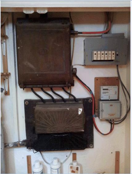

Good morning all, i have an old GEC fusebox in the living space of my flat and was wondering if its my responsibility or the Electricity Boards responsibility to remove/modernise. It looks as if it feeds the other flats upstairs.....and is probably filled to the brim with asbestos given how old it looks. any advice highly appreciated!

Don't touch it and the asbestos will be fine.(If it's DNO property then you shouldn't anyway) Try your luck with the DNO but if there is nothing immediately wrong with it then it will stay unless you want to part with ££££'s

I would guess it's down to history? I was working on a group of buildings and this was what I was faced with. I was just too big to reach them could only take a photo and I had to add a RCD elsewhere with a new earth rod.
It does not really matter why but where one can't access equipment one can't service it, and getting the DNO to visit at the same time as an electrician so their equipment and your equipment can be up graded at the same time can be hard.
Clearly the power to the other flats would also need turning off so likely it would mean each tenant plus an electrician plus the DNO all arriving at the same time.
You don't have RCD protection and clearly it would be nice to add that but only you can decide if it's worth the cost to upgrade. At the moment from what I can see replacing the consumer unit would be easy as there is a big main switch to turn it off. Although not sure what other tenants would say! However if they all rang the DNO complaining of no power I suppose they would have to do something about moving it all.

Generally because the building undergoes a change of use but the owner doesn't know of the need or want to pay for, the necessary alterations to the internal wiring or the supply arrangements.
From our side we keep coming across these and have to try to modernise them, but getting owners to pay for their own electrician is usually impossible.
Generally they are not unsafe enough for us to force the issue so we have no powers to do anything about them!

That fusebox, or something near it looks to have had a moment! Seems warped at the top and the area is blackened :D

Your Service fuse block (that big box made by Siemens) looks very old - the sunburst design looks like it dates from the 1930's.
It may have double pole fusing in it - in that case the DNO should replace it free of charge!
