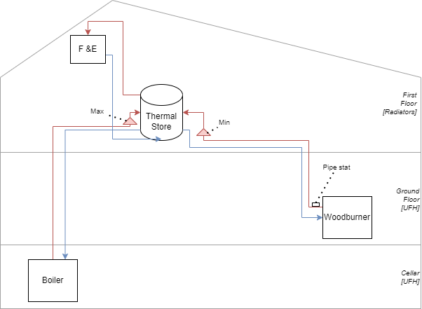

Where are the feed & expansion pipes relative to the store, woodburner and gas boiler? (A schematic would be useful)
As a slight aside, have you thought about a loading valve for the woodburner (rather than your current presumed pipe stat on the woodburner pump)? Is the pump in the feed from woodburner or the return?
Thanks for the reply - I'll try and draw a quick schematic. I haven't previously considered a loading valve - I'll have to check out that option. You're right though, we do have a pipe stat on the woodburner pump. The pump is also in the feed - not the return (also something I hadn't considered!

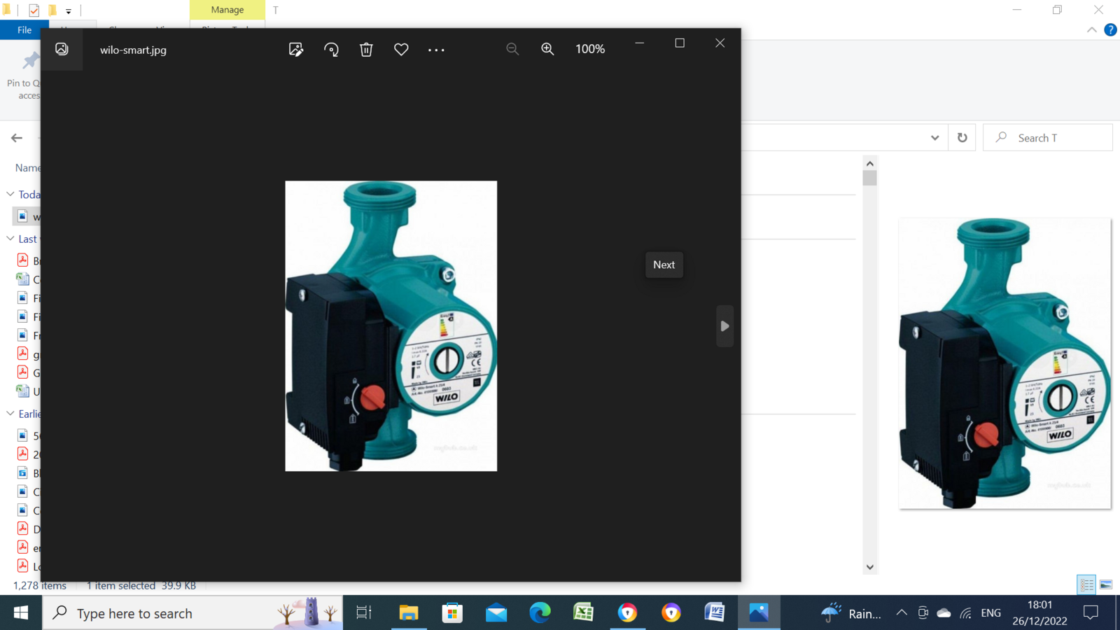

How smart is the Wilo pump, smart A rated pumps generally have 3 modes of operation, constant Curve, constant pressure & proportional pressure, CC,CP&PP?
@oldbutnotdead Here's the schematic - if you let me know what else needs to be added, I can do that. The central heating is missing - I don't know if that is important. But basically, there are two manifolds that are fed from the thermal store. One manifold is next to the thermal store and feeds radiators, the other is on the ground floor and feeds UFH to both the ground floor and cellar.
@Johntheo5 I'm struggling to answer your question. It's an older model, purchased in 2013. This, I believe is the link to the discontinued product on the Wilo website: https://wilo.com/gb/en/Support/Sele...-guide/en/wilo/wilo-wilo-smart/smart-25-4-130
It looks like this: https://www.tradepumps.com/smart-25-4-130
I've also checked the manual, and I'm not sure which of the three modes you list is used by this pump - https://www.manualslib.com/manual/1670989/Wilo-Wilo-Smart-25-4.html?page=15#manual

Mmm. You have to be careful putting things in the pipework from an uncontrolled heat source. Who designed/installed the system? - there should be a heatloss rad on the primary circuit from the woodburner. What volume is the store?
The pump in the woodburner circuit- is it the right way round (as in is it pumping into the store)? (Should be an arrow cast into the casing, don't be fooled by the orientation of the control head, that can be changed)
@Johntheo5 As far as I can tell, the stat is opening the valve and starting the pump at 75 degrees - the thermal cut out in the store is 85 degrees (we never get that hot at the top of the store to see if that needs adjusting higher, due to the pumping over). This evening I have tried the 'medium house' and the 'large house' settings and pumping over continues, but with increasing vigour. The gas boiler was not being called for heat and so the boiler pump was not running (so it's not an issue with the combination of two pumps running). This issue only occurs with the woodburner - which baffles me.
@mcmoby69 This is a new system - it has always pumped over, but this year we are using the woodburner a lot more, it is more noticeable and frustrating (it stops the thermal store from really heating up, due to the heat loss caused by pumping over).

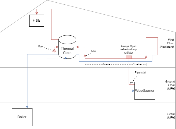

@oldbutnotdead You're right, there is a dump radiator - I've added that to the diagram and re-attached. It was designed by a company called 'Tailored Heat' - who seemed competent at the time and we've not had any issue other than this. The store itself is a Gledhill Greenheat OV and has a capacity of approx 249 litres. And yes, the pump is the right way around on the woodburner circuit (I've double-checked - just in case - paranoia is creeping in!).

I can see a scenario whereby air in the top floor dump radiator will expand as the woodburner pump starts-up. This would give rise to pumping over in your configuration. Will it be easy to move the dump rad's flow pipe to be between the pump output and the heatstore inlet?
If not try bleeding this top floor rad with the pump OFF, then see if pump-over occurs.
Is that 'always open' valve (for the heatdump) actually always open or is it motorised fail open?
I'm assuming there's a return from that rad as well...

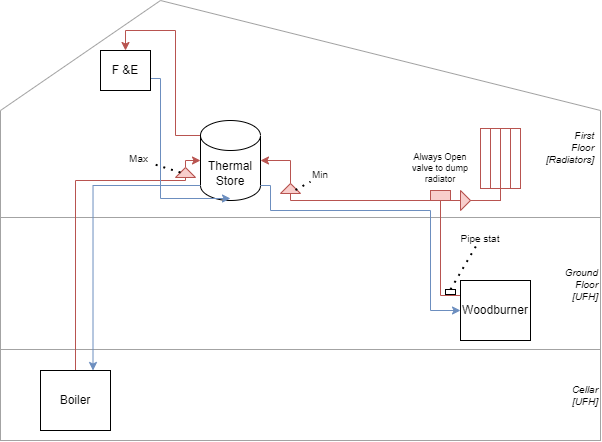

Yep - there is a return from the dump rad - I've put this on the diagram as well (I think this is correctly drawn). I've just checked the dump and bled it - there was no air trapped. There's probably a 3m near horizontal run to the dump radiator (flow out from woodburner is on one side of the chimney, dump is on the other side, one floor up from the woodburner).
The gas boiler has also kicked in tonight, and I checked, we still get pumping over from woodburner, regardless of whether gas boiler contributing or not.
I'll certainly get in touch with the installers, but I'm not expecting a great outcome from that conversation. I like the look of the loading valve - and on the return. I take it that no-one thinks a reduced 'power' circulation pump is a good way forward (the logic being that I'm just giving gravity a small nudge to overcome a longer than desirable horizontal run - and that that would not be enough to cause the pump over)? I thought if I could buy one with variable settings, I could manually reduce the 'power' until the issue stopped. As @Johntheo5 mentioned, there are several modes of operation for a circulation pump - so which I should be looking out for, and adjusting, I have no idea.
